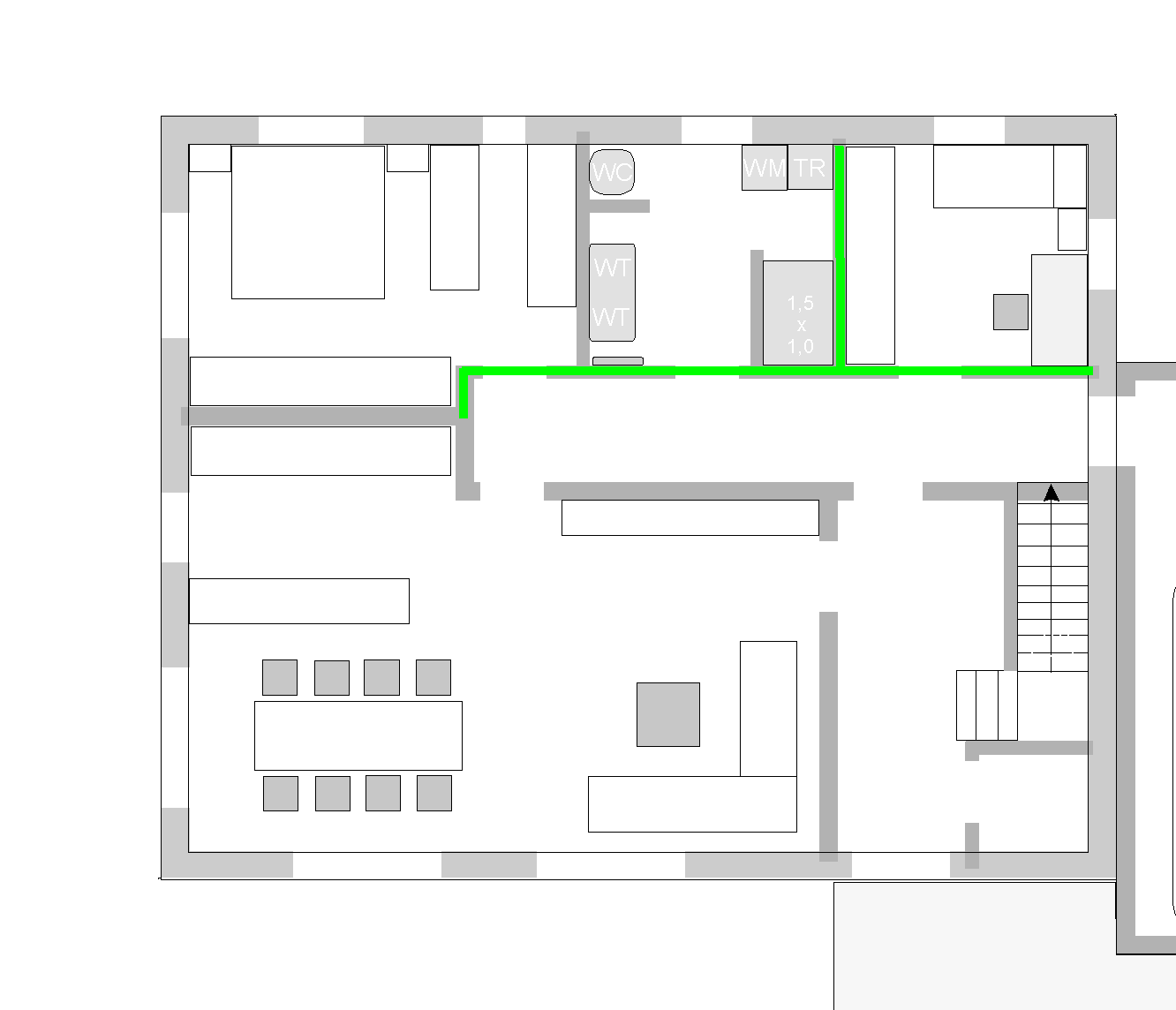

While considering the floor plan, I am wondering if it is possible to have walls on the ground floor (non-load-bearing walls) positioned where there are no walls in the basement.
There is only one ground floor and one basement.

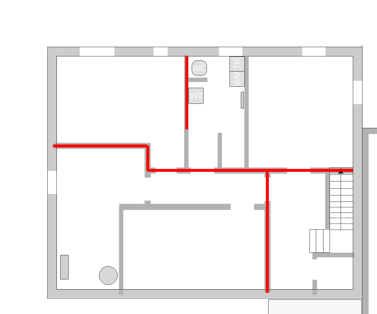

There is one load-bearing 24cm (9.5 inches) wall running across the house (horizontally marked in red), which also exists in the basement.
All walls in the basement that align with walls on the ground floor are marked in red; the others do not match exactly. The basement is made of concrete, the ground floor of Poroton blocks, with no upper floor.
Is this arrangement possible, or do the green-marked walls on the ground floor (17cm / 6.7 inches) also need to be present in the basement? Can a normal floor slab support this, or would reinforcement with steel be necessary?
The reason for this is the slight slope of the site and the fact that I can install windows on the north side of the basement without light wells, which is why I would like to have two larger rooms there.

Despite the unclear text and rather confusing drawings, I do not see any problem here. Furthermore, I would like to remind you of my criticism regarding the continuously new threads without any reference links :-(

WilderSueden18 Dec 2023 20:01I believe a structural engineer is not necessary at this stage. A drywall partition can always be included without major issues, and a non-load-bearing solid wall is usually not a problem either.
