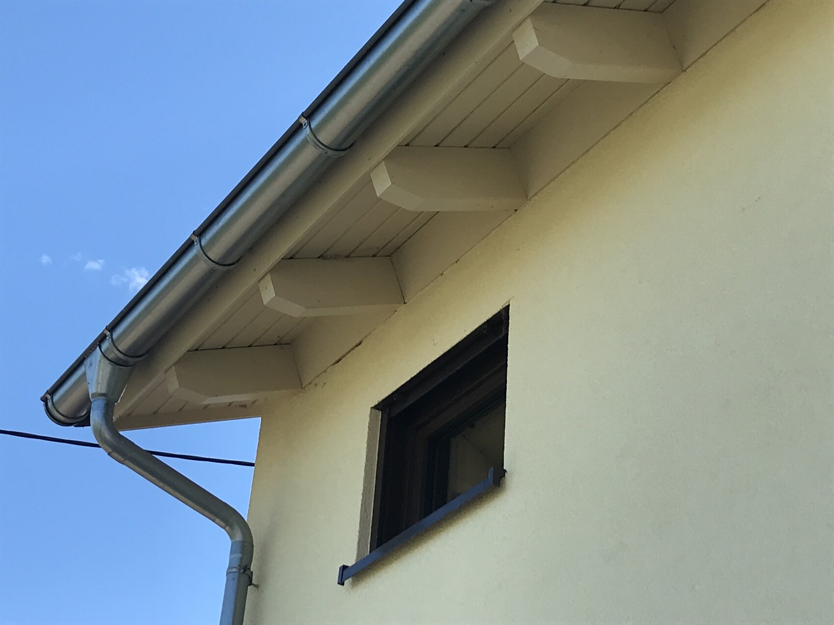

We bought a relatively new house at the end of 2019 (built in 2017).
The house is a prefabricated home, and the warranty for it expires this year.
Unfortunately, we have discovered several defects after purchasing the house (e.g., leaking gutters, doors not closing properly, etc.).
Since these are minor issues, I haven’t taken any further action yet, other than contacting the construction company, which has addressed most of the problems.

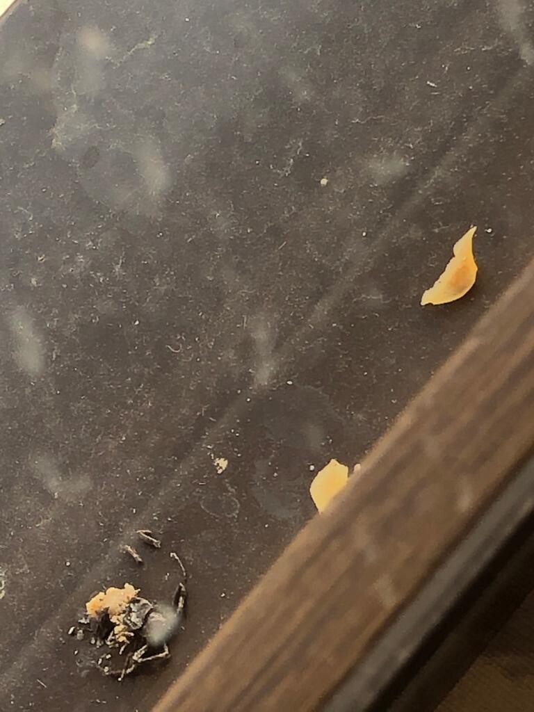

Due to the current economic situation, I’ve been working from home in my new room for the past few days. Unfortunately, I was alarmed to hear noises coming from the wooden wall when the first rays of sunshine hit (my room has a sloped roof).
On the windowsill, there was a half-dismembered bug and a yellow “something” (see picture).
Today, two days later, the noise was still audible, although the sun was already gone.
I thought maybe a bug got trapped in the beams?
--> I also recorded a video with the sound, but unfortunately, I can’t upload it here.
Can anyone help me? Does anyone have experience with this?
I really hope for your assistance!
Thanks and best regards,
minuk

Minuk1234567 schrieb:
The house is a prefab, and its warranty expires this year. Oh? Less than 5 years according to the building code?
I can’t make out much from the photo.
But it’s possible you have guests in the roof, for example a nest of some beetle species or wasps?
I’m not sure if the latter (wasps) is likely, but basically it’s possible that something nested behind the wood over the winter and is now becoming active again.
However, this would be your issue alone and not the builder’s responsibility.
Regarding other defects: doors can warp over time or gutters may start leaking. Also check the brackets and maintenance joints. None of this is covered under warranty.
I would also consider it a beetle, and the yellow "something" as insulation material that it probably couldn't digest as well as expected. It likely fell down—I suspect from under the roof overhang (eaves)? The root cause might be an unsealed access to a nesting site, which could be seen as a defect, yes, but in the end, the pest control professional will probably be your best option.

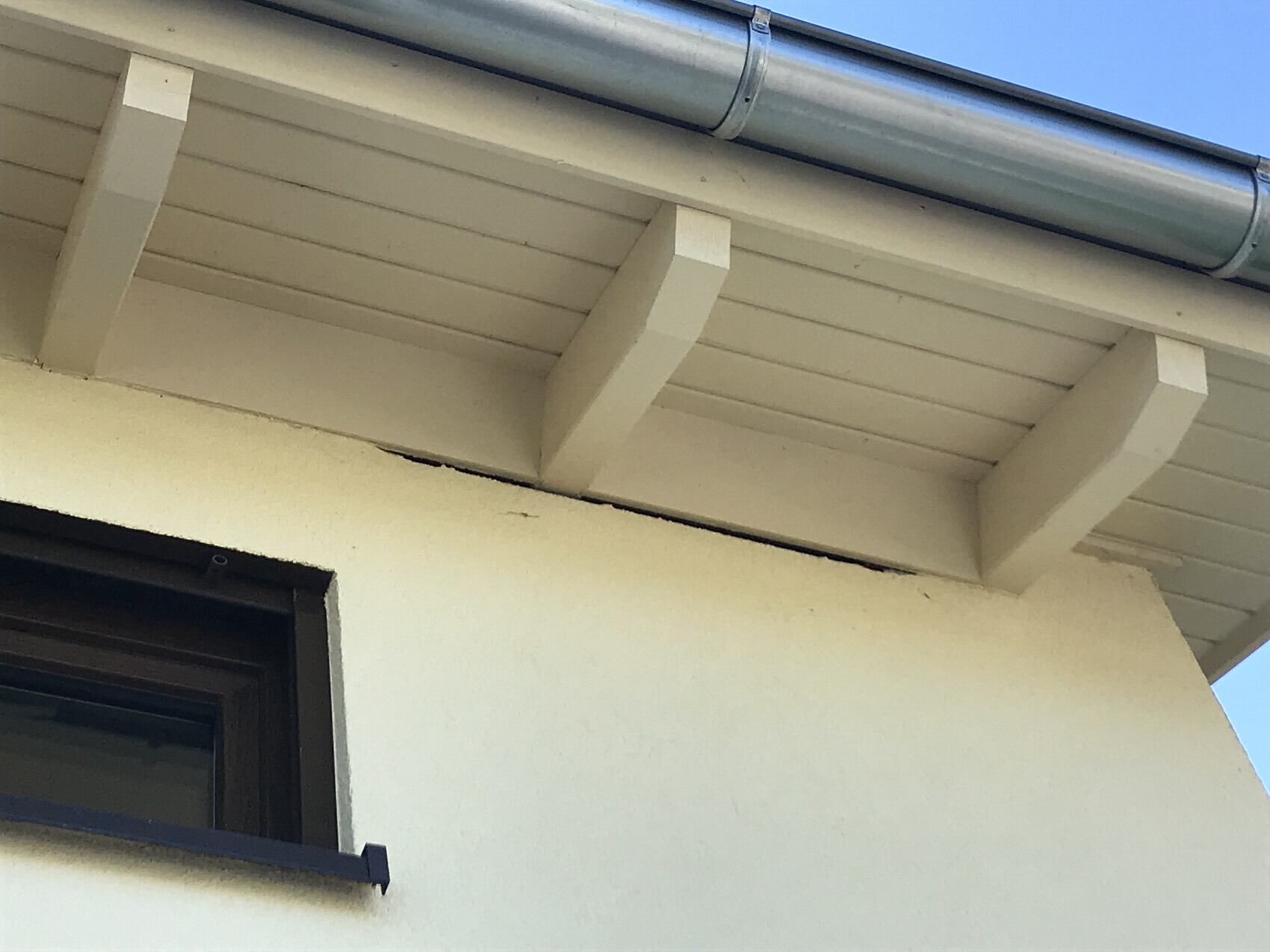

Minuk123456725 Mar 2020 21:4111ant schrieb:
I would also consider that to be a beetle and the yellow "something" as insulation material that it probably didn’t digest as well as expected. It likely fell down—possibly from under the roof overhang (?).
The cause might be an unsecured access to a nesting spot, which is a defect, yes, but the pest control technician will probably be your final relief.Thank you very much for the response! Attached is another picture. The construction company recently sealed this gap at the edge of the house at our request.
Additionally, there were similar gaps at other points on the roof. This was considered a "cosmetic defect," left as is since 2017, and now sealed due to our purchase.
Minuk123456725 Mar 2020 21:44ypg schrieb:
Oh? Not even five years after the building code?
It’s hard to see much in the photo.
But it’s possible that you have guests in the roof, for example a nest of some type of beetle or wasps?
I’m not sure if the latter (wasps) is likely, but in principle, something could have nested behind the wood over the winter and is now becoming more active.
However, that would be your issue alone and not the builder’s responsibility.
Regarding the other defects: it’s quite common for doors to warp or gutters to leak. Also check the brackets or maintenance joints. None of this is covered by the warranty. Thanks for the reply,
I haven’t seen any wasps; I’m leaning more towards beetles. I posted pictures of the roof edge below. Maybe the access door comes from there...
