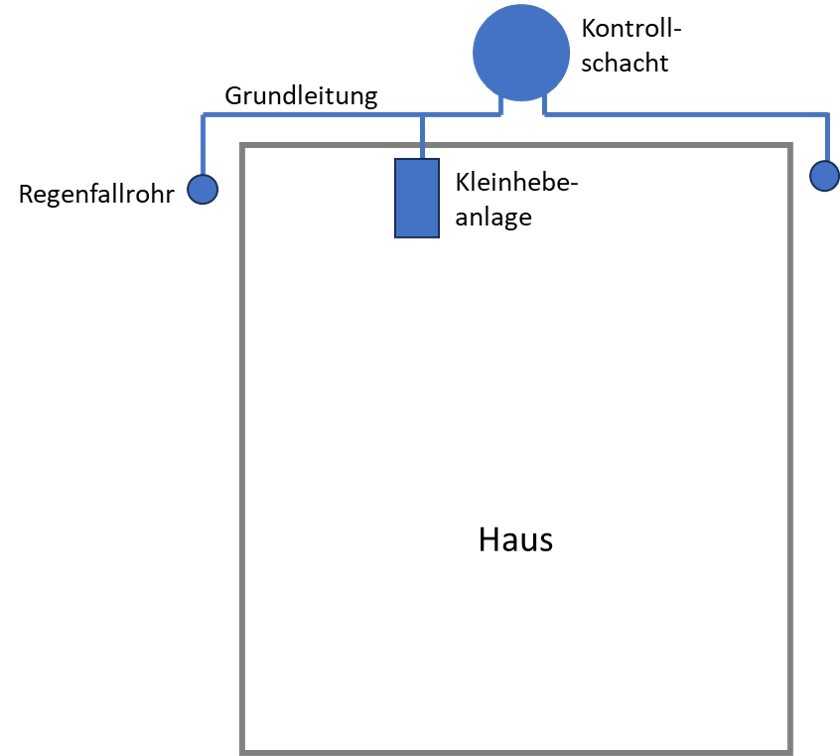

The small sewage lifting station is located in the basement of my detached house (built in 2019). When the lifting station pumps out, I can hear gurgling noises in the bedroom on the top floor. The sound transmission does not occur inside the house but through the main drain pipes and the rainwater downpipe outside. The noises are loud and disturbing. Therefore, I would like to know what I can do about it.
Here is a sketch of the home drainage system:
A drain cleaning company has already conducted a camera inspection of the affected pipes and lines. However, no irregularities (e.g., excessive slope) could be detected. My general contractor said he has never encountered such a case before. Although he confirms that noises of this volume are unusual, he does not know how to solve the problem.

I have the following issue with my small sewage lifting station and my home drainage system. If this is the wrong forum, please feel free to move my post accordingly.

- A friend of mine said that rainwater and wastewater should only be combined in the inspection chamber. Is this correct?I can’t comment on the regulations, but it would have been better to have separate piping up to the chamber. Nowadays, separate sewer systems are often installed or existing ones are converted during renovations. In your case, this would mean digging up to the house and installing new pipes. It’s probably not likely right now, but your excavator saved about 300€ by doing it this way (since the pit was already open) and may have caused a major hassle in the future.My guess is that the gutter isn’t properly isolated from the house. The gurgling sound is then transmitted as structure-borne noise.
timmy-baut30 Oct 2023 08:28WilderSueden schrieb:
I can’t comment on the regulations, but it would have been better to have separate piping all the way to the shaft.Thank you for your quick response. Would separate piping have been better only in terms of noise reduction, or are there other advantages as well? In the area where I live, there is a combined sewer system, meaning that rainwater and wastewater are discharged together into the sewer anyway.

xMisterDx31 Oct 2023 13:10But isn’t it already mentioned in the original post that the sound transmission occurs through the main pipeline and the rainwater pipe?
Couldn’t the problem be solved with a simple backflow valve that dampens the airborne sound?
timmy-baut4 Nov 2023 14:54xMisterDx schrieb:
Couldn’t the problem be solved with a simple backflow valve that dampens airborne sound?Thanks, good point. If the transmission is indeed through airborne sound, it might work.
