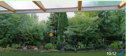

@MachsSelbst If I turn off the laptop and ignore the ticking of the clock, you can barely hear the truck—it’s so quiet that it’s impossible to find it disturbing. At least, that’s how we feel about it. I should mention, though, that I built a small wall with dense planting.
Garden view from under a covered terrace with trees, shrubs, and a sunflower
MachsSelbst
4 Sep 2025 10:17
I also have a hedge, and once it reaches 2m (6.5 feet) in height, it will help reduce noise from the street, yes.
But not in the bedroom upstairs, which is 6m (20 feet) away from the street in a straight line. And that’s what this is apparently about—it bothers me in the bedroom, it bothers generally upstairs. In this case, the building would have needed different soundproofing measures, especially since the sound transmission through the cold roof and the upper floor ceiling is often underestimated.
This is especially true for noise between rooms upstairs. You can use very thick sand-lime brick for interior walls, but a suspended ceiling with drywall creates a perfect sound bridge.
