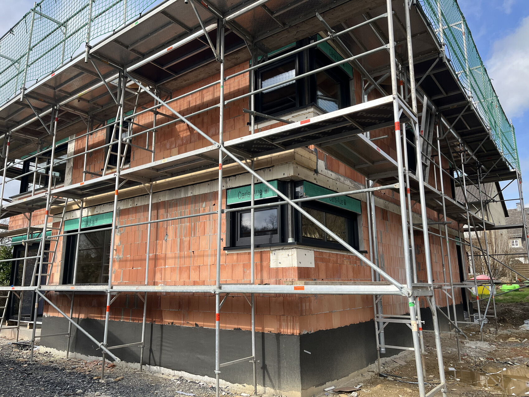

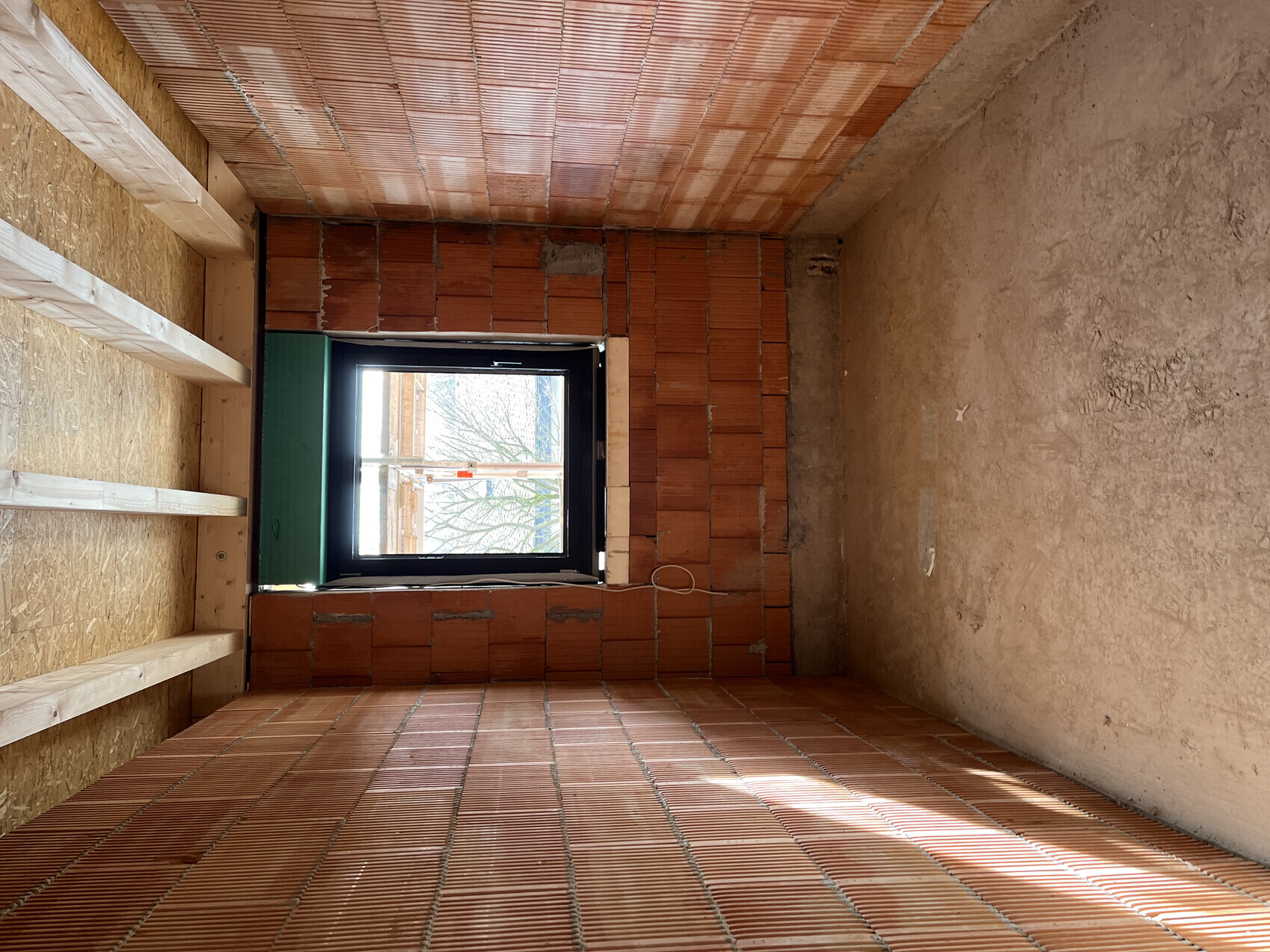

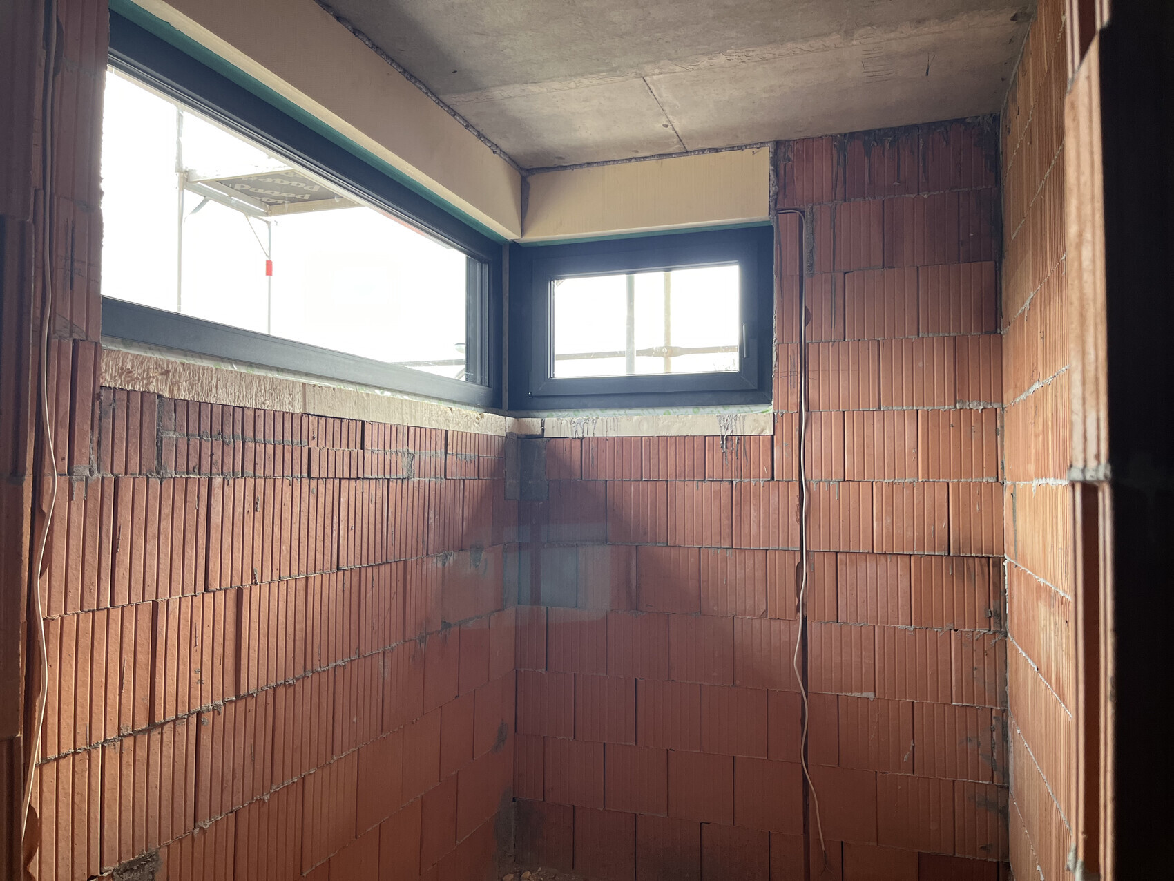

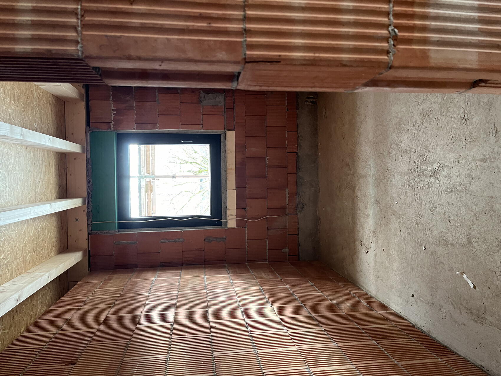

In 2024, we had a house built using 36.5cm (14 inch) Poroton bricks, with plaster applied both outside and inside. The windows are triple-glazed uPVC from Kömmerling. The panes apparently aren’t the best; according to the supplier, they offer 30-32dB sound insulation. However, in the bedroom we upgraded to 46dB panes already, but unfortunately without significant improvement.

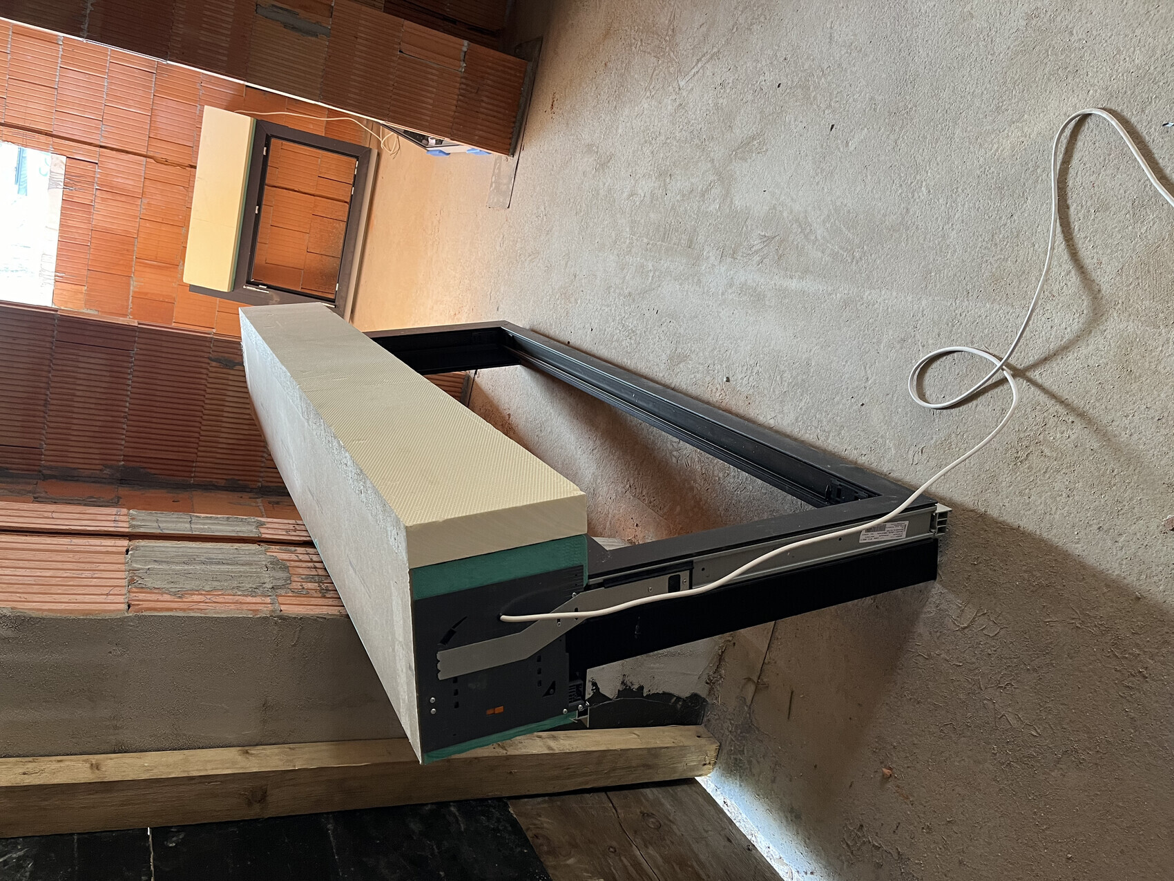

The windows are equipped with external blinds (raffstores) that are installed in cassette boxes directly mounted on the windows. These boxes are so thick that they are flush with the brick facade and were plastered both inside and outside. According to the datasheet, the boxes can provide up to 46dB sound insulation (tested using “pink noise”). No specific sound insulation class was agreed upon in the building contract.
When I hold a sound level meter to the open window, I measure about 38dB of outside noise. With the window closed, this drops to about 25dB (which is roughly the threshold at which traffic noise from the nearby federal road becomes noticeable).
Some rooms have corner windows that are insulated on the corners with polystyrene blocks. Since we also hear the noise—just slightly quieter—with normal windows, I wouldn’t identify those corners as the only weak points.
Unfortunately, we hear almost all noises from outside: passing cars (it’s a dead-end street with a 30 km/h (19 mph) speed limit), people talking in front of the house, birdsong, the neighbor’s front door across the street... We are about 600 meters (0.37 miles) from a federal road where the background noise is clearly audible depending on wind direction.
We have 23 window units and in some rooms there are four windows with a total area of about 1.5 square meters (16 square feet). This makes it very stressful and frustrating because we really can’t escape the noise.
We are already in talks with the construction company, and an expert will be called in soon. Now I need some input for my arguments and would like to collect some comparisons:
Do you hear such outside noises as well? What level of outdoor noise do you consider “normal” and what is definitely excessive?
A few photos of the shell construction attached.
