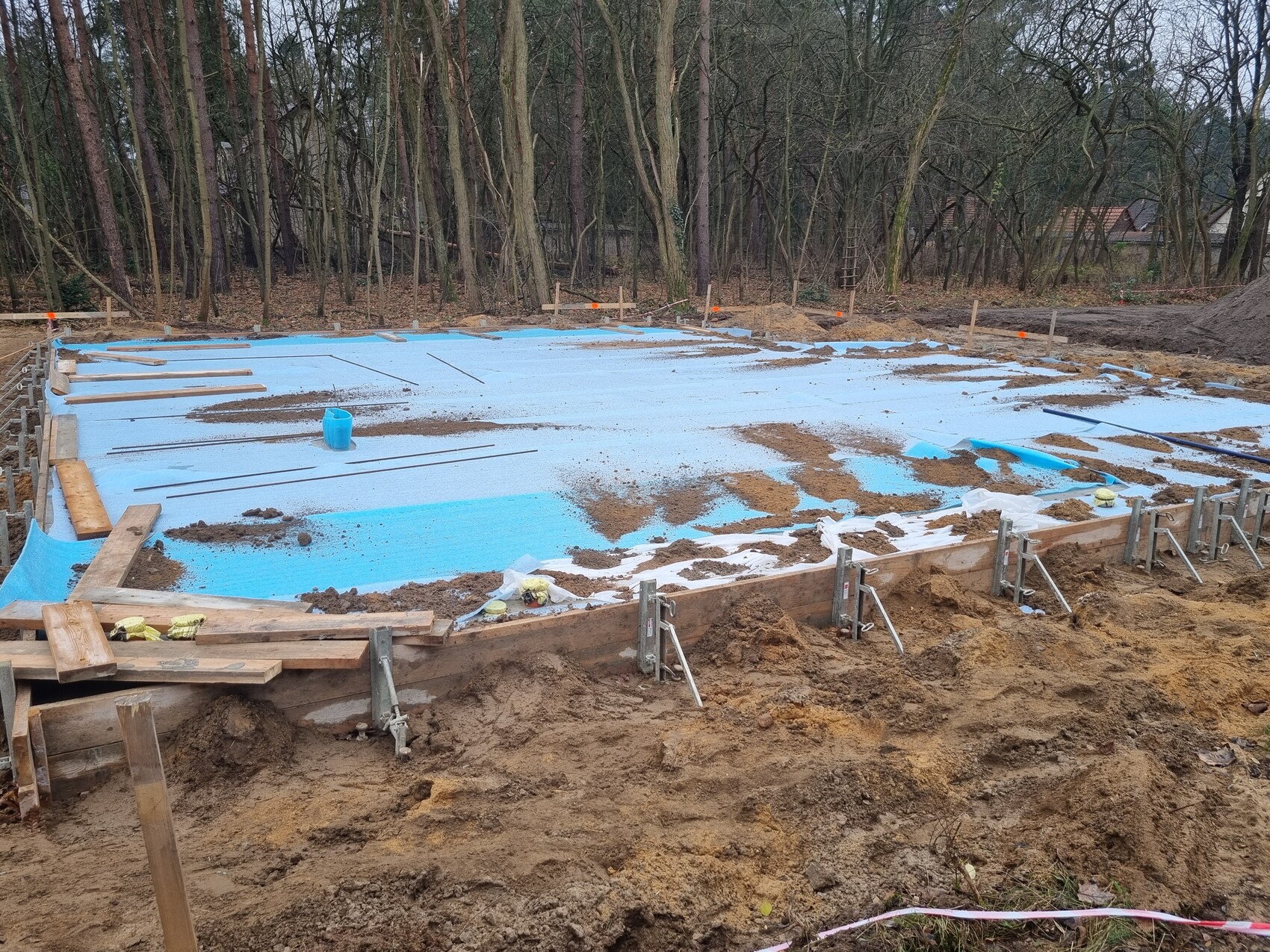

Neubau2022
14 Jul 2022 10:46
In my case, the foundation slab was poured at the end of November 2021 and then left unused for 1.5 months.
Foundation slab with blue insulation foil, wooden formwork, steel rods; forest in the background.
Holzhäuschen14 Jul 2022 11:02
Yes, ours was from the end of October until the end of February. Nothing happens during that time.
