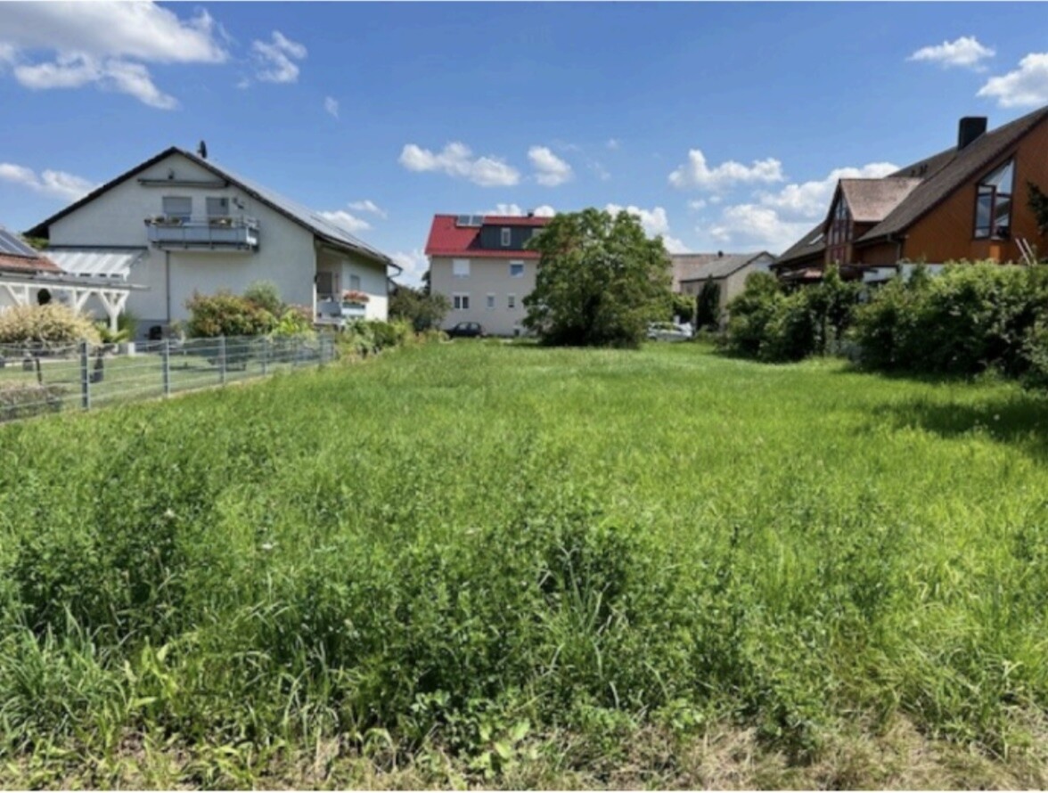

I have the opportunity to submit an offer for a plot of land that is actually quite nice – fairly large (870 sqm (9367 sq ft)), quite flat, about 20 minutes outside the city. However, the development plan from the 1970s includes some restrictions, and I’m not sure how much they would limit us. This is probably also why the plot is still available and offered at a relatively low price.
It’s about plot 867 from the plan. The street is below, a field path is above, and beyond that is farmland.
I’ve (hopefully) compiled all the relevant information from the development plan here. It’s overall rather brief.
Unfortunately, only one full storey is allowed. Also, a 60cm (24 in) knee wall combined with a 25° roof pitch sounds extremely challenging to me. Is it really that restrictive, or am I just imagining it to be too limiting? A garage does seem to be planned behind the house.
What do you think? Is this feasible?

MaxBauerBW9 Jul 2024 09:50Because it was asked: the building plot is 10 meters wide and 16 meters deep (33 feet by 52 feet).
I also have a photo of the back of the property. It is quite clear, I think, that the two neighboring houses do not have 25° pitched roofs. You can also barely see that the outbuilding at the back of the neighbor’s property on the left definitely does not have a flat roof.
I submitted a request to the building authority, but I need to decide on this property by the end of the week whether to make an offer, so I do not expect a timely response.
