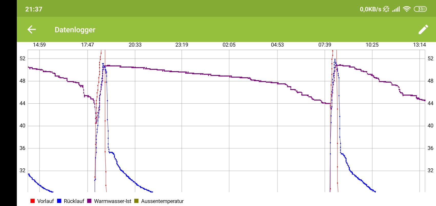

Then there’s the bathtub size and whether a rain shower is installed. No joke, you notice everything—for example, if you have a 300-liter (79-gallon) buffer and your rain shower has a flow rate of 20 liters per minute (5.3 gallons per minute), you need to recharge the buffer twice a day. Or 4 people who each shower for 10 minutes every day.
The same applies to how the 24°C (75°F) in the bathroom is achieved—whether through pipe spacing or a higher flow temperature from the heat pump.
If your heating technician comes with basic settings, or if customer service only makes rough adjustments, you will notice it in your wallet.
That’s why it’s important to understand what really matters yourself.
For example, I have now reduced the circulation to a minimum; heat loss in the storage tank has dropped to about 6 degrees Celsius (11°F) over 12 hours. Previously, it was 6 degrees Celsius (11°F) in just 6 hours.
Especially with the help of this forum. But I think there is still more potential, though this is enough for now.
