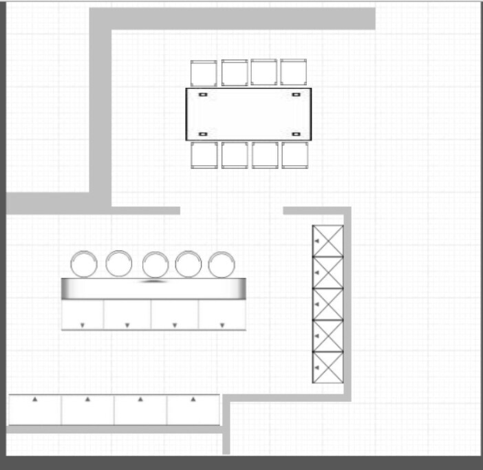

Pinky0301 schrieb:
The kitchen might be too narrow for a seating island:
338cm (134 inches) - 60cm (24 inches) counter run - 100cm (39 inches) walkway between counters - 100cm (39 inches) distance from island to wall = only 78cm (31 inches) left for the island, and that’s the rough construction measurement
Pinky, you overlooked that the counter at the bottom of the plan is in addition to the 338cm (134 inches), so there is enough depth space. Actually, the kitchen is too large, meaning too wide—you just keep walking and walking.
On the other hand, the dining area is only 306cm (120 inches) deep. With a table 100cm (39 inches) deep and chairs measuring 60cm by 60cm (24 by 24 inches) for each side, there are only about 40cm (16 inches) of clearance above and below the table for walking by. That doesn’t really match the oversized kitchen and living area.

Floor plan of a room with a conference table, chairs, bar counter, and cabinets.
Where will ironing be done, and where will the garden furniture be stored during winter?

evelinoz schrieb:
Where will ironing be done, and where will the garden furniture be stored in winter?
Ironing will be done in the utility room, just like in our current house. For those who prefer a different setup, the mezzanine could also be an option after 15 years, following a sale; it can be separated to create an independent room if needed.
Our garden furniture will stay outside during the winter as well (suitable outdoor furniture). At the moment, we have a covered terrace. The new house will also have a covered area planned, but the details are not yet finalized.
I
idasb79
31 Jul 2020 10:18
evelinoz schrieb:
The dining area, however, is only 306cm (10 feet) deep. With a table 100cm (40 inches) deep and chairs measuring 60x60cm (24x24 inches) each, there’s just about 40cm (16 inches) of clearance above and below the table for walking past. This doesn’t quite match the oversized kitchen and living area.
Originally, there was no wall between the kitchen and dining area, but since we wanted the option to completely separate the kitchen, this wall was added.
Otherwise, you are certainly right—the dining area is smaller compared to the kitchen. However, regarding the 40cm (16 inches) clearance between the chairs and the walls, that only applies while everyone is seated at the table; who would be walking around the table then? Besides, the chairs are often pushed halfway under the table, leaving more space available.
