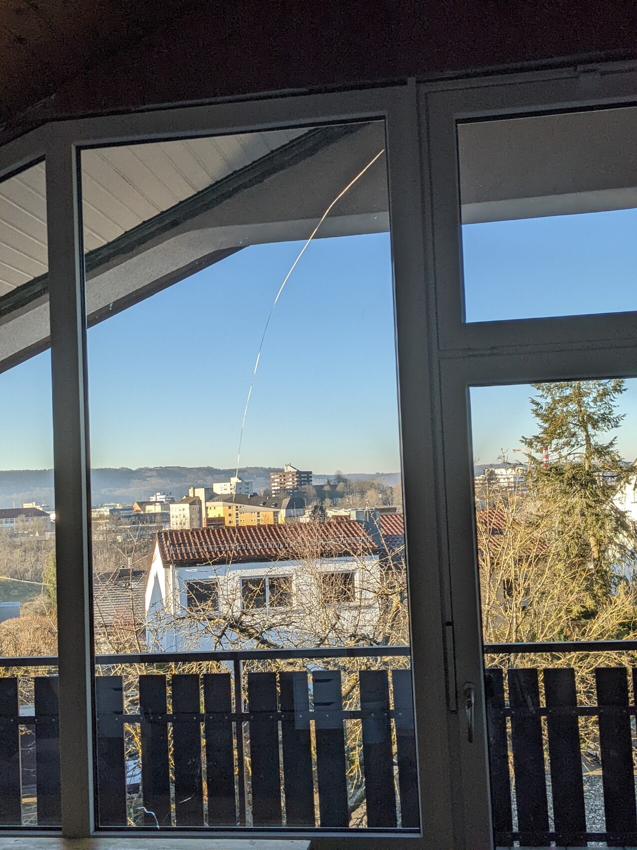

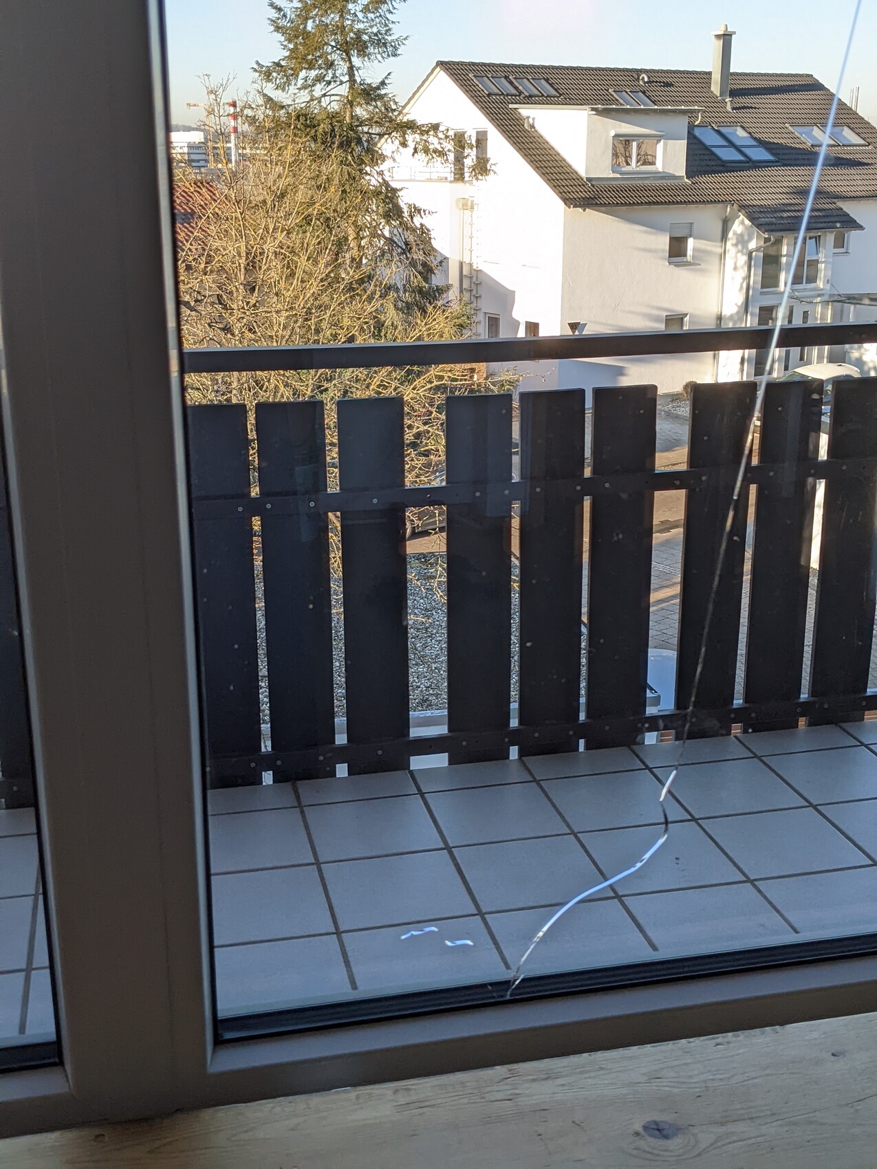

About 1 1/2 years ago, we had new PVC windows installed by Aldra (white on the inside and anthracite on the outside, P4A burglar-resistant glass) in a 40-year-old house.
A few days ago, a crack appeared without any external impact in the fixed panoramic glass, starting diagonally from the lower left frame upwards to the right.

saege schrieb:
1. What could be the possible causes of the glass breakage?Heat or cold saege schrieb:
2. What should I consider to prevent such damage in the future?Probably nothing. It looks more like faulty material or installation. saege schrieb:
3. How expensive could the damage repair be?
Thanks for your answers Typical warranty claim or insurance case. So, no cost at all.Report glass insurance claims! These kinds of damages are frustrating and can be insured for a very low cost!
Benutzer20013 Mar 2022 16:55I just noticed an identical-looking damage on a new pane. Temperature change – my kids had placed anthracite-colored cushions against the glass. This often happens with new triple-glazed windows.
No issues with the glass insurance. However, the glazier has a four-week lead time.
danixf schrieb:
It looks more like defective goods or installation.In this case, based on the thread history of the original poster, I "would not rule that out" ;-) https://www.hausbau-forum.de/threads/mangelhafte-fenstermontage.36512/
