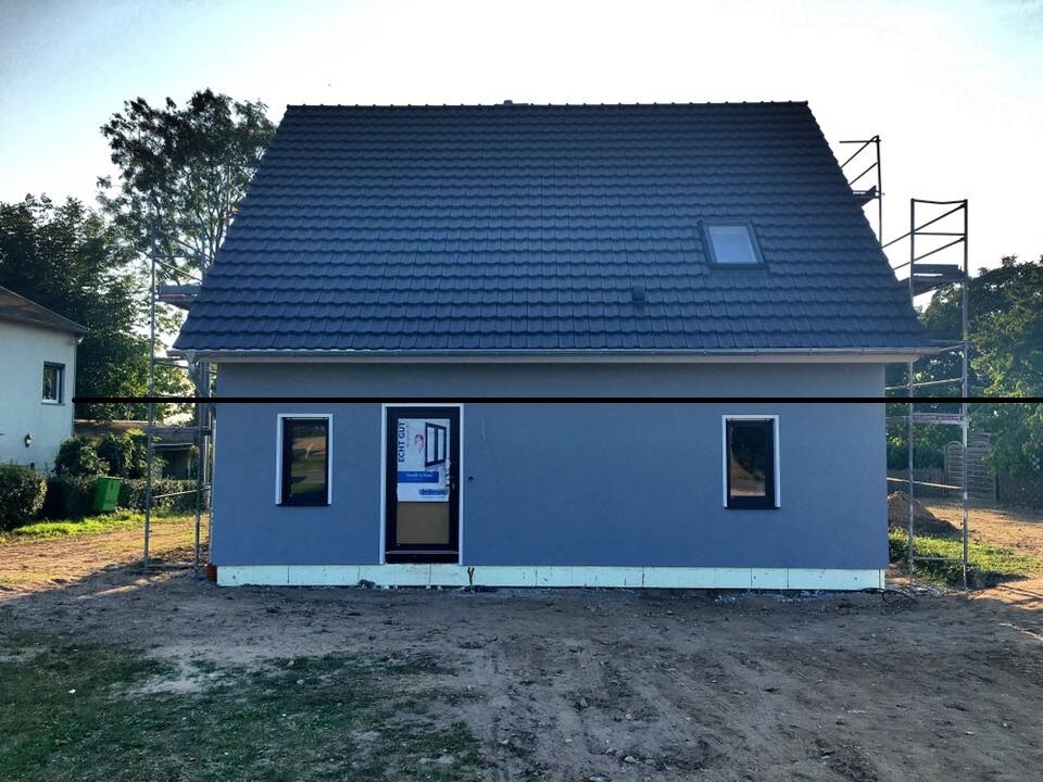

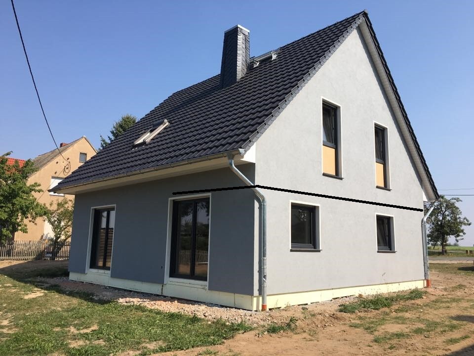

Over the weekend, together with a professional friend, we took some measurements and, how should I put it politely, were somewhat confused. All window lintels (this concerns two windows on one gable and two windows, one on each side of the front door) on the ground floor are installed nearly 20cm (8 inches) too low. It seems the structural builder took the lintel measurement from the floor slab without considering the floor buildup (screed, underfloor heating, tiles). The construction company has been informed and an on-site inspection is planned. It is undisputed that the (major) defect exists. It is also clear to us that the house will not be “torn down” again. It seems equally clear that the builder must address this construction defect in some way. Since demolition and structural alterations (removing windows, raising lintels, redoing the exterior facade, replastering inside, etc.) are certainly not an option, our view is that only a financial compensation remains. We are aware that we can reduce the final invoice. The question is, how much do you estimate we can withhold or apply as a penalty charge? What does fixing such a construction fault typically cost, and what factor can we apply? We are not aiming to withhold the last dollar; a rough estimate with numbers would be very helpful.

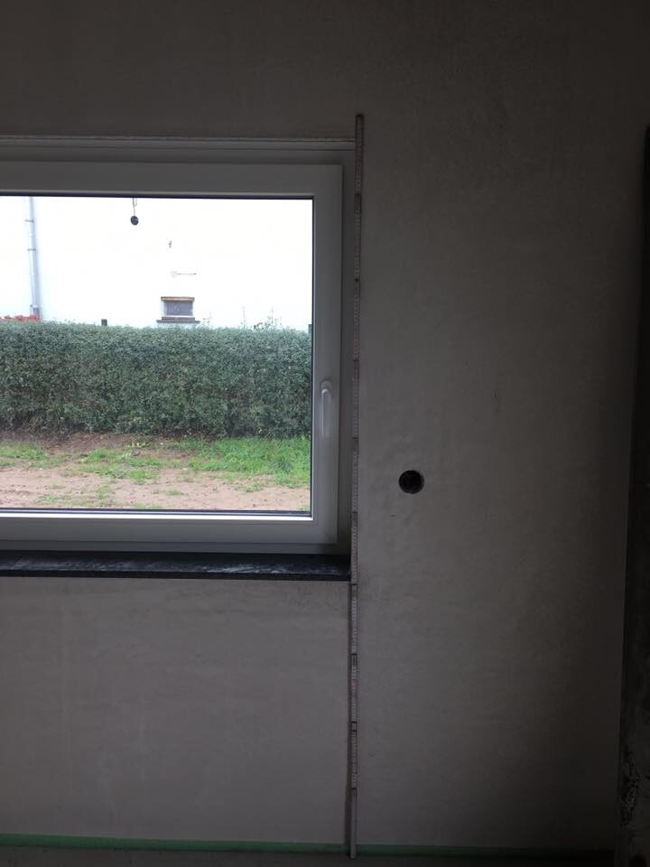

Regarding the pictures: Maybe it’s clearer now what I mean?! The required and actual lintel heights are 195 cm (77 inches) actual and 219.5 cm (86.4 inches) required. The windowsill height at the four relevant windows is 83 cm (33 inches). And no, I don’t want to start a discussion about any kitchen, as that is simply irrelevant.
Since there was a lengthy conversation last night with the managing director of the construction company and the defects were acknowledged, this will now likely lead to a general contractor’s offer. We will see how that will be structured. The option of defect remediation is still on the table as well.
