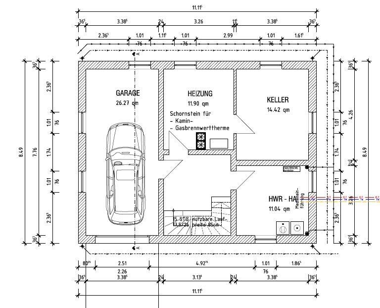

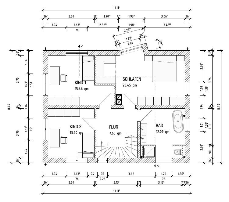

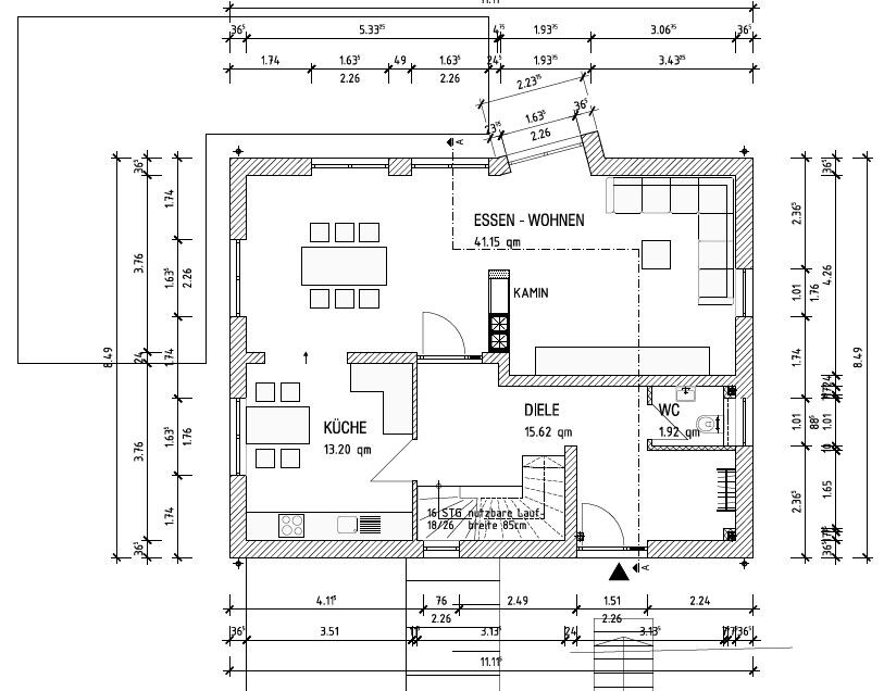

Hello dear forum,
So far, I have been a silent reader gathering some ideas here in the forum, and now our plan is at a stage where we would like to get some opinions or comments from you.
There is still a window missing in the guest bathroom, in the second child’s bedroom, and in the living room on the north side.
We are also considering whether the entrance area is spacious enough and if the distance between the sofa and the built-in wall unit in the living room works well.
Please take a look, and we would appreciate your feedback.

Do people actually read in front of the window? Wouldn’t it be more likely in bed or the living room? What kind of cabinet is that supposed to be? I don’t think it’s very practical (but maybe I’m just not imaginative enough). Do you always have to carry the vacuum cleaner up from the basement, as well as laundry, drinks, etc.?

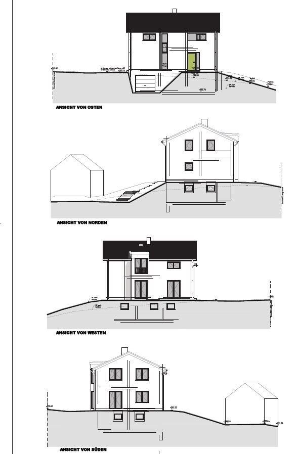

Tagtraum858 Dec 2014 08:45Good morning,
Since I suddenly had a business trip, we have only now been able to review the revised plans in detail.
We have mirrored the basement and removed the home office. This allowed us to slightly enlarge the living room (distance between sofa and built-in wall unit) and redesign the entrance area to use it as such.
We were able to keep the total living area unchanged, and nothing has basically changed on the upper floor except for the staircase.
What we have noticed or will change:
- Window strip in the stairwell centered instead of on the left (if there are no objections)
- Two windows in the garage are sufficient (the window on the west side will be removed)
- Window above the sofa in the living room is missing from the exterior view
We have now removed the third floor-to-ceiling window/door in the living room; it feels more balanced that way.
@lastdrop: It is not a dining table but a counter, which will be moved along with the rest of the kitchen for now.
First of all, many thanks for the comments so far, and I look forward to any further feedback.
Thanks and regards
Tagtraum
