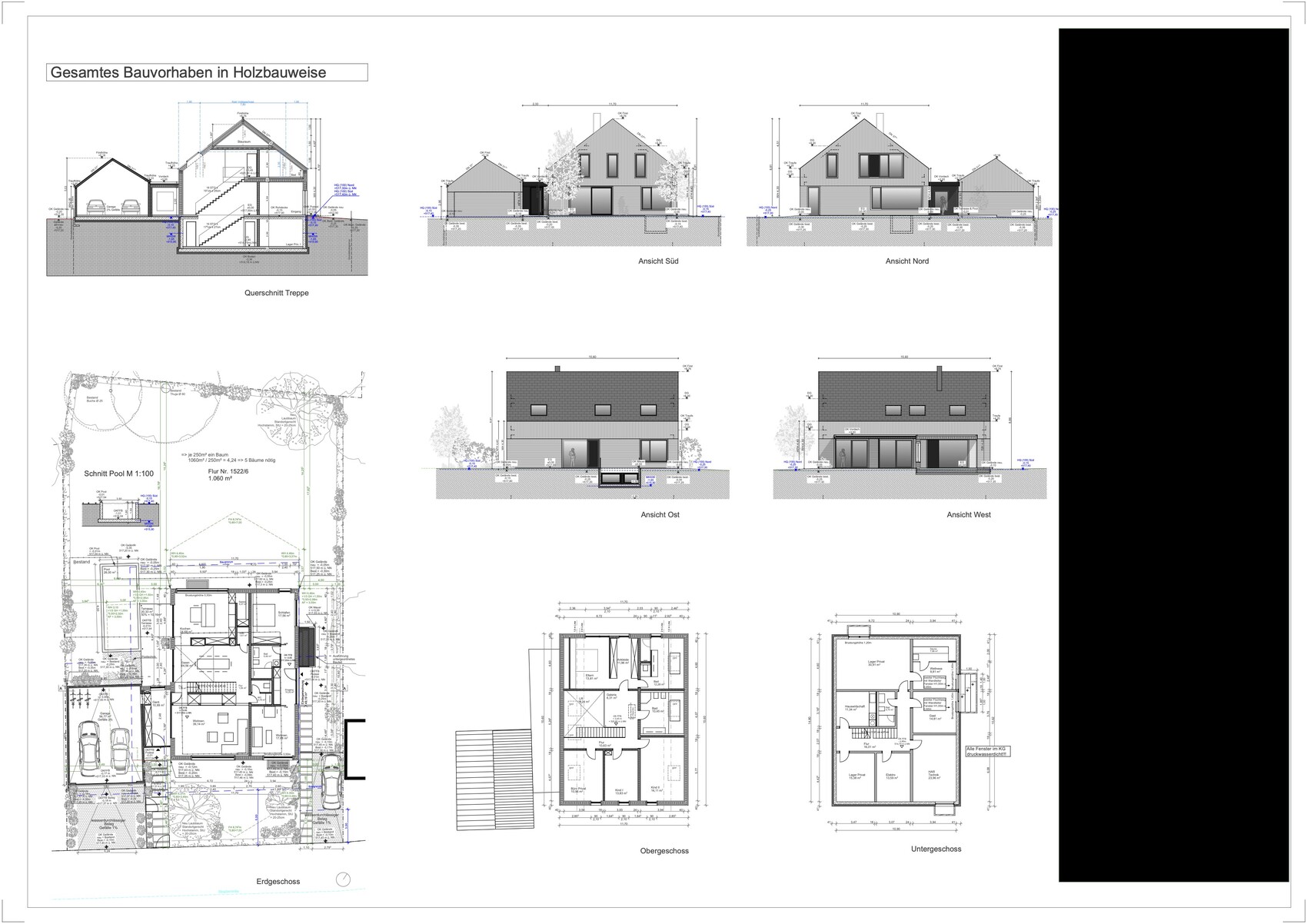

Dear community,
We are finally getting a step closer to realizing our dream of building a single-family home.
The plot has been purchased, building plans have been reviewed, construction method decided, and so on. We have now commissioned the architect of the general contractor (GC) of our choice with the planning task and are currently fine-tuning the house design. I would love to take you along on this journey and incorporate your valuable feedback.
At this stage, the focus is on the house design.
Basic data:
Plot: 1062m2 (11,433 sq ft); approx. 25.5m x 41.64m (84 ft x 137 ft)
Orientation: Northwest -> The arrow in the screenshot of the 3D view points south
Desired room layout:
Ground floor:
First floor:
Attic:
Note: I am still discussing this with the architect. Due to the hipped roof shape, the actual living area has shrunk too much. Therefore, further discussion is needed to accommodate the other rooms. I had underestimated the ratio of gross floor area to usable living space.
Basement:
Additional plans:
Now to my first questions for you:
My biggest construction challenge at the moment is the layout of the attic. There are two alternatives:
- Change the roof type, which would increase costs but provide more usable living space in the attic
- Give up the playroom on the first floor, convert it into a guest room, and build only the two offices in the attic (no guest room or bathroom)
Thank you in advance for your comments.

gregman2231 Dec 2022 12:45Dear community,
Another month has passed, but progress has continued.
About a week ago, our architect submitted the planning application. This means that the building structure (external dimensions, windows, ceiling heights, etc.) is now fixed, and the approval process can begin.
Additionally, all requirements regarding flood protection have been resolved. The ground floor needs to be raised by a total of 15cm (6 inches), and this difference can be balanced out by the landscaper through backfilling. All additional efforts for extra planning steps will not incur any further costs.
We will now make the final refinements to the floor plans.
Currently, these topics are on our minds—perhaps you have some smart ideas or suggestions:

- Due to flood protection, we will naturally build a basement with a waterproof concrete shell (“white tank”) and watertight, pressure-resistant windows. That settled the matter for me at first. However, a general contractor surprised me this week by saying we might have to place all technical equipment (i.e., the utility room) above the HQ100 flood protection level—so above the basement floor. That would be a disaster, and it’s the first time I’ve heard of this. I haven’t been able to speak with our architect yet because he is on vacation. What are your thoughts on this?
- I would like to rearrange the basement rooms a bit differently. The following technical components are currently planned: KNX cabinets with all actuators, network technology/server cabinet, heat pump unit for the geothermal system, water storage tank (probably 600 liters (160 gallons)), central ventilation unit, meter cabinets, photovoltaic storage.
- In our floor plan, there are currently two utility rooms planned: 24 sqm (258 sq ft) and 13.5 sqm (145 sq ft). Do you think the 24 sqm (258 sq ft) room is sufficient, so I could use the second room for something else?
- The utility room currently has a basement window. Is this absolutely necessary for heat dissipation, or could we allocate the window to another room (laundry/utility room)?
