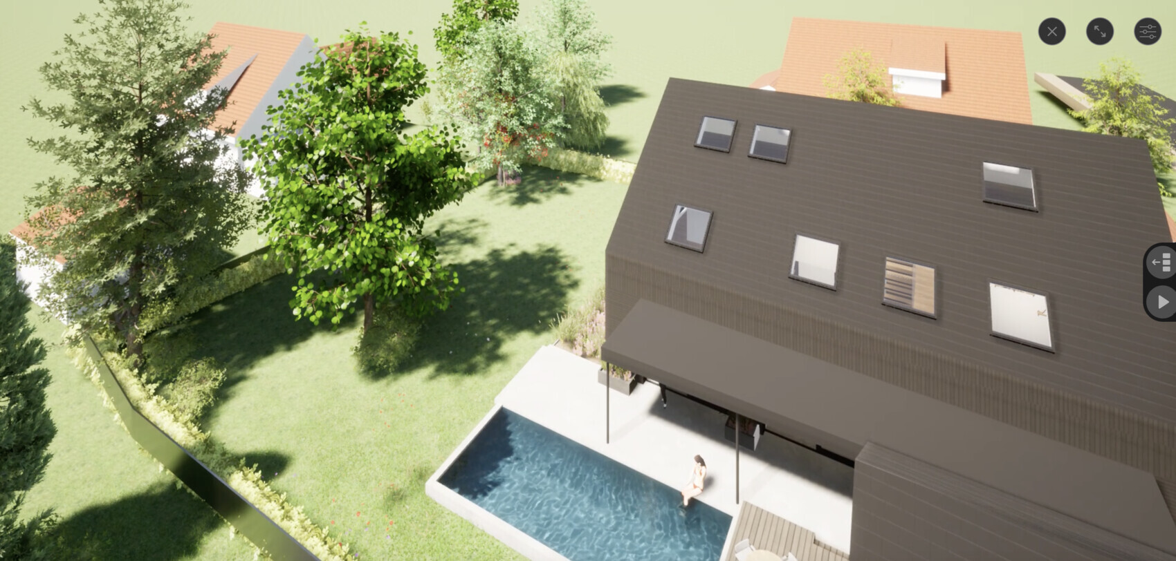

I have now gained access to the 3D rendering. Therefore, I can also present the proportions between the house and the plot using a screenshot.

Before addressing specific points, I would like to put things into perspective again:
  • The architect had to complete this planning phase under pressure (in about 2.5 weeks including vacation absences).
  • The plan is a first draft and can be adjusted.
  • The design is independent of building materials. We can decide on solid wood or masonry construction.
    • Honestly, I remain somewhat skeptical about wood as well. I like the appearance, but weather exposure and similar concerns worry me. The color is also just a suggestion and has not been approved by us.

Planning under time pressure is unprofessional; good planners refuse that, and at the same time wasting time on a preliminary sketch just doesn’t add up.
gregman22 schrieb:
The design is independent of building materials. We can decide between solid wood or masonry.
  • Honestly, I remain somewhat skeptical about wood. I like the look, but weather exposure and related issues worry me as well.
Then I don’t understand your anxious question about the material. I see no reason to be skeptical about wood, and the appearance has nothing to do with that. If the visible surface is also wood, that is rather coincidental in terms of being independent from the structural building material. I also don’t understand the restriction to just these two construction methods—why exclude other panel construction types?
Overall, it seems you rely heavily on visuals but have limited spatial imagination and not enough experience with conceptual planning, so you get distracted by renderings. I recommend you take a more systematic approach. Since we are still at the preliminary design stage and you haven’t decided on the building method yet, I would follow either my recommendation ("Baulotse Hoffmann," now with the preliminary design request bids from a handful of general contractors and continue working with the architect through design phase 5) or my colleague Beuler’s suggestion ("Fertighausexperte," work with the architect through design phase 3 and then request bids from the general contractors). These two approaches can also be combined. My “classic” approach involves keeping the architect on board through design phase 8; the route suggested by the “Fertighausexperte” makes the most sense if you continue working with this expert throughout the entire process up to the final acceptance.
So far, I have not gotten the impression that this architect would be recommended for design phase 8 :-(

Overall, the planning is not bad and meets your requirements, but I would suggest considering the following points that, in my opinion, need to be changed. First, something positive: we also have an open void and with the bedroom door closed, you cannot hear anything from the living room, even though the walls are not especially thick. So, sleep is completely undisturbed unless you are a very sensitive sleeper. Personally, I find an open void to be a great feature and, as you said, simply nice.
1.) The ceiling height seems very low. With a budget like this, you should have ceiling heights of 2.8m (9 feet 2 inches) or more. How oppressive must a 60m² (645 ft²) living room with only 2.6m (8 feet 6 inches) ceiling height feel, especially when it is 9m (30 feet) long? I wouldn’t feel comfortable there.
2.) The living room in the granny flat is quite small. It should be at least 25m² (270 ft²). I would remove your bathroom, put the kitchen against the bathroom wall, and place the guest toilet under the stairs. Also, the granny flat should have a nice terrace.
3.) Missing setback from the boundary for the garage: Is it really only about 3m (10 feet) high near the neighbor? I doubt that.
4.) The facade definitely needs to be changed. It currently looks like an architectural style from the 1960s (sorry). This dark, unfriendly-looking wood is not to my taste at all. I would recommend clinker brick instead. It looks much nicer and bright clinker bricks immediately improve the appearance. Especially with this budget, you should choose a durable, low-maintenance solid construction. Clinker brick never needs painting or repairs. Wood, without regular cleaning, looks like an old house after just a few years.
5.) Dormer windows are also missing. I wouldn’t feel comfortable in a house without nice dormers that provide plenty of light and usable space. Without dormers, you end up with the living quality of a Town & Country house at the price of a million-dollar villa.
Otherwise, the floor plan fits your needs well, and having the kitchen at the entrance wouldn’t bother me at all.
