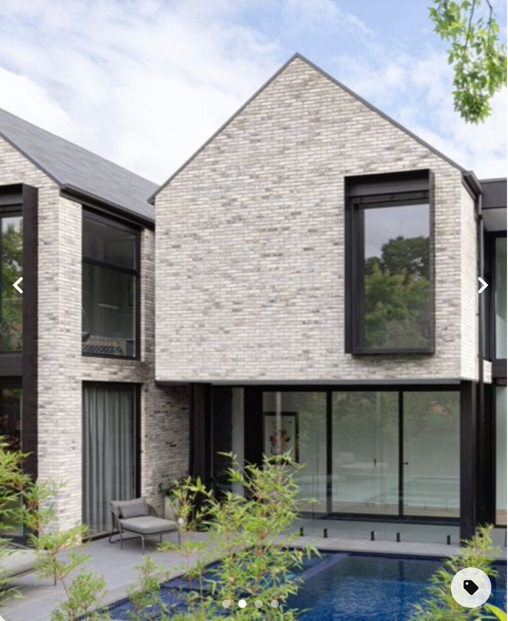

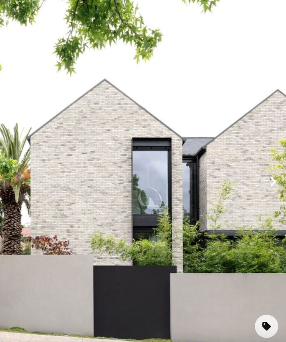

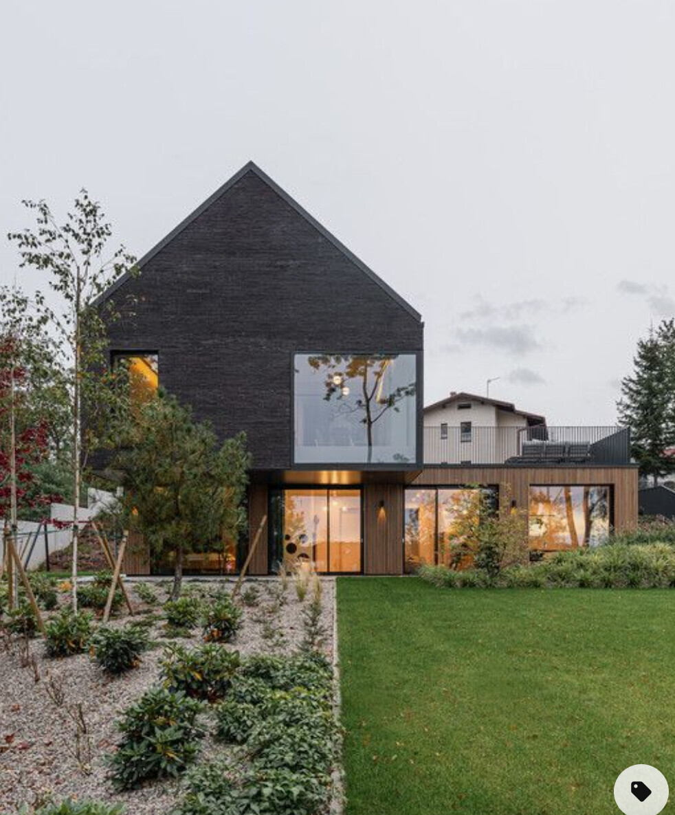

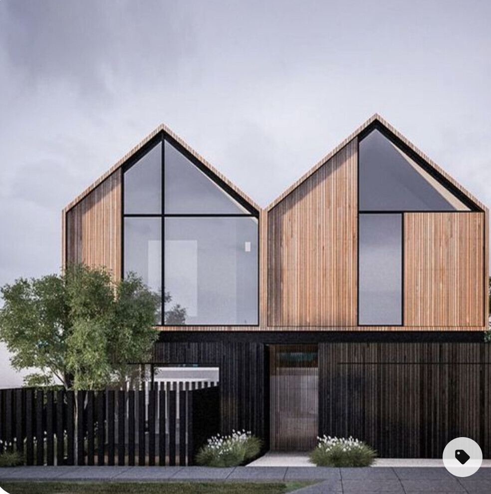

I would suggest asking the architect to perform a thermal analysis for the building—specifically, the heat transfer through the house’s materials to the interior and also a heat simulation for the outdoor areas. Then have them calculate the cost of removing that heat from the building. The terrace by the pool is likely to become so hot in the peak of summer that it won’t be comfortable to stay there. Dark surfaces can be up to 30°C (54°F) hotter than white surfaces, and this heat is transferred both inward and outward. And there are no overhangs or any effective shading?
I’ve seen these architectural fantasies from the far north of Scandinavia, but it doesn’t get this hot there.
If the facades are made of wood, you will need to repaint them annually. Even with other materials, maintaining a consistent black color involves enormous effort. It will look good for maybe two years at most. After that, you will have areas aging differently, weathering, showing environmental effects. It will become patchy, and not in a way that looks like patina.
I really can only shake my head at so much design with so little sustainability. I know architects love black — so edgy, so sleek, so different. Without having to put effort into complex forms. But there are reasons why buildings haven’t been done like this before. And no, new materials and technologies are not yet advanced enough to prevent synthetic materials from aging. Check the manufacturers’ guarantees for color fastness under weathering—usually 5 to 10 years at best. And these come with tolerances. Under lab conditions.
Sorry for the rant, but this is just one of those wet architect fantasies that completely ignores reality.
Myrna_Loy
23 Sep 2022 11:03
And if you imagine the facade in white, it just looks like any detached house in any new development area. Only bigger. That’s not good architecture. For the budget, I would expect more. More character, more structure. And not a black-painted look.

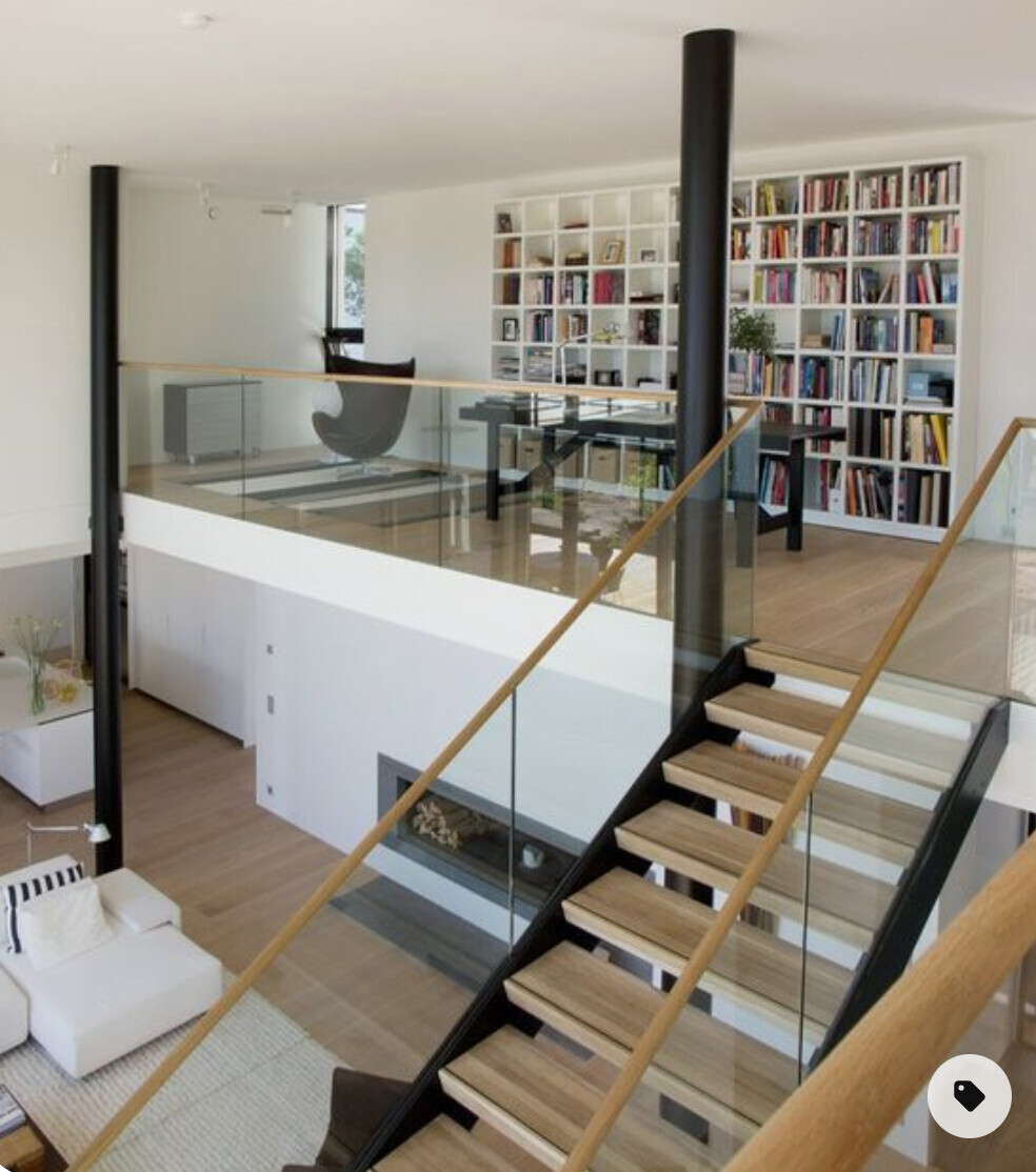

Myrna_Loy
23 Sep 2022 13:50
For me, a gallery is more than just a hallway. It is more like an open usable area, as shown in the picture.
The size of the plot can be estimated from the renderings by comparing it to the neighboring buildings.
