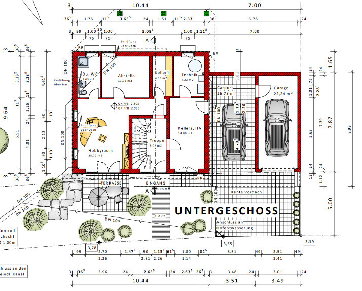

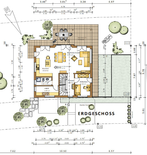

after gathering ideas and suggestions from this forum for some time, we would now like to present our first draft for discussion. We hope we have already considered many of the points we read here! Our focus is not on exact dimensions but rather on the room layout, arrangement, and any other advice. The goal is to have a design for which we can then plan the windows and subsequently approach general contractors (GCs), so we don’t have to start completely from scratch or have a plan that reflects our needs and daily routines. We have deliberately not yet arranged the windows, since the room layout was not final. It is clear that we want plenty of natural light in the dining area/south side, as there is a slope to the west that “shadows” the house. Our current living focus is the kitchen/dining area, which is why it has a corresponding size, orientation, and central location. Regarding the questionnaire:

Basement, floors: Accessory apartment in basement plus separate entrance and utility/technical room

Open kitchen, cooking island: both
Number of dining seats: minimum 8

Designer: Do-it-yourself. We want to use the slope to create an accessory apartment and garden with separate entrances. The garden for the main house is on the ground floor.
What do you particularly like? Why? Open kitchen with integrated pantry, large dining area, straight staircase as room divider (at the expense of increased circulation space), southeast orientation of kitchen and dining area with large window front (sunlight at breakfast).
What do you dislike? Why? Location of the utility room – distance to bathroom too far.

Good: Meets our requirements, large dining area with southeast orientation,
Bad: a lot of circulation space, entrance area very dark
What is the most important/fundamental question about the layout in 130 characters?
Have we included any no-go elements or overlooked anything that is not well thought out?

Yes, absolutely. Any ideas on how to resolve this? The problem almost always occurs with a sloped site and an entrance at the basement level, right? Hous8au schrieb:
Has anyone experienced a similar situation and found a solution? Yes, do yourselves a favor and hire an architect... one who is experienced with building on slopes.
You can then bring the plan back here for discussion.
