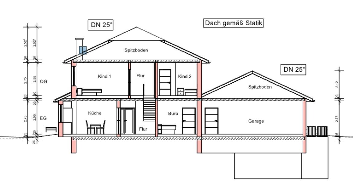

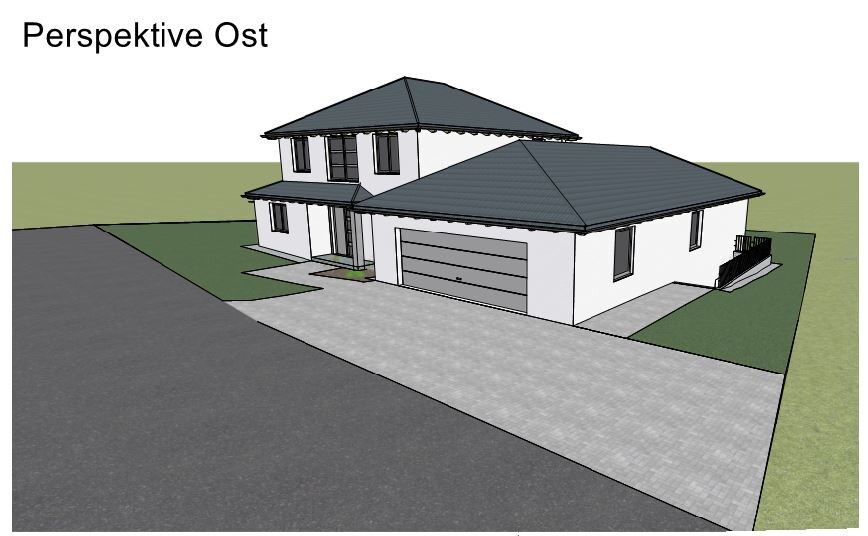

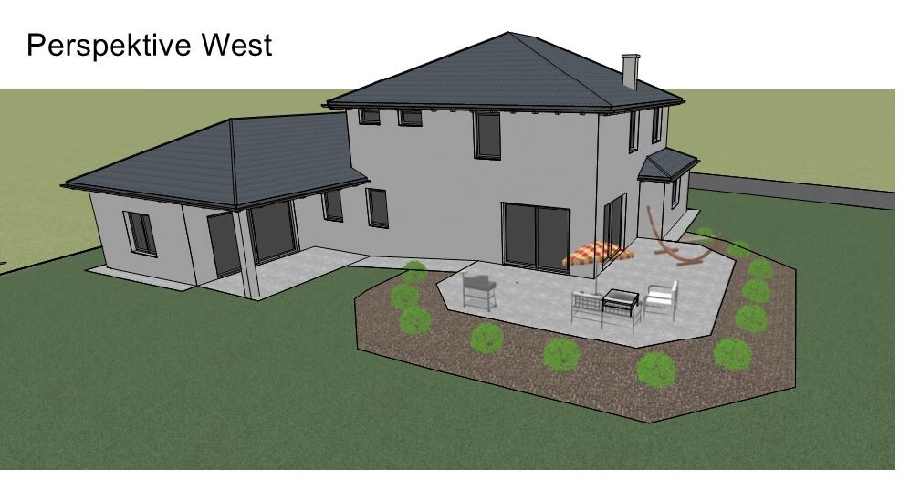

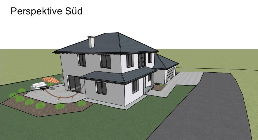

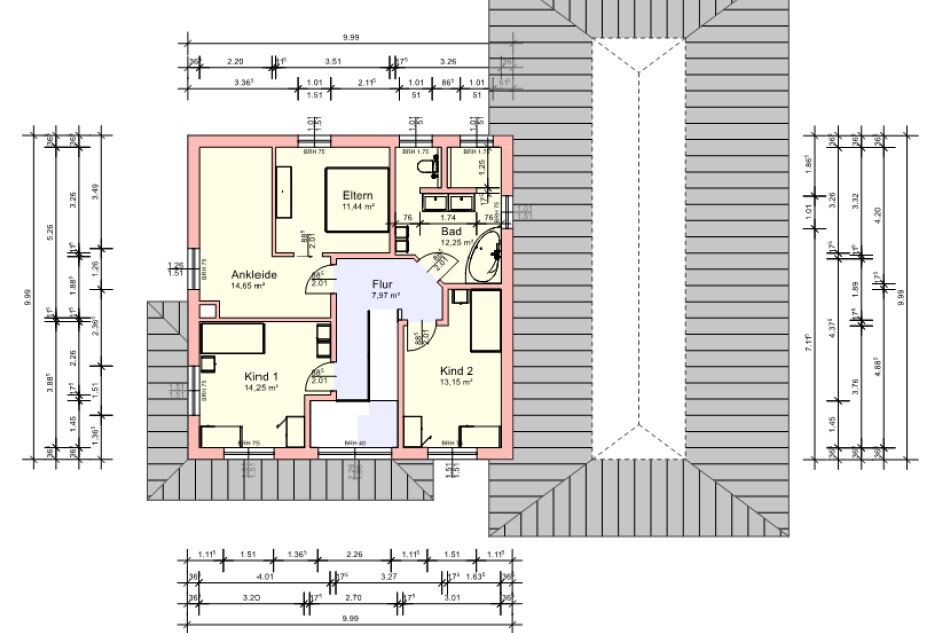

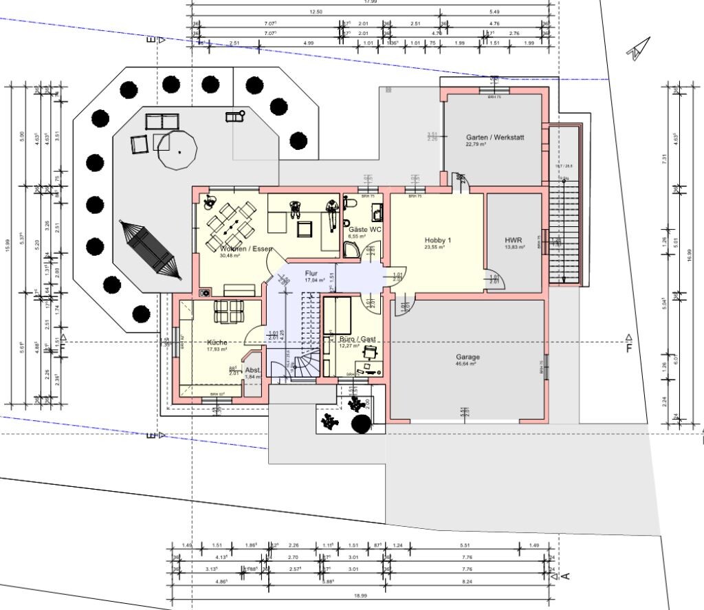

Hello forum community,
we are currently in the planning phase for our house. We have done a lot of research and gathered ideas to make the planning as optimal as possible for us. We were also able to take some ideas from this forum, so thanks to all the active readers and contributors for sharing useful information.
I have attached the floor plans (I hope everything is legible). We have been working on the planning for about 9 months now, and after a while you tend to get stuck in a certain mindset and overlook some things or no longer notice them.
Therefore, we are very grateful for any opinions, constructive criticism, or tips.

Project_20203 May 2020 20:18Thanks first of all for the responses.
The bedroom and dressing room are intentionally planned that way. In the bedroom, only the bed and a small chest of drawers are meant to be placed, as we only sleep there. The planner personally didn’t find it ideal either, but from our point of view, it works. Since we have different waking times, the first person getting up does not disturb the second, and you can get ready calmly in the bathroom and dressing room without having to go through the bedroom again.
The storage room in the kitchen is about the same size as in our parents’ house; we have measured it.
All the equipment for heating and, prospectively, for a pool installation in the garden (which will be in the distant future) will be located in the small basement.
Regarding the living/dining room, we also thought about it and decided on a cozy sofa corner, which is intentionally somewhat narrower. However, the sofa shown in the plan is too large, as you rightly pointed out. The table does not necessarily need to be positioned as shown.
We plan to place the wardrobe/shoe cabinet under the stairs.
The fireplace is correct and is to be enclosed in the living room; the one in the kitchen is the refrigerator. A door in the kitchen should be considered (where the refrigerator currently is, then we would only need to extend the terrace).
Walls angled at 45 degrees are dead space, but we really like them and do not want to miss them in those spots.
Budget is not sufficient
The staircase next to the door fits a small suburban house.
The hallway is too large.
The storage room next to the kitchen is too small. What should go in there? You can store more with kitchen cabinets.
In the living room, draw in properly scaled furniture including TV and table, with walking space.
The route from kitchen to terrace is long and impractical.
What hobbies do you have?
The walk-in closet is much too large, or is someone collecting handbags or 200 pairs of shoes here?
The children’s rooms are less favorably oriented and too small.
Overall, the room sizes are not well balanced.
For the stated budget, I don’t see the house being feasible.
The interior layout seems somewhat outdated. I would suggest critically reviewing the points of criticism mentioned. It’s noticeable that there are only two of you, otherwise many things would likely be planned differently.
