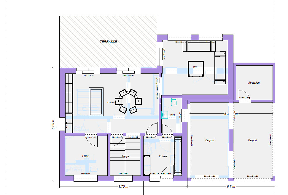

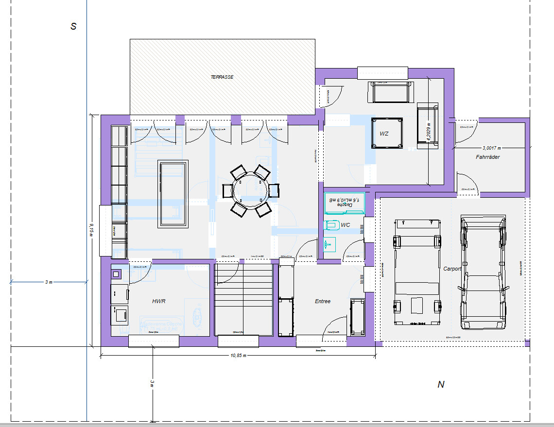

After following this forum for quite a while, our own project is becoming more concrete. We have secured a plot of land and have spoken with various general contractors and an architect. So far, my wife and I like the architect’s design best. It is still a draft plan, but it already feels very "right" for us.
Therefore, I would appreciate your feedback. Are there any critical points we might be overlooking? What could be solved more cleverly?
I hope I have included everything needed. If not, I’m happy to provide more information. Unfortunately, the basement is still the old version; it has now been mirrored and the light shafts have been slightly changed. You can see this on the ground floor plan.
Looking forward to your feedback!
Thank you very much! mini

What do you like most?
Open and spacious, all our wishes were taken into account. We wanted to keep the building’s main shape as simple as possible and avoid dormers, bay windows, and setbacks.
What do you not like? Why?
Could it possibly be a bit smaller? We don’t have to fully exhaust our budget...
Estimated price according to architect/planner: approx. $600,000
Personal price limit for the house, including fittings: -
Preferred heating system: heat pump with ground collector, possibly supplemented with photovoltaic. Maybe switch to a standard air-to-water heat pump?
If you had to give up something, which details or upgrades would you cut?
Difficult, we don’t really have anything we would cut.
Why did the design turn out as it is now? For example:

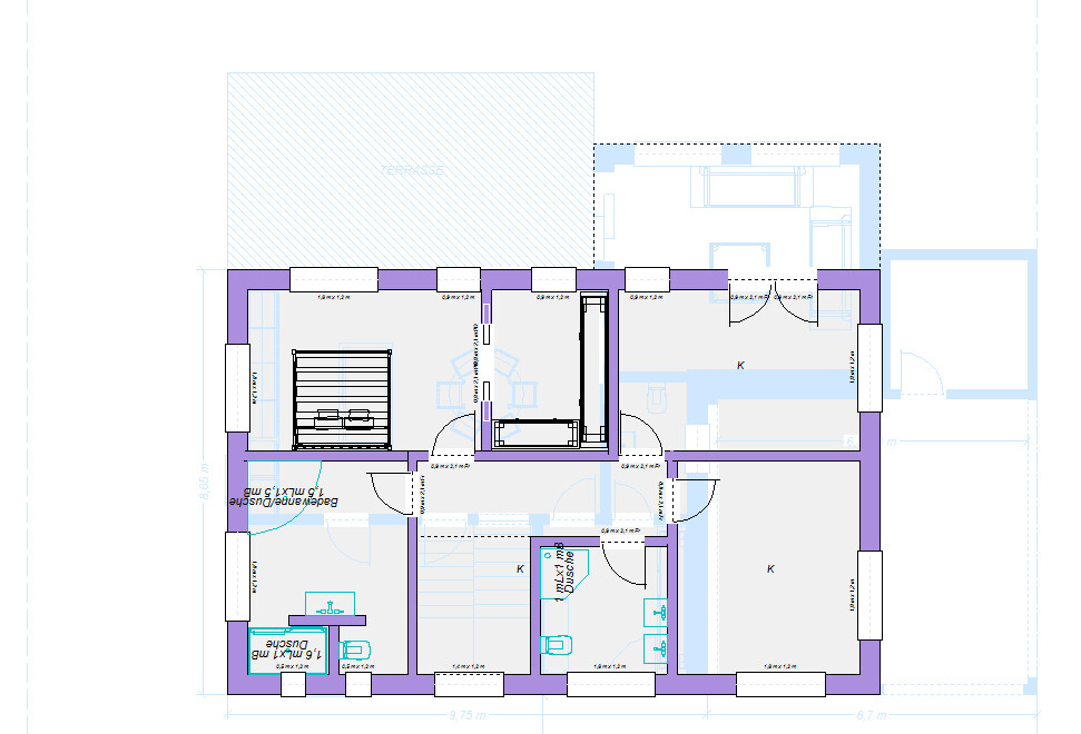

We spent a long time thinking about the floor plans, looked at many houses online and from friends/family. We wrote down everything we liked and also what we didn’t want. For example, a clear design without bay windows, setbacks, or similar features was important to us. This is what we took to the builders and the architect. The result is this plan.
Are there any optimizations in the floor plan that we may have missed? Enough windows/daylight in general?
Technical architectural drawing of a house with system section and northwest/northeast views
Floor plan of a house: cooking/living/dining, stairs, garage, carport, terrace.
Floor plan of a building: workshop, office, hallway; outdoor area with trees.
Upper floor plan: hallway, bathroom, walk-in closet, bedroom, two children’s rooms, terrace.

I think the plan itself is good, @kaho674, and the more I look at it, the better it gets.

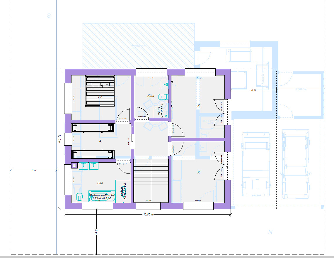

kaho67424 Nov 2019 22:00
kbt09 schrieb:
I think the plan is good overall...

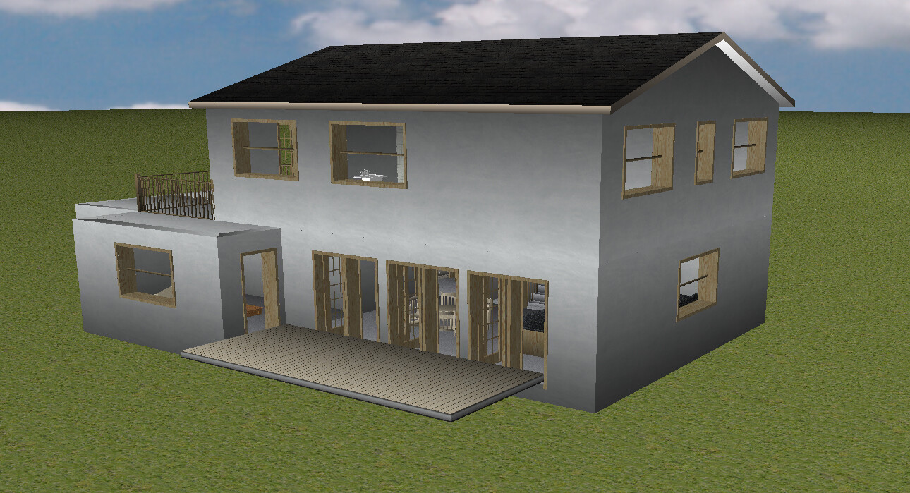

You can save a few centimeters (inches) by building over the carport. However, the terrace would only be accessible from one child’s room. On the other hand, you get a more sheltered seating area facing the garden.
Floor plan of a house with terrace, dining room, kitchen, utility room, entrance hall, stairs, living room, guest toilet, carport.
Floor plan of a house with several rooms, stairs, kitchen, bathroom, and terrace
Two-story house with carport; red and blue cars parked in open garages.
Two-story house with gray facade, black roof, balcony on the left, and terrace in front.

kbt09
24 Nov 2019 23:09
In the second option, however, a rooftop terrace or balcony will usually not be possible because a 3-meter (10 feet) setback from the edge must also be maintained there.
kaho67425 Nov 2019 06:45
kbt09 schrieb:
In the second option, a rooftop terrace is generally not possible since a 3 m (10 ft) setback from the edge must also be maintained there.
In this option, as mentioned, the rooftop terrace is planned only above the top-floor children’s room facing the garden.
