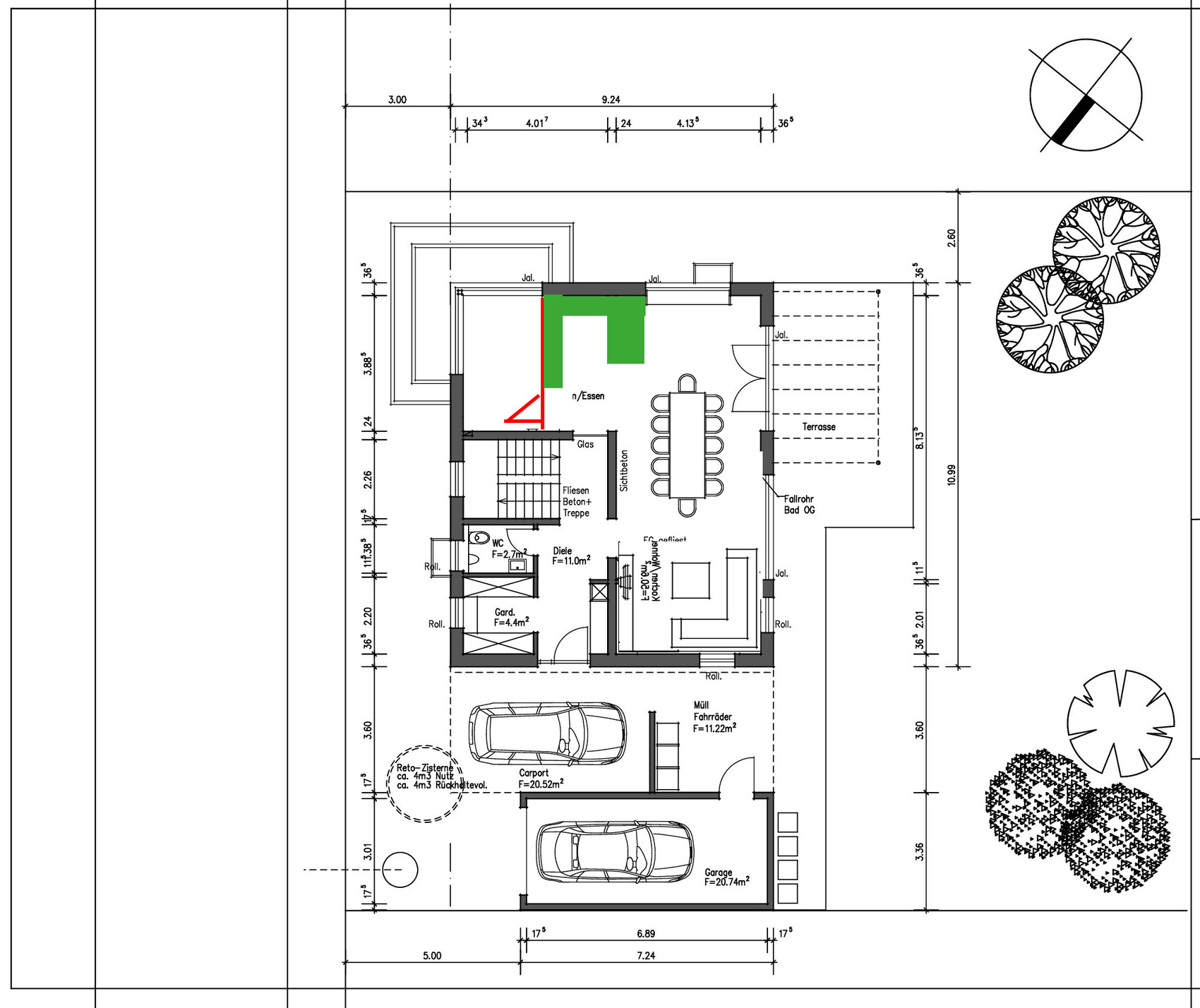

After following this forum for quite a while, our own project is becoming more concrete. We have secured a plot of land and have spoken with various general contractors and an architect. So far, my wife and I like the architect’s design best. It is still a draft plan, but it already feels very "right" for us.
Therefore, I would appreciate your feedback. Are there any critical points we might be overlooking? What could be solved more cleverly?
I hope I have included everything needed. If not, I’m happy to provide more information. Unfortunately, the basement is still the old version; it has now been mirrored and the light shafts have been slightly changed. You can see this on the ground floor plan.
Looking forward to your feedback!
Thank you very much! mini

We’ve been thinking this over again. We don’t see a way to make it work. Because of the upper floor, the staircase location is basically fixed. One important point for us is to position the coat area so that access to the guest bathroom does not pass through the "dirty zone." I’m afraid we’ll have to stick with the "L" layout.

No, I definitely wouldn’t do that. I think the L-shape is very well designed, and the lounge area is quiet.
However, I would consider what will actually take place in the utility room. You might also move the front door further to the right according to the plan; this way, the wardrobe and restroom can be deeper, and the entrance to the utility room can be accessed from the hallway.
Also, I would try to reroute the wastewater pipes from the children’s bathroom more through the ceiling, so that a shaft is created nearer to the utility room rather than in the middle of the area between the kitchen and dining spaces.
I would also take the suggestions regarding the bedroom into account. I find having the headboard directly next to the passageway to the dressing room quite unpleasant.
kaho67423 Nov 2019 19:09
kbt09 schrieb:
No, I definitely wouldn’t do that. I think the L-shape is really well designed, and the chill-out area is nice and quiet.
I’m honestly surprised that most people prefer to give a part of the sunny garden side to the utility room instead of the living spaces. That wouldn’t be an option for me. But okay. At least I would move the terrace more towards the center of the garden so you’re not sitting so close to the neighbor’s fence.

Well, the living area gets east, south, and west sunlight... but the west sunlight is only for looking at. The question is always, when do you actually use the sofa? In the evening to watch TV? For guests? My guests usually sit at the table, eating together, playing games, and so on.

Apologies, it’s been a busy day. I did check in but couldn’t respond.
- Bathroom upstairs: I would swap the shower and toilet, and also extend the long window accordingly. Advantage: toilet somewhat hidden, but still with an outside view.
We’ll take a look at that, thanks!
- I think the access points to the terrace are too few.
That’s my concern as well. It’s three meters (10 feet), which seems a bit narrow to me. With the L-shape layout, 3.50 meters (11.5 feet) should be possible, and for more, Katja’s suggestion makes sense.
kaho674 schrieb:
You’re right, this option is possible. The reasoning is sound too. Drainage should be feasible due to the bathroom above.
We’re considering it but are having some difficulty letting go of the old layout. We need to prepare another update for the architect tomorrow; maybe then it will click.
kbt09 schrieb:
No, I definitely wouldn’t do that. I think the L-shape is really well done; the chill area is quiet.
That’s true, the garden side could be used more. Cars on the street would, at least theoretically, shine into the living room. Katja has a point there.
kbt09 schrieb:
I would consider what really needs to happen in the utility room?
Primarily storage for supplies and drinks for everyday use; the rest goes in the cellar. Vacuum cleaner and cleaning supplies; kitchen appliances not used regularly. Paper waste and recyclables. Some workspace for prepping or putting down dirty dishes. A simple metal sink for rinsing and maybe shoe cleaning?
Laundry definitely goes in the cellar.
kbt09 schrieb:
Maybe push the entrance door further to the right in the plan so the cloakroom and WC can be deeper and the utility room access can be from the hallway.
The room should stay directly accessible from the kitchen. Otherwise, a smaller storage closet would suffice.
kbt09 schrieb:
Also, I would try to have the plumbing waste from the kids’ bathroom rerouted more in the ceiling and have a shaft positioned more towards the utility room rather than cutting through the area between cooking and dining.
We will ask about that; maybe it’s still possible.
kbt09 schrieb:
I would also take on the suggestions for the bedroom. I always find a headboard right next to the door to the walk-in closet very uncomfortable.
I don’t see a problem there. The side towards the passage would be mine; I currently sleep with my head next to the door and it’s fine.
There is enough space to rotate the bed if needed.

kbt09 schrieb:
Well, the living area gets morning, midday, and afternoon sun... but the west-facing sun is only for looking at. The real question is, when do you actually use the sofa? In the evening for watching TV? For guests? In my experience, guests usually sit at the dining or family table. People eat together, play games, and so on.
We crossed paths here. I would have said the same: visitors mostly sit at the dining or family table. The sofa is used less often.
