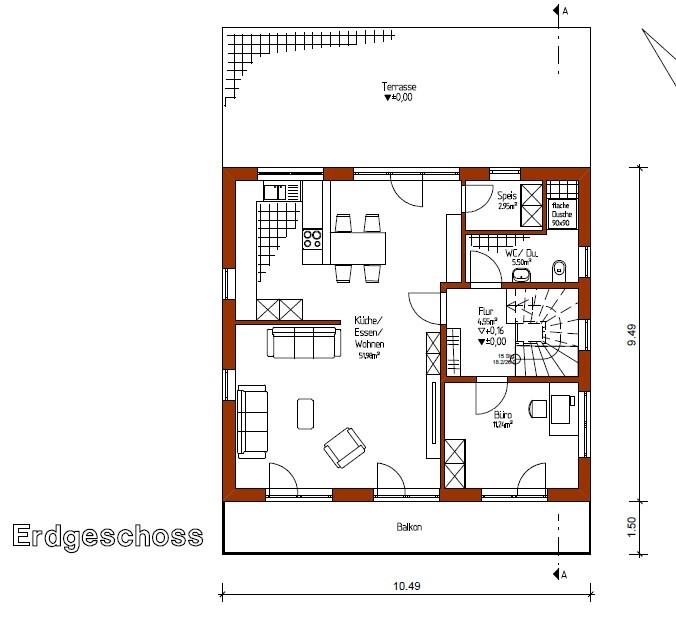

Could you please upload the ground floor plan again? It won’t open.Hello ypg, I have re-uploaded it; it should work now.

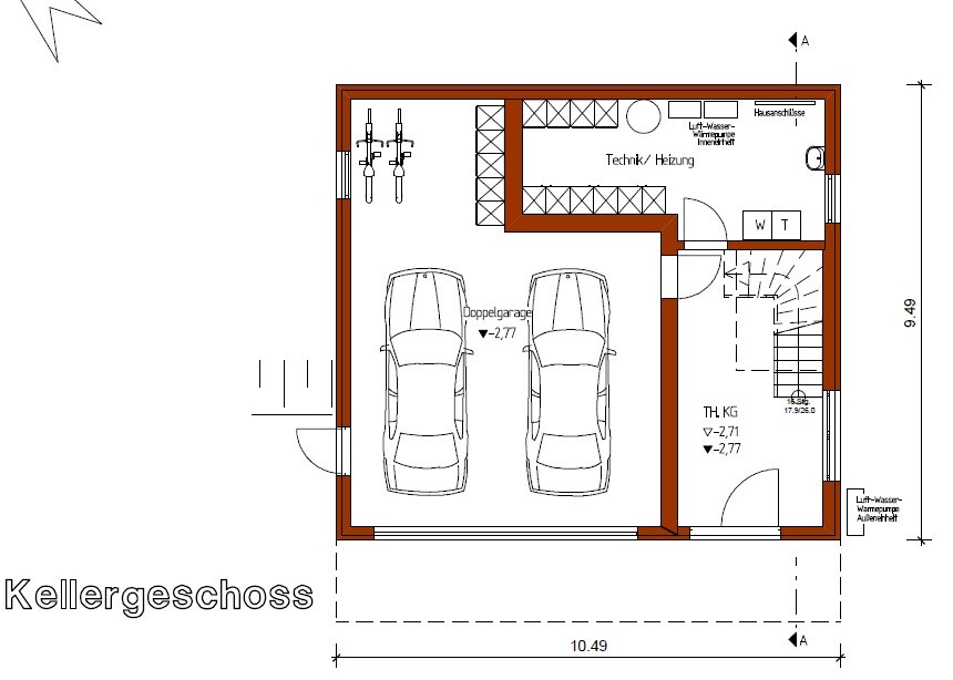

Hello, I basically like it as well. What I would reconsider is the layout of the bathroom and the dining area. The dining area seems a bit small to me.
I would also plan for a wardrobe in the basement, as I’m not sure where you want to place it.

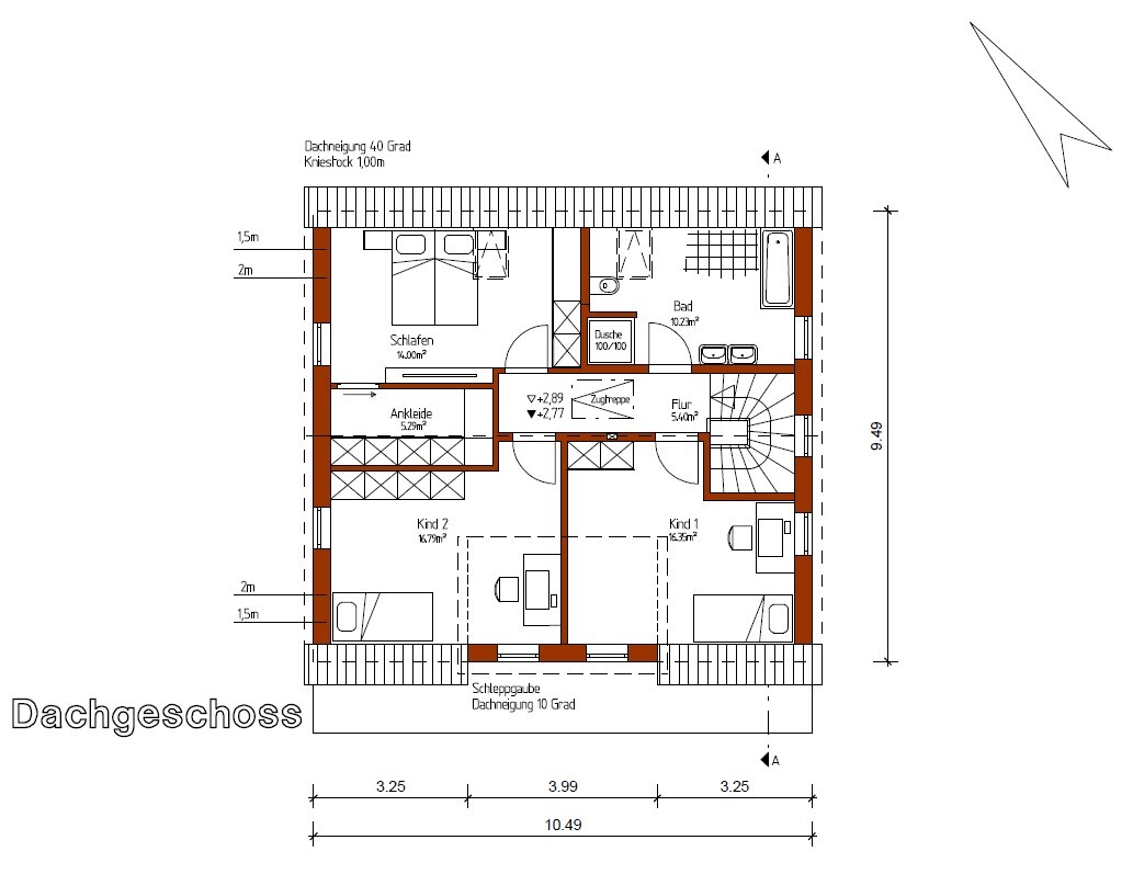

Upstairs, I would add a door from the walk-in closet to the hallway. Alternatively, you could integrate the walk-in closet directly into the bedroom.

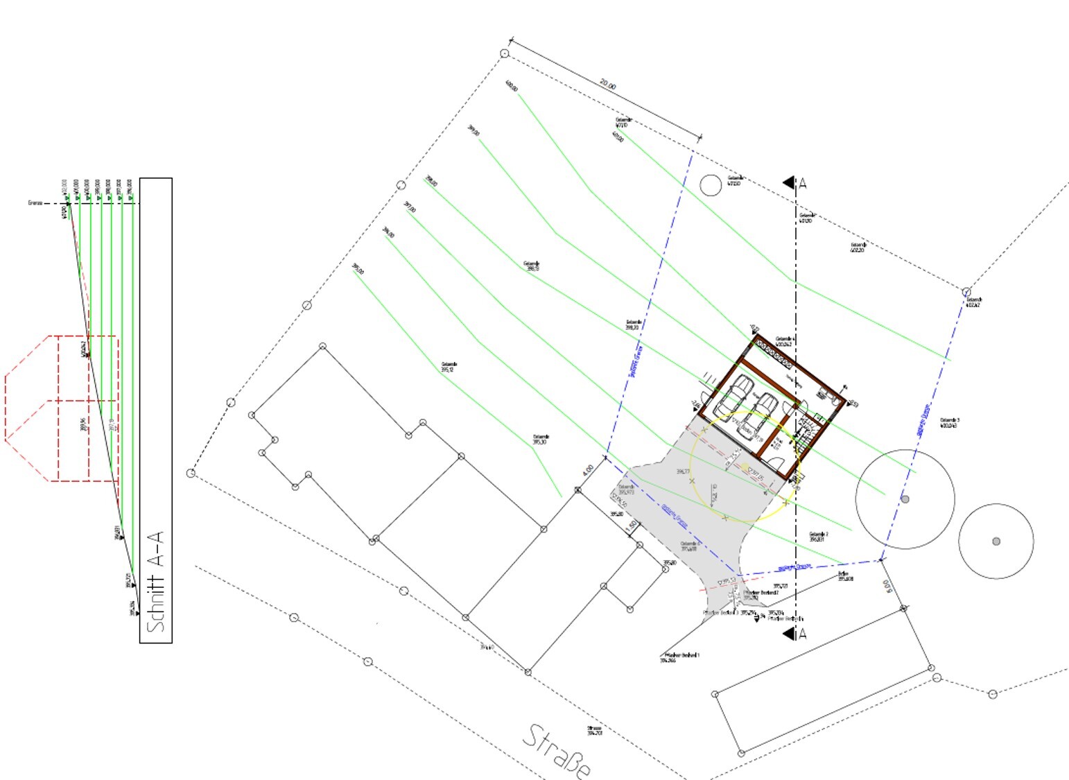

Nice-Nofret25 Dec 2020 09:07On the hillside side, I would reduce the roof pitch (possibly planning a shed roof) to cover part of the terrace.
