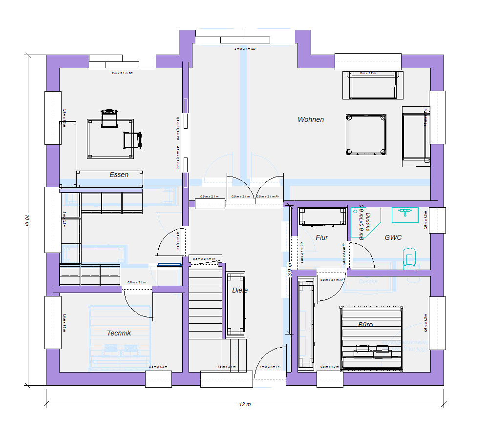

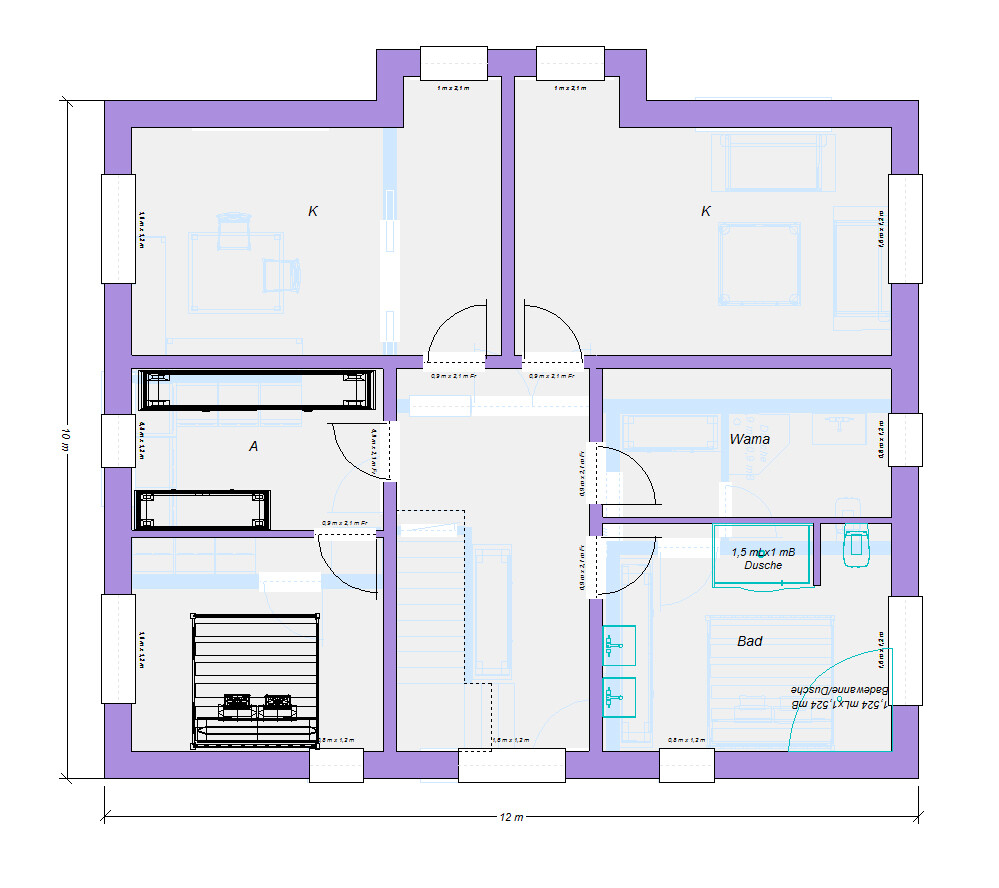

Based on various prefabricated houses, we designed our own floor plan. The study on the ground floor should be large enough to possibly use as a bedroom. The living room faces south, and the children’s rooms are equally sized. The washing machine would go into the storage room.
General room layout and positioning? Which knee wall height (1 m; 1.2 m; 1.6 m) would be optimal for space gain, cost savings, and daylight in the upper floor?
I hope the notes on the drawings are legible and understandable.
According to the development plan, only a knee wall height of 50 cm (20 inches) is allowed, but according to telephone information, deviations are approved as long as the maximum ridge height is not exceeded.
The drawing does not show any furniture.
The staircase should run straight in the hallway on the west side, so it opens in front of the two doors for the children’s rooms and the master bedroom.
Floor-to-ceiling windows are planned in the south-facing living room; all other windows will be "standard."
The kitchen is planned in the southeast corner of the house, hence the passage to the pantry. Originally, no pantry was planned; instead, there was a large utility room. On the advice of the house seller/consultant, a wall was added there so you don’t walk directly from the kitchen into the utility room.
A fireplace either next to the living room door or on the west wall.
Unfortunately, furniture was not included in the export: staircase runs straight in the hallway on the right side (when entering the house), so you reach the doors of the children’s and master bedrooms on the upper floor.
The current floor plan is based on external dimensions of 10.50 m by 11 m (34 ft 5 in by 36 ft 1 in).
If anything is unclear, please ask. Otherwise, feel free to ask questions or critique. I am not here just to receive praise (although that is always nice), but that’s not the purpose of this exercise.
Note the path between bedroom and bathroom. There is none.Are you referring to the ground floor between the office/guest room and the guest bathroom? I forgot to change the label, but you're right, it would be better if the guest bathroom and utility room could be swapped.Neubau2020 schrieb:
For us, walk-in closets fall into the category of "rather unnecessary." We have no problem changing clothes in the bedroom; there’s no need to go to a separate adjoining room (I know, this is quite fashionable right now).We are planning a walk-in closet, not because of current trends, but based on accumulated fashion from the past.
A single wardrobe in the bedroom wouldn’t be enough to store everything. With the walk-in closet, we have two wide wardrobe walls where we can also store shoes, winter coats, bed linens, towels, and more.
kaho674 schrieb:
You mean now on the ground floor between the office/guest room and the guest bathroom? I forgot to change the label, but it’s true, it would be nicer if the guest bathroom and the utility room could be swapped. On the ground floor, the room is actually planned more as a study, and guests are rarely expected, as far as I remember. I don’t find this layout particularly important and wouldn’t want to compromise the good plan for it.
Neubau2020 schrieb:
We are still considering building in a way that allows us to rent out the upper floor in old age, while we as a retired couple would only live on the ground floor. Today is the yesterday of tomorrow. The idea of holding on to the old place where the children grew up out of nostalgia will soon be outdated. The proportion of older adults in the community of homeowners is steadily increasing, and along with it, the trend of planning ahead for the Lifta phase (active retirement) is declining.
With this floor plan, a future separation would be possible. For that, a semi-spiral staircase could be used instead of the quarter-turn staircase. How practical this is, is another question.
I forgot about the fireplace, but that wouldn’t be a problem. It would run upstairs next to the washing machine and be located against the living room wall downstairs.
Neubau202017 Feb 2020 19:50I think this version is cleverly designed.
What do you mean by your statement?
kaho674 schrieb:
[ATTACH alt="EG.JPG"]43060[/ATTACH]
[ATTACH alt="OG.JPG"]43059[/ATTACH]
With this floor plan, a future separation would be possible. For this, you would use a semi-spiral staircase instead of the quarter-turn one. How practical that is, is another matter.
I forgot the fireplace, but that wouldn’t be a problem. It would go up past the washing machine and connect to the living room wall below.
