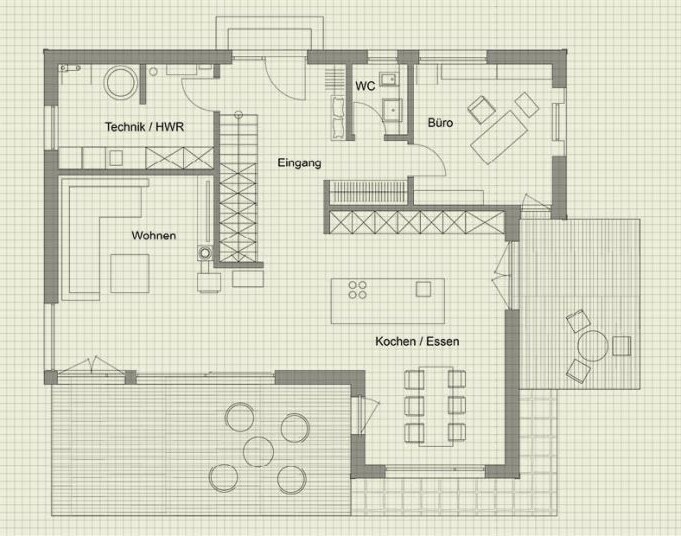

Not exactly. The main room is actually the kitchen-dining area. It is larger and the first room you enter. The chill room, on the other hand, is separate or completely closed off.
Although I also like the floor plan with the "conservatory."
From another thread, I find this floor plan really well designed. It also has a nice separation from the living area.

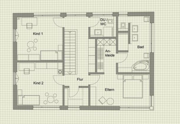

Floor plan of a house with entrance, office, kitchen/dining, living room, utility/technical room, WC, and terrace.
Floor plan of a house: master bedroom, two kids’ rooms, bathroom, shower/WC, hallway, dressing room.
DASI9014 Feb 2020 12:14
From another thread, I find this floor plan really well done. It also has a nice separation from the living area.
[ATTACH alt="CA6BB876-F6BE-4BCD-ACD8-DE19ECCF568A.jpeg.jpg"]43026[/ATTACH]
[ATTACH alt="945B8715-268D-465D-BC2B-06570E50501A.jpeg.jpg"]43025[/ATTACH]
Which thread was that?

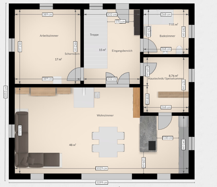

Neubau2020
14 Feb 2020 12:34
Having the chimney 3m (10 feet) away is a bit tricky. That means you'd have the pipe running across the room somewhere, right? I would rather try to place the stove on the gable wall, as that way you hardly lose any space for the photovoltaic panels.
As I had drawn it, the distance is less than 2m (6.5 feet). The pipe would then, of course, go through the wall and run above the door in the office, or over the office door in the entrance area.
But as I said, if shading isn’t an issue, the chimney can of course be placed on the south side directly on the gable. However, it would then be in the way at the top, because it would stand exactly where the entrance door to the children’s room would be.
kaho67414 Feb 2020 12:37
Neubau2020 schrieb:
However, it would then be in the way upstairs, as it would be exactly where the entrance door to the children's room would be.
See #29, although I have concerns again whether it would fit through the ridge beam. We would need to check if anything needs to be adjusted.
Neubau2020
14 Feb 2020 12:45
kaho674 schrieb:
see #29, although I have concerns again about whether it goes through the ridge beam. We would need to check if some adjustments are necessary.
According to the current measurements, the ridge beam is 30cm (12 inches) from the living room wall towards the terrace. With that in mind, the chimney could be placed "inside" the study on the living room wall, which would mean no stove pipe running through the room. However, when opening the door, you would practically walk into the chimney. The pipe’s route would not be any shorter, though.
Floor plan of a house with living room, study, hallway, staircase, bathroom, and utility room.
