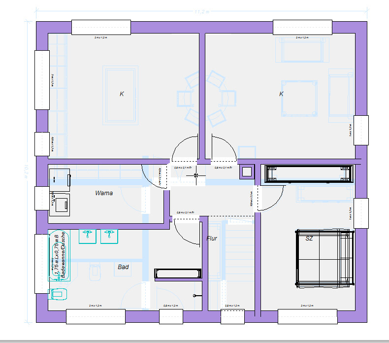

The main bathroom is not "furnished," but the bathtub bathroom in the study is (in my opinion) unusual. The walls, which again have not been measured, are arranged quite inconsistently. The house will likely be quite dark.
chrisw81
13 Feb 2020 13:27
The main bathroom is not "furnished," but the bathtub bathroom of the study (in my opinion unusual) is. The walls, again without measurements, are rather uncoordinated. The place will probably be quite dark.
Do you think the windows planned there already have their final dimensions? There’s definitely potential for larger ones.

Neubau2020 schrieb:
Here is another new attempt:
I think the kitchen is quite small.
I also believe the staircase is a bit tight (dimensions?).
The boiler room is not suitable to be used as a pantry.
The children’s rooms are distributed rather unevenly.
The chimney is too far from the fireplace.

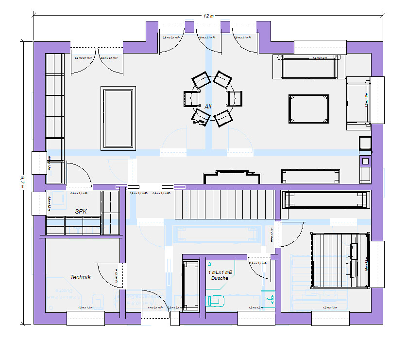

kaho674 schrieb:
The kitchen seems quite small to me. I think the staircase is also too tight (dimensions?). The boiler room is not suitable as a pantry. The children’s bedrooms are distributed quite unevenly. The chimney is too far from the fireplace.
Here's an alternative:
[ATTACH alt="EG.jpg"]43010[/ATTACH]
[ATTACH alt="OG.jpg"]43009[/ATTACH]
[ATTACH alt="A.jpg"]43008[/ATTACH]

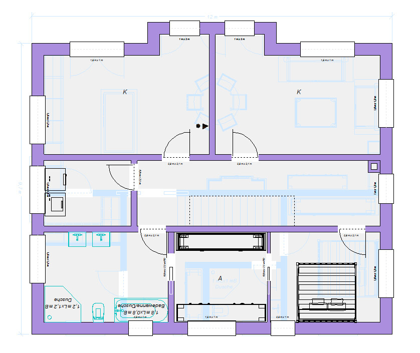

Great job Katja!!! I would remove the door from the dressing room to the bathroom, or did I miss something?
kaho67414 Feb 2020 08:18

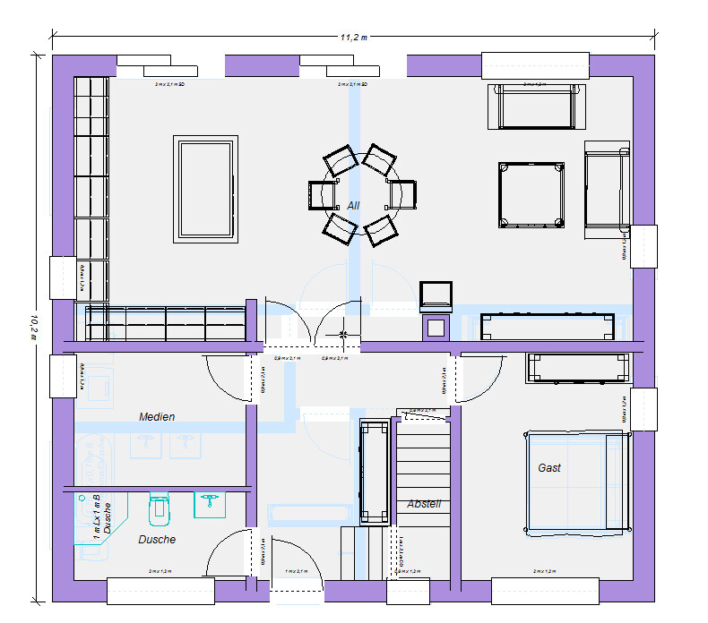

Design by the original poster slightly modified:
Floor plan of an apartment: living room with dining table, kitchen, shower, guest room, storage room.
Floor plan of a residential house: two large rooms (K), bathroom, corridor, bedroom, washing machine and stairs.
I removed the access to the utility room through the kitchen and instead enlarged the available floor space.
Well, I’m not sure. It could be built, but in my opinion, it completely lacks character. It’s quite a large house, yet the bedroom has very little usable space, and the living room feels somewhat cramped and plain. Although there is some zoning created by the fireplace, overall it feels dull at first glance. You’d almost want to add a conservatory to avoid getting bored.

Hello Katja, thank you very much for your suggestions.
The kitchen is quite small, in my opinion.
Okay, I’ll take note of that.
I think the staircase is too narrow (dimensions?)
The staircase measures 1.40 by 3.50 meters (4.6 by 11.5 feet), chosen as a standard size with various tread depths.
The heating room is not suitable as a pantry.
For what reason? We currently store rice, pasta, oil, etc. in our living room. What’s the difference?
The children’s rooms are quite unevenly distributed.
That’s true, I don’t like it either.
I was told that the fireplace can be about 3 meters (10 feet) away from the chimney. The closer, the better, of course.
However, we want to install photovoltaic panels on the south side of the roof, so I think it makes sense for the chimney to exit on the north side to minimize shadows.
Well, I’m not sure. It’s possible to build like this, but in my opinion it completely lacks a certain spark. It’s a fairly large house but has very little space in the bedroom. The living room feels somewhat cramped and plain. The zoning created by the chimney is there, but at first glance it seems dull. You’d probably want to add a conservatory just to avoid boredom.
A conservatory mainly causes additional costs, so we didn’t include it. What would your suggestion be to liven up the living room?
I really like both of your ideas.
We are also considering building in a way that would allow us to rent out the upper floor when we are older, and as retirees live only on the ground floor. In that case, option 1 wouldn’t work, but apart from that it is a nice concept. As for walk-in closets, we consider them somewhat unnecessary. We don’t mind changing clothes in the bedroom itself; we don’t feel the need to go to a separate room (I know, this is quite popular nowadays).
