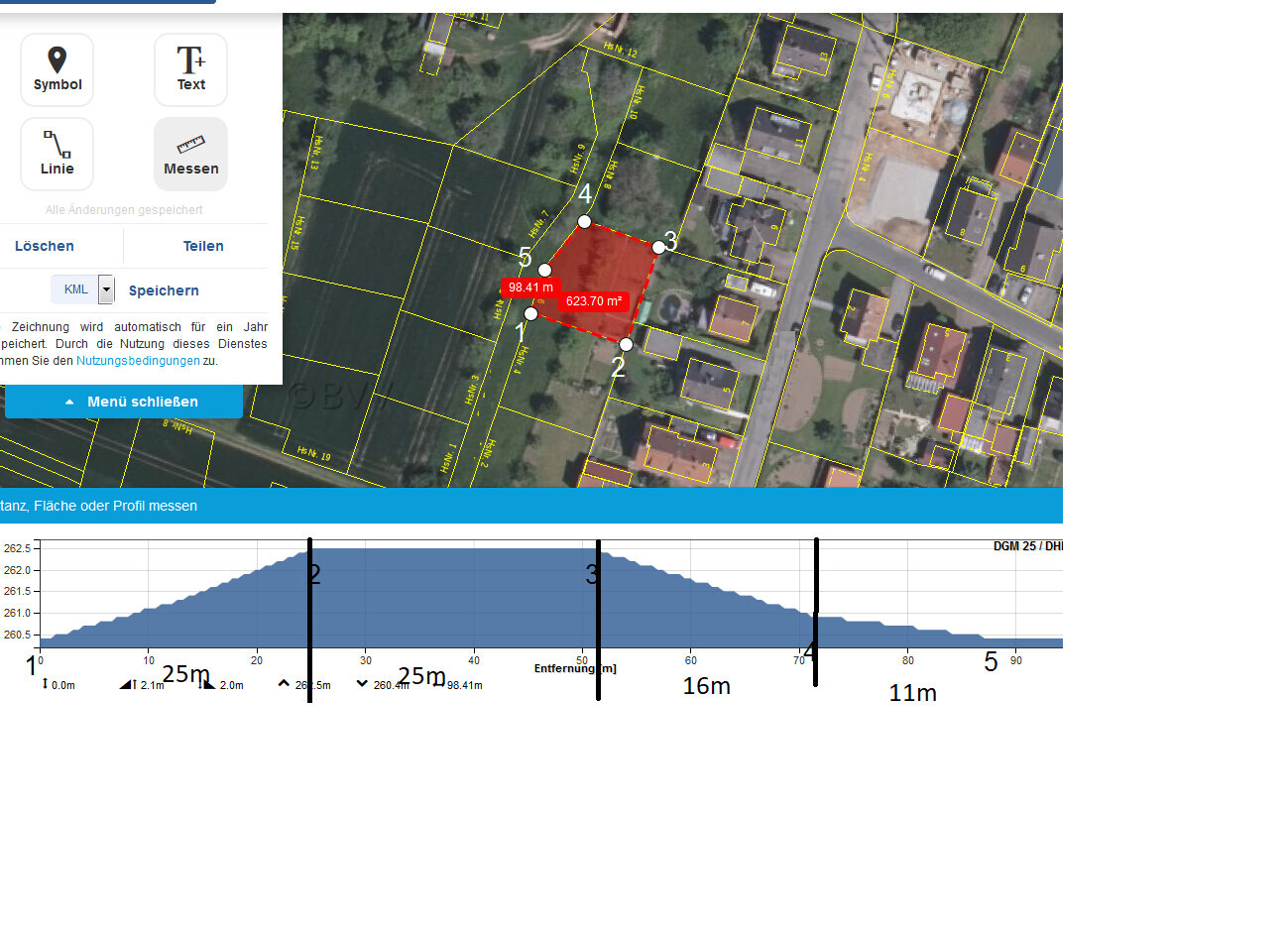

Plot size: 630 m² (6,780 sq ft)
Slope: slight incline toward the street
Floor area ratio (FAR): 0.35
Gross floor area ratio (GFAR): 1.0
Edge development: Located centrally in a dead-end street within a new residential development (infrastructure to be completed starting next year). The dead-end street ends to the north. A purely residential area with low traffic, as it is a small village (<2,000 inhabitants).

Neubau202020 Nov 2019 17:27The garage is actually the very first milestone. For this size (double garage with a storage room behind it = 3 single garages), I have received quotes starting at 30,000 euros.
I still dream of using the garage roof as an outdoor balcony since the sunset happens there and it offers a wonderful view towards the northwest. But is it really worth 30,000 euros? Also, access to the roof is difficult due to the knee wall.
I could also imagine having a parking space in front of the house facing the street, which is otherwise dead space that is not used.

I am interested in the positioning of the house on the plot. How much space is there between the terrace and the fence on the south side? Are there any dimensions available for the plot?

I am interested in the positioning on the plot. How much space is there between the terrace and the fence on the south side? Are there plot dimensions? Roughly speaking: square, 25m x 25m (82ft x 82ft)
I have attached the exact measurements again as a diagram.
With 6m (20ft) yard width and 11m (36ft) house width, there are 8m (26ft) left from the house wall to the fence (25 - 6 - 11).
