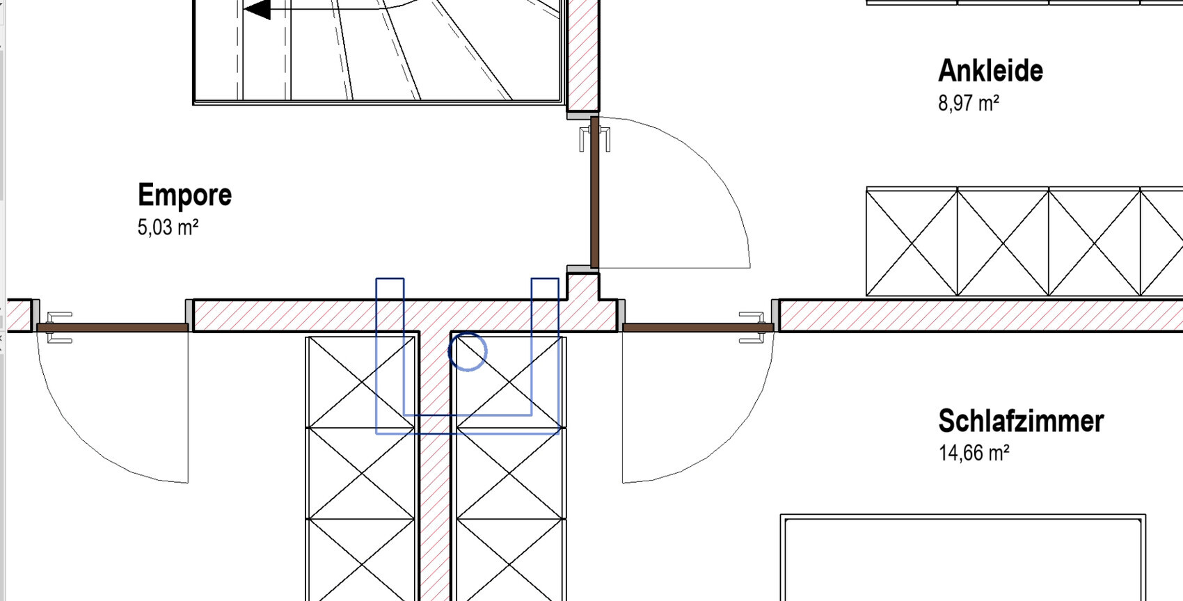

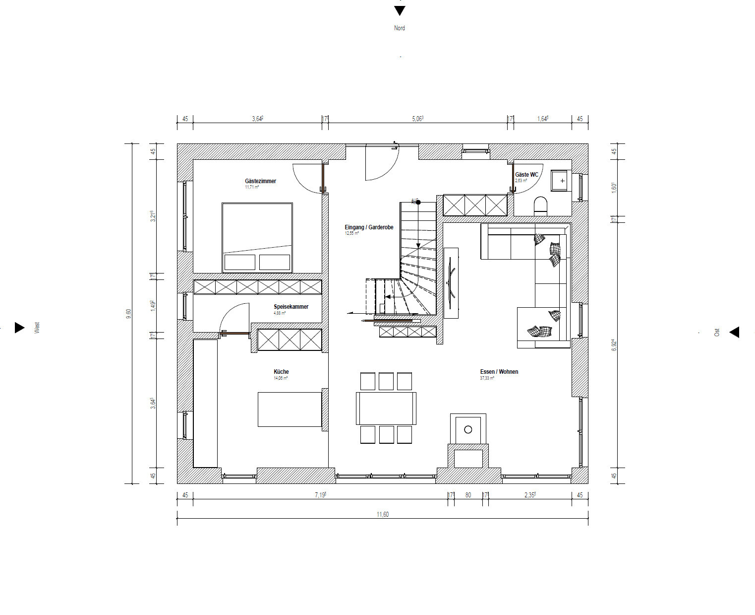

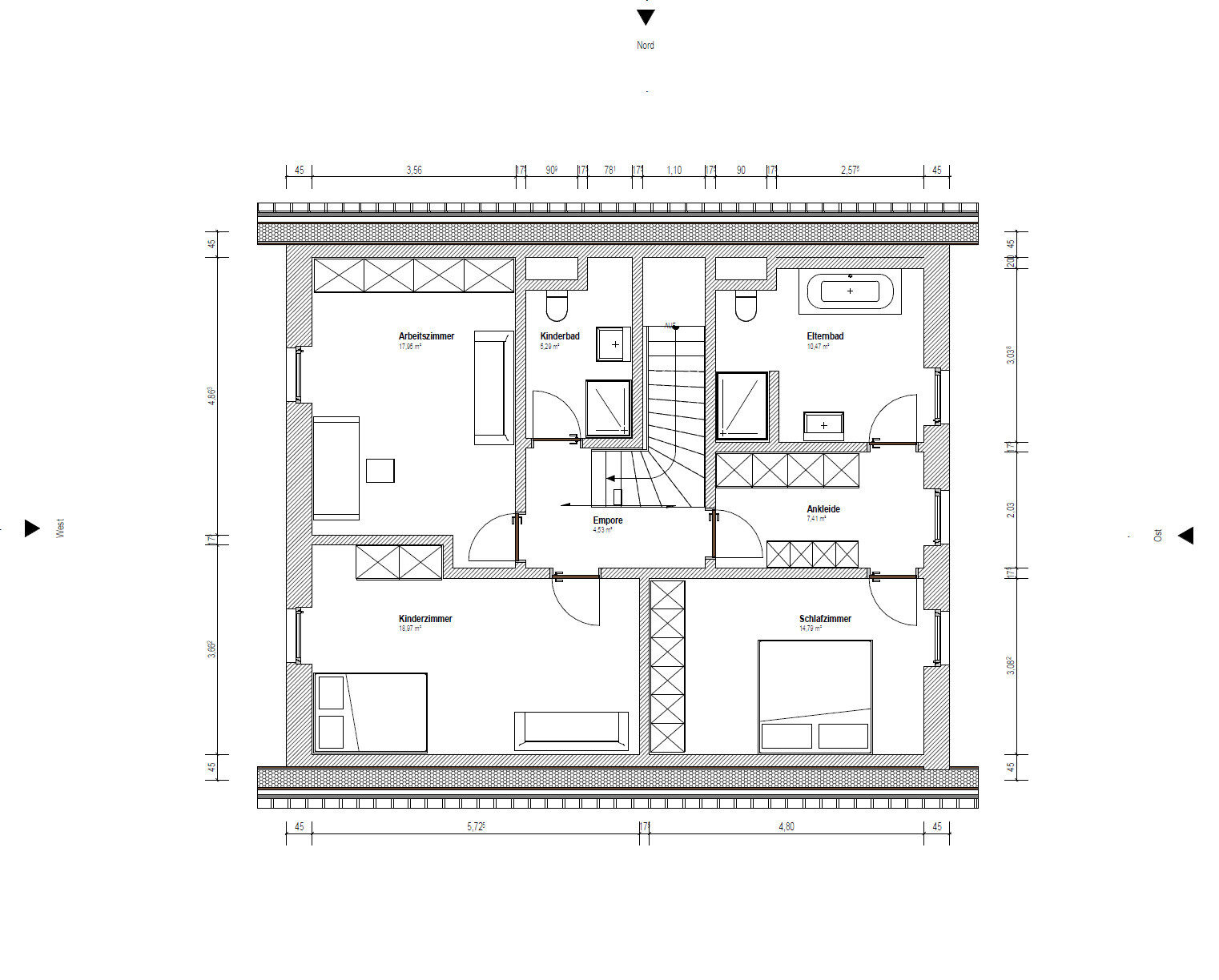

kaho674 schrieb:
Chimney on the upper floor? Can I persuade you to consider an aquarium instead?kaho674 schrieb:
Chimney on the upper floor? That will be added later.
Basically, it would bother me if the chill-out area is a passageway to the kitchen. Therefore, I would swap the kitchen and the living area and adjust the rest accordingly.
LukeLuu schrieb:

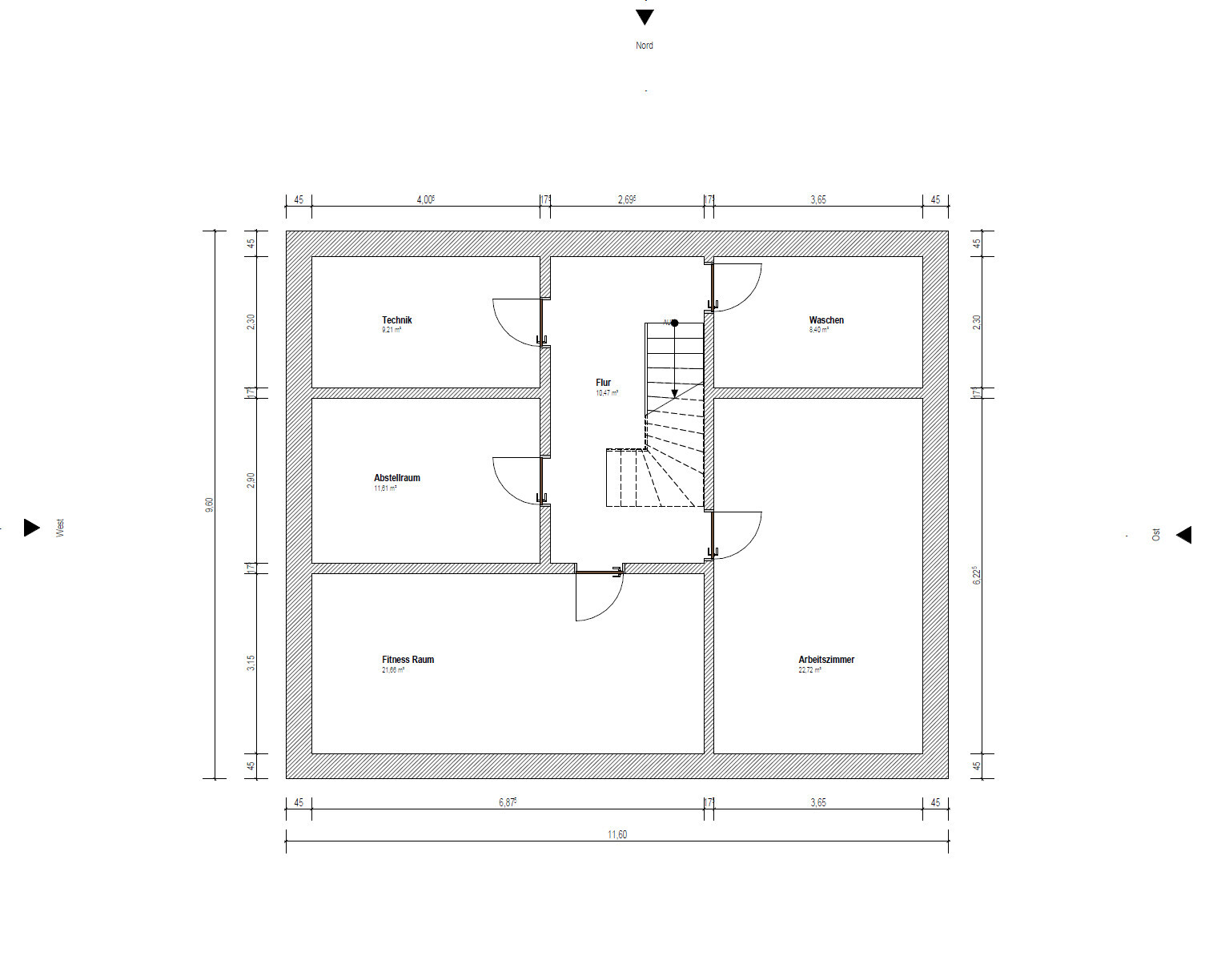

No, it doesn’t have to. But we both grew up in fairly spacious homes and prefer to have a bit more room. Generosity doesn’t happen in the basement. I would rather focus on generous comfort on the ground floor and upper floor, a nice utility room, a small kitchen in the pantry, a laundry room on the upper floor, and skip the basement altogether.
That’s an additional factor. Basically, I would be bothered if the lounge area was also the passageway to the kitchen. So I would swap the kitchen and living area and adjust the rest accordingly.I completely agree. But that’s why the utility room/pantry with the possibility of a passage makes sense to me, so I’ve come to terms with that. The previous layout was the other way around. However, this creates tight space upstairs with the master bathroom and walk-in closet. The staircase would need to be altered again, and the children’s bathroom ends up farther from the bedrooms.
Spaciousness isn’t really created in the basement. I would rather build generous comfort on the ground floor and upper floor: a nice utility room, a small kitchen in the pantry, laundry room upstairs, and skip the basement.For us, the basement works because everyone has their own spacious office, plus an additional hobby/fitness room down there.
The alternative would be to extend the house by about 1 meter (3 feet).
kaho674 schrieb:
Chimney on the upper floor?I think in the spot where it extends upward, it can be integrated quite well.
LukeLuu schrieb:
The staircase needs to be changed again, Would that be a problem during the planning phase?
LukeLuu schrieb:
I think the section where it goes up can be integrated quite well. Do you see more than we do? It doesn’t fit there at all. There isn’t any space in the hallway at that spot ops:
I think the spot where it goes upwards is relatively easy to integrate.Hehe, no. Can’t your software stack two floors? Such a chimney breast is at least about 40cm x 40cm (16 inches x 16 inches). Where is it supposed to come out at the top?I’m telling you: no chimney fits this house. Something like a built-in aquarium is really great...
Do you see more than we do? That doesn’t fit there at all. There’s no space in the hallway at that spot ops: kaho674 schrieb:
Haha, no. Can’t your software stack two floors on top of each other? Such a chimney flue is at least about 40x40cm (16x16 inches). Where would it come out at the top?
I’m telling you: no chimney fits this house. An aquarium would be really nice though... Here the chimney is routed straight up. In my opinion, this could work?!
Would that be a problem during the planning phase? The problem being that the kids’ bathroom would need to be relocated and the dimensions of the walk-in closet and bathroom no longer fit.
