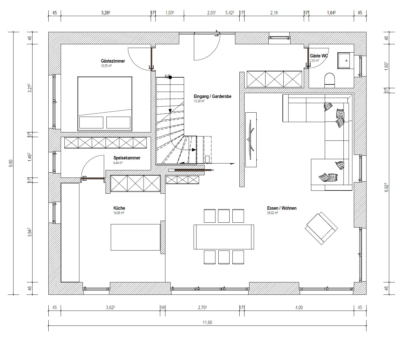

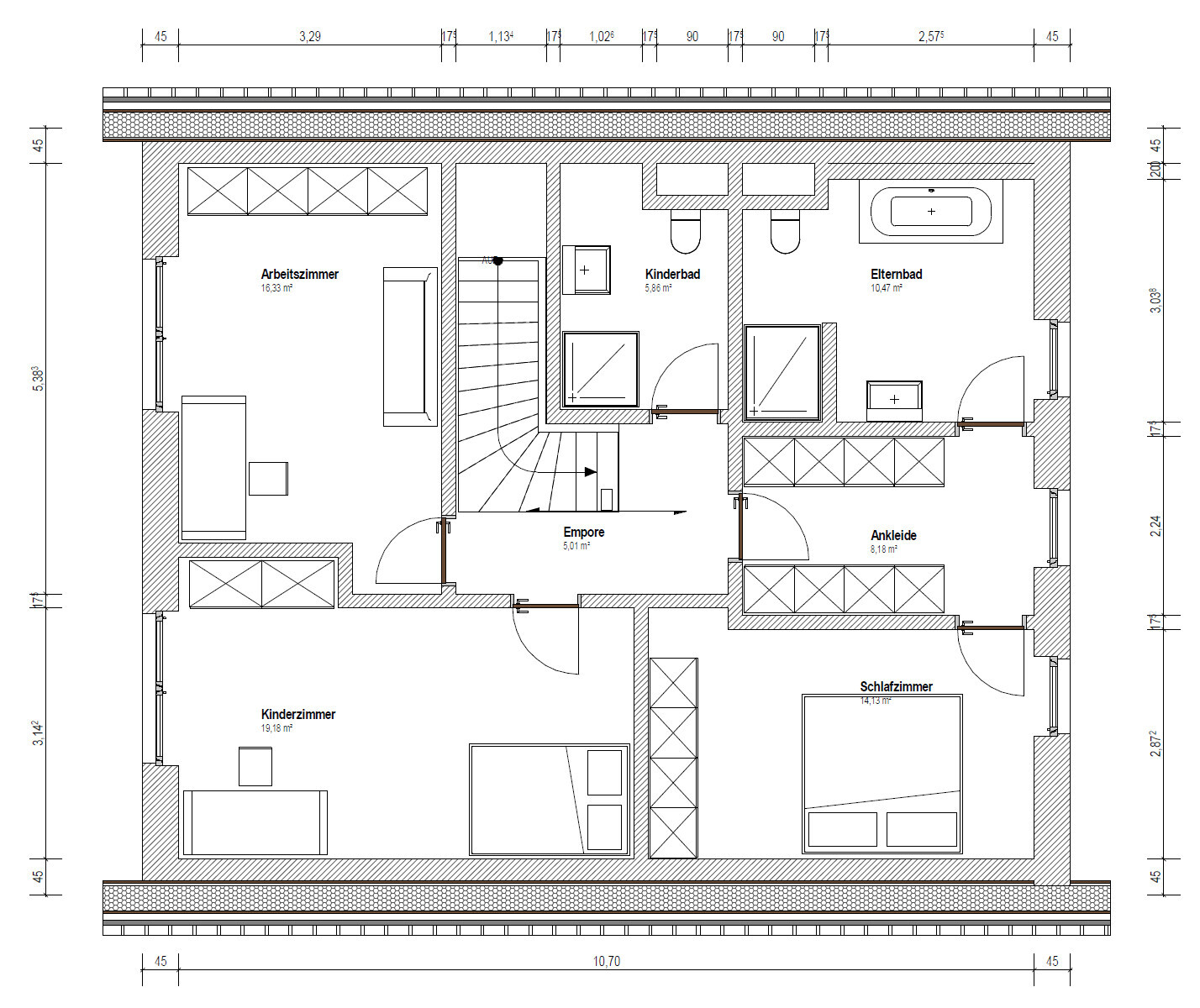

Hello everyone, we have purchased a plot of land and would like to start planning the construction.
The plans were created by myself. We do not have any offers yet, but we plan to visit home builders in the next few weeks.
Plot size: 1099m² (11825 sq ft)
Slope: no
Floor area ratio: -
Building coverage ratio: -
Building envelope, building line and boundary: -
Edge development: -
Number of storeys: 1/2 - 2
Roof type: -
Architectural style: -
Orientation: South or North
Maximum heights / limits: -
Other requirements: There is no development plan. Almost all types of houses are present in the neighborhood. So there are no restrictions.
Homeowner Requirements
Style, roof type, building type: Single-family house with a gable roof
Basement, floors: Basement, ground floor, attic
Number of people, ages: 2 x 29 years
Office: family use or home office? Home office for both
Overnight guests per year: 10-20
Open or closed architecture: Both
Conservative or modern build: Modern
Open kitchen, kitchen island: Open kitchen with glass sliding doors to separate it, island included
Number of dining seats: 4-6
Fireplace: yes
Music / stereo wall: Sonos system available
Balcony, roof terrace: No
Garage, carport: Double carport with storage shed
Utility garden, greenhouse: Not for now
Planned by: Do-it-Yourself
What do you like most? Why?
What do you dislike? Why? The walk-in closet is not perfect.
Price estimate by architect/designer:
Personal price limit for the house, including equipment: €500,000
Preferred heating system: Ground-source heat pump
If you had to give up anything, which details or additions
- You could give up: basement, but then larger footprint
- You cannot give up: 2 workrooms
Standard design from a planner? The basic dimensions are based on the Maxime 610 model by Viebrockhaus, with additional influences
We already like the floor plan quite a bit. The walk-in closet upstairs is still not ideal. Possibly the entrance could be through the bedroom, which would create more space in the closet.
Windows in the basement have not yet been included in the plan but are, of course, intended.
We would just like to hear some opinions on this since we are completely new to building.

Many amateur planners hope for a decisive first step from a blank page by using some key data or basic features of a model they like as a starting point. However, this "help" comes with a cost: it limits your thinking more than you might expect. It would be even more mistaken to assume that the basic features of a model with the same exterior dimensions roughly translate to the same price range. Once you move into the visual realm, it becomes difficult for inexperienced planners to stay abstract—which is actually still necessary during the preliminary design phase.
In my opinion, a better way to start planning is to first list the rooms and their approximate sizes, then in the next step divide the list into what goes on the ground floor and what belongs on the upper floor. If both floors have roughly the same area, this suggests a straight-walled upper floor (sometimes called a "town villa"). If the upper floor is about half the size of the ground floor, this points toward a one-and-a-half-story house.
This step is often skipped if you start from a model you like without comparing it to your own needs (for example, the original model might not have a bathroom for children).
LukeLuu schrieb:
The shower in the kids' bathroom is 80x100cm (31x39 inches) and in the master bathroom 90x120cm (35x47 inches)These are rough construction dimensions. This results in an effective shower width of around 74cm (29 inches) in the kids' bathroom. With typical building tolerances, this can quickly shrink to about 70cm (28 inches). This tends to be rather uncomfortable as the child grows into a tall teenager.
LukeLuu schrieb:
The shower in the children’s bathroom is 80x100 cm (31x39 inches) and in the master bathroom 90x120 cm (35x47 inches)You don’t like advice, do you? See #14
See #14Of course I do, otherwise I wouldn’t be here.
#14 explains it well enough that it needs improvement!
Take a look, at https://www.hausbau-forum.de/threads/Einfamilienhaus-owl-ca-150qm-mit-ostgarten.33419/page-14#post-378608 your Maxime has also been interpreted (the entrance and staircase are arranged differently, but otherwise you should recognize the floor plan).
