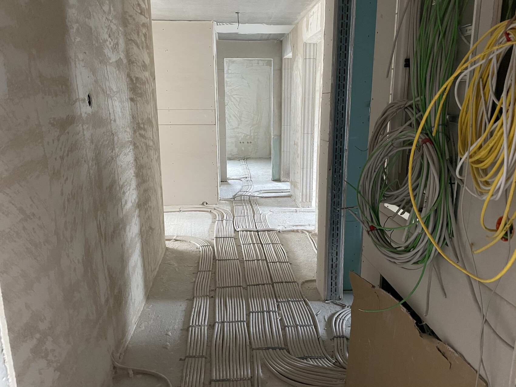

NoggerLoger6 Mar 2021 08:25@Schlauerfuchs
20mm (0.8 inch) Franconian empty conduits 650m (2132 feet).
25mm (1 inch) Franconian empty conduits 60m (197 feet).
400m (1312 feet) EIB cable.
320m (1050 feet) 5x1.5 cable.
60m (197 feet) 5x2.5 cable.
45m (148 feet) 7x1.5 cable.
