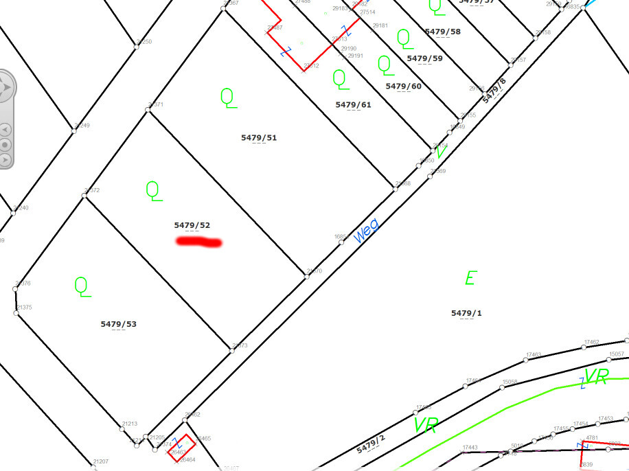

The feedback on the last plan led me to completely redesign it. Therefore, I would like to get your opinion on my new design as well.
800m² (8,600 sq ft) plot, to give a better idea I have attached the plot layout from GIS and the sun path calculation
Edge towards the street is 1m (3.3 ft) high, otherwise flat
Buildable area from the street is 3m (10 ft) up to about 20m (66 ft)
