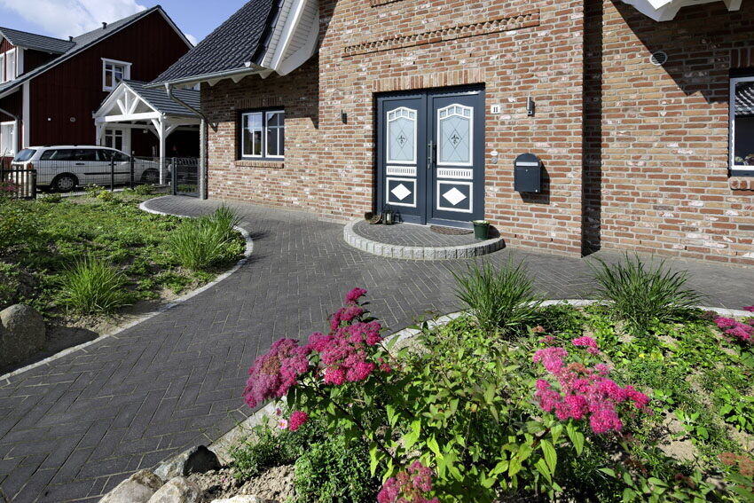

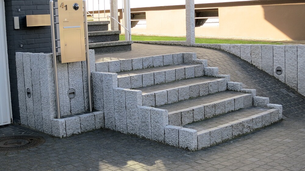

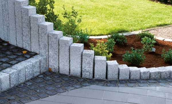

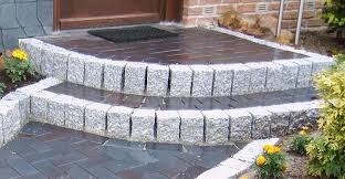

Granite stones, size 17/19. In between, standard anthracite-colored paving stones.
The anthracite paving stones cost 10€/sqm (10€/sq ft) in the standard version. Paving bricks look more premium and cost 30€/sqm (30€/sq ft).
Outside, granite bollards could also be installed. The bollards measure 12 x 12 cm (5 x 5 inches). The price is about 10€/piece.
A few pictures attached
