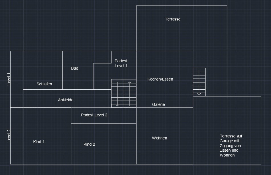

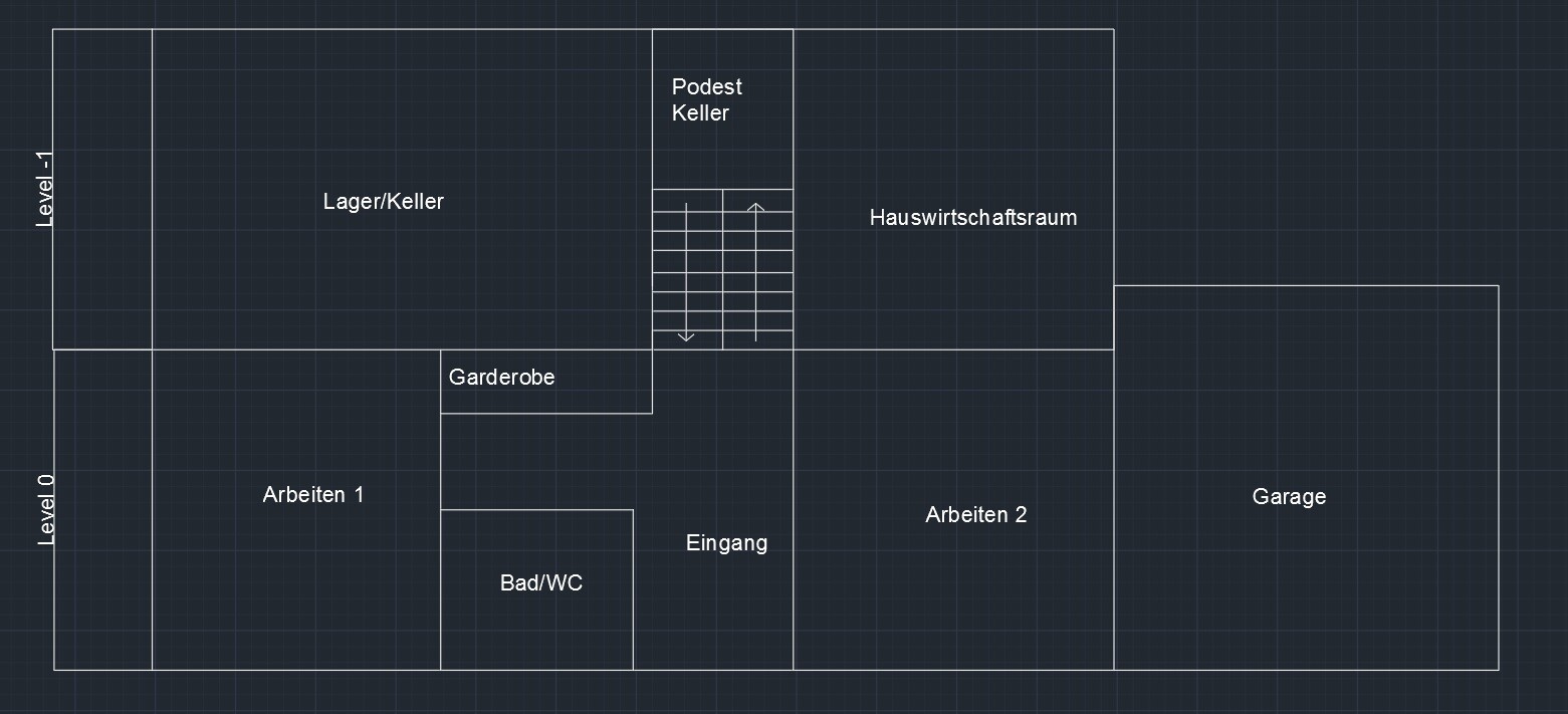

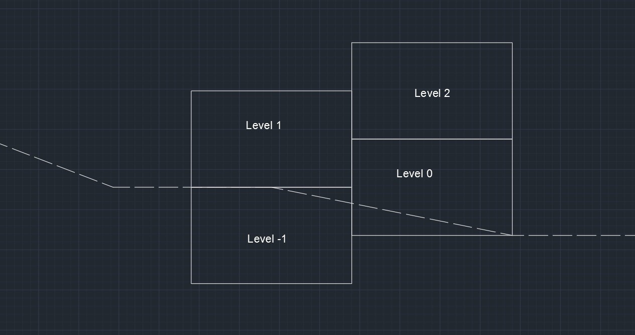

j.bautsch schrieb:
2x16m² (172 ft²) rooms for work and guest, but the children only get a cramped 12m² (129 ft²)? Somehow disproportionate 😉The children are supposed to move downstairs when they are older, so they will have their own separate area with a bathroom. That makes sense if you like it that way. As I said, I would prefer the living/dining/kitchen area downstairs.
I’m definitely not trying to impose anything just because this is how we would do it, but the site’s terrain almost screams for a split-level design... 😉
You have, in total, about 45m² (almost 485 sq ft) of hallway space.
That’s insane and pure waste of money. (At €1700/m², that adds up to a staggering €76,500)
Here are my thoughts on how you might approach the layout with a split-level design:
I’ve stayed with your proposed external dimensions for the rough idea, but keep in mind that wall thicknesses aren’t included here.
With some adjustment, this should be no big deal.
E-1 as a partial basement
The airlock area via the utility room from the garage is eliminated—I'm not sure if that’s really wanted.
As it stands, with the room width and door arrangement, it’s another waste of space that should actually be counted in the above 45m² (485 sq ft) of hallway.
E0 with entrance, cloakroom, and two workrooms (possibly future children’s rooms?)
E1 with parents’ area plus large open-plan kitchen/dining room
Including a ground-level exit to the garden terrace
E2 with living room and children’s room
The living room could be connected to the kitchen/dining area by a gallery (like in our house 😀).
If building regulations permit, you could add a large south-facing terrace above the garage, accessible from the living room. At the same time, the terrace could be reached via an external staircase from the kitchen.
This rough outline might help you move forward 😉
