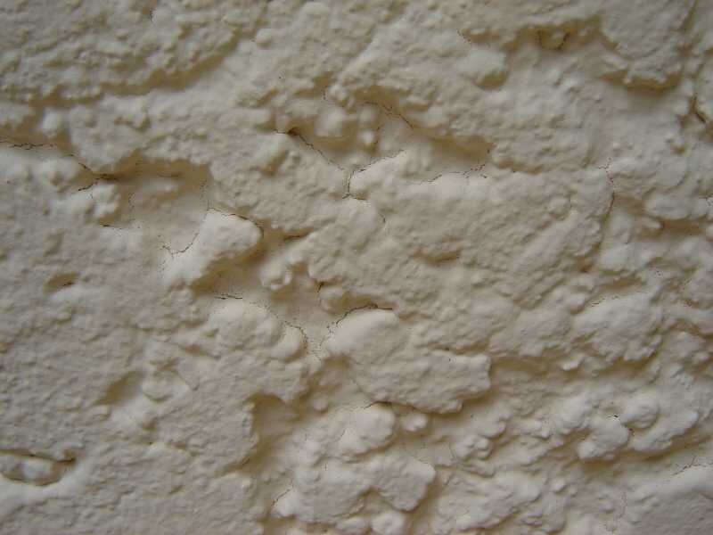

Hi everyone,
I had the facade of my house painted by a professional company, using silicone resin paint as stated in the quote.
After the first coat, I noticed many cracks in the paint. It was painted two more times, but without any improvement. Previously, the facade had no cracks.
The facade has many indentations due to the plaster. The paint was applied with a roller.
Now the company says these are just air bubbles and that this does not affect the quality.
I don’t believe that.
What do you think about this?

I’ve attached a photo!

I haven’t come across any mention of thousands of defect reports, lawsuits, or expert reports in the specialist press, but I would be grateful for any references to where this is documented. That would be nice, because of the expert report commissions.
Dirt stuck in the texture depths of rough plaster is unavoidable and not a defect; the hairline cracks are negligible compared to the plaster grooves as a proportion.

To me, these are just normal superficial drying cracks, skin cracks, within the plaster layers! Due to the already applied primer coat, the subsequent finishing coat, and the, in my opinion, not necessarily needed third coat with the same appearance for whatever reason, the protective function of the coating should not be reduced!

The representative from the paint company and the head of the painting contractor both assured me in writing during their visit that this is not a defect. Therefore, there is no reduction in the protection of the facade.
I hope they are right.
