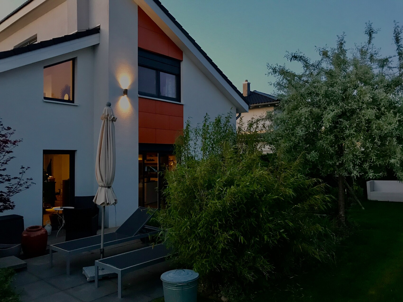

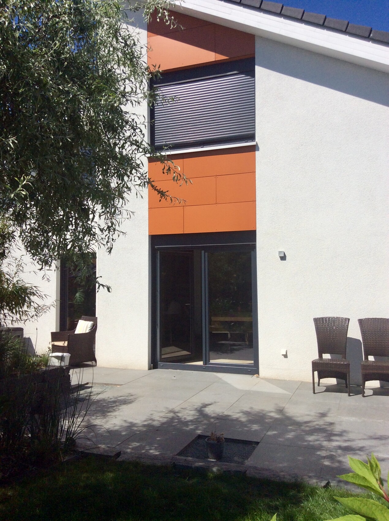

1 Jun 2020 14:50
Completed three weeks ago.
The battens were installed by a local carpenter using these HPL panels.
You probably don’t want to know the price...
The terrace is not furnished yet because the terrace roof is being installed tomorrow.

I
ivenh0
1 Jun 2020 20:09
Color is a matter of personal taste, but overall it looks great. Of course, we want to know the price.
