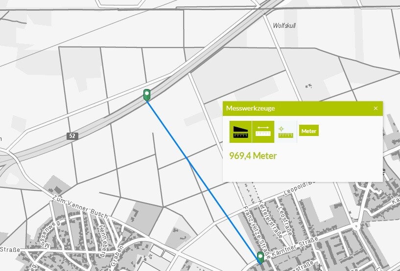

Before moving into our house, I lived in a rental apartment. The distance to the highway (no speed limit) was just under 1000 meters (3300 feet). When the wind was "favorable," you could basically not hear it, but when the wind was "unfavorable" and the window was open, you could hear a noise similar to the sound of the sea... well, almost. However, what you always heard, as long as you were awake and the window was open, were louder-than-average cars and motorcycles. So besides the constant background noise (which was measured at your place), there are still noise peaks. They generally won’t wake you up during sleep, but you do perceive them consciously.
And the second point I want to mention: with every doubling of the distance, the sound level decreases by 6 dB. Just some information for reference.
