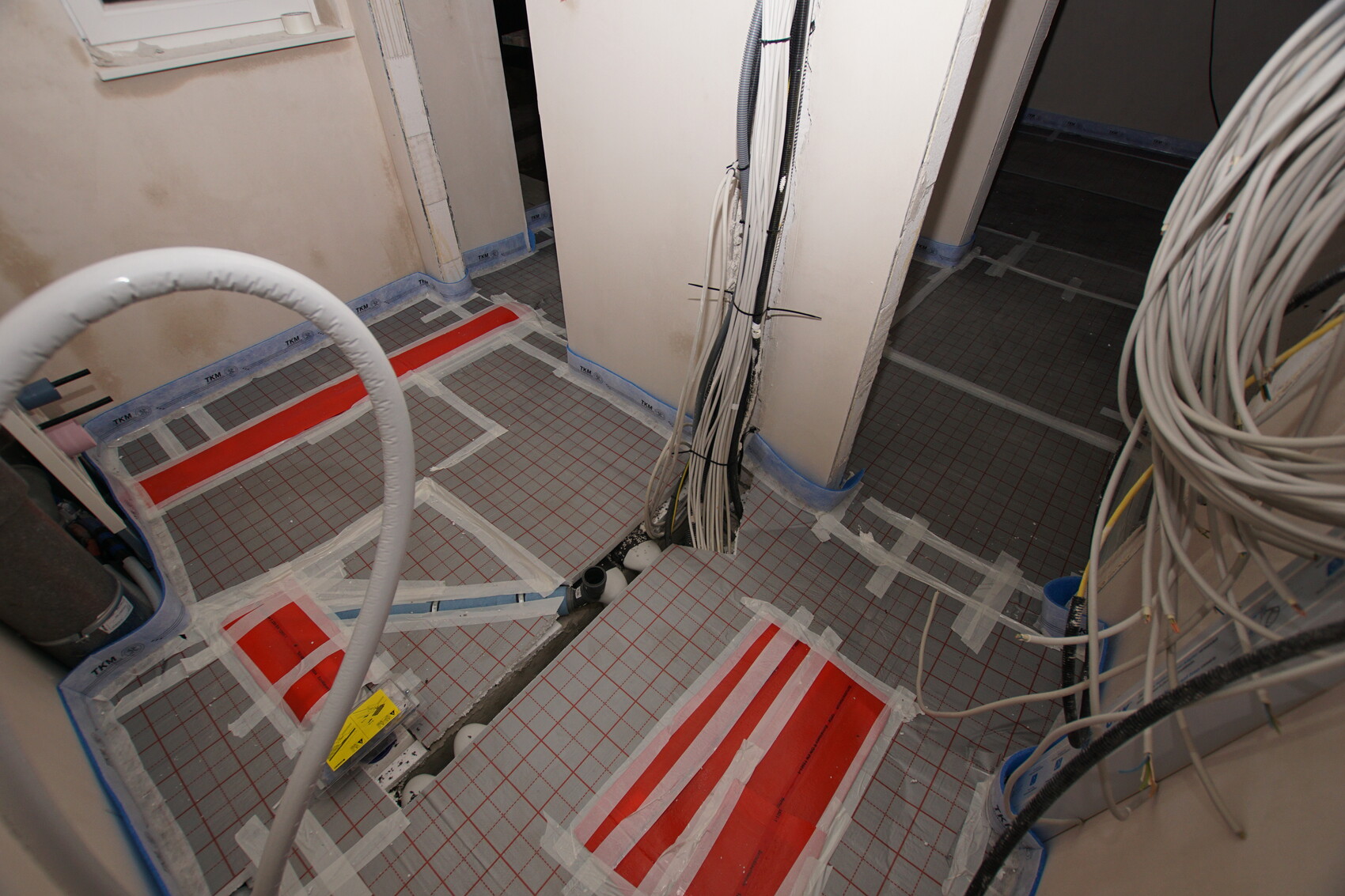

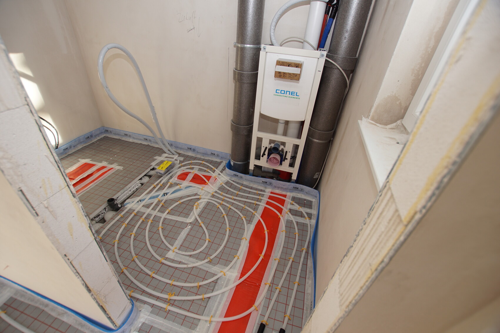

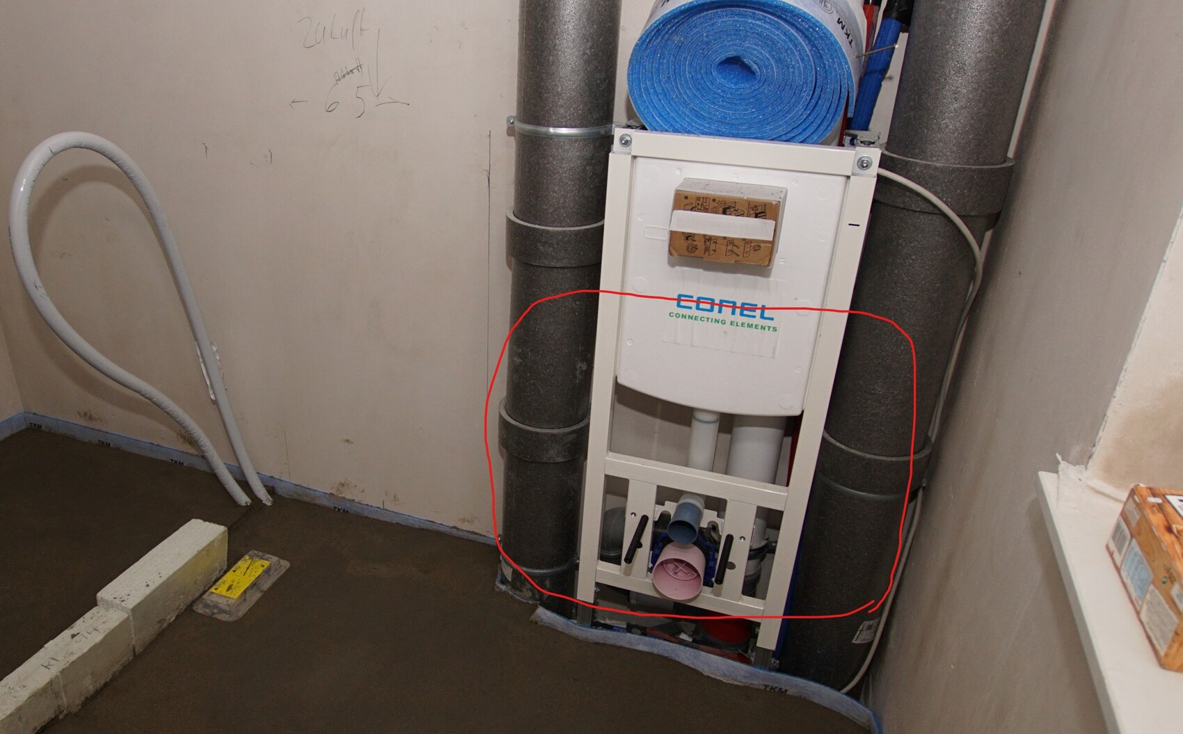

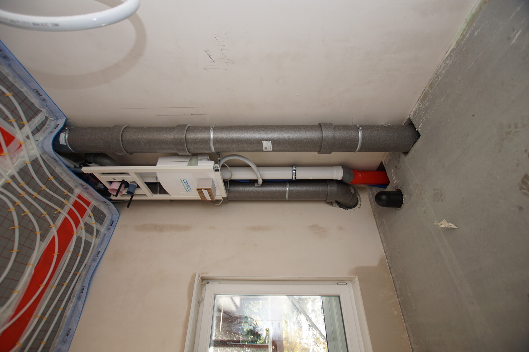

Attached are some pictures of the area that was opened and the faulty seal in a pipe joint that was replaced.
