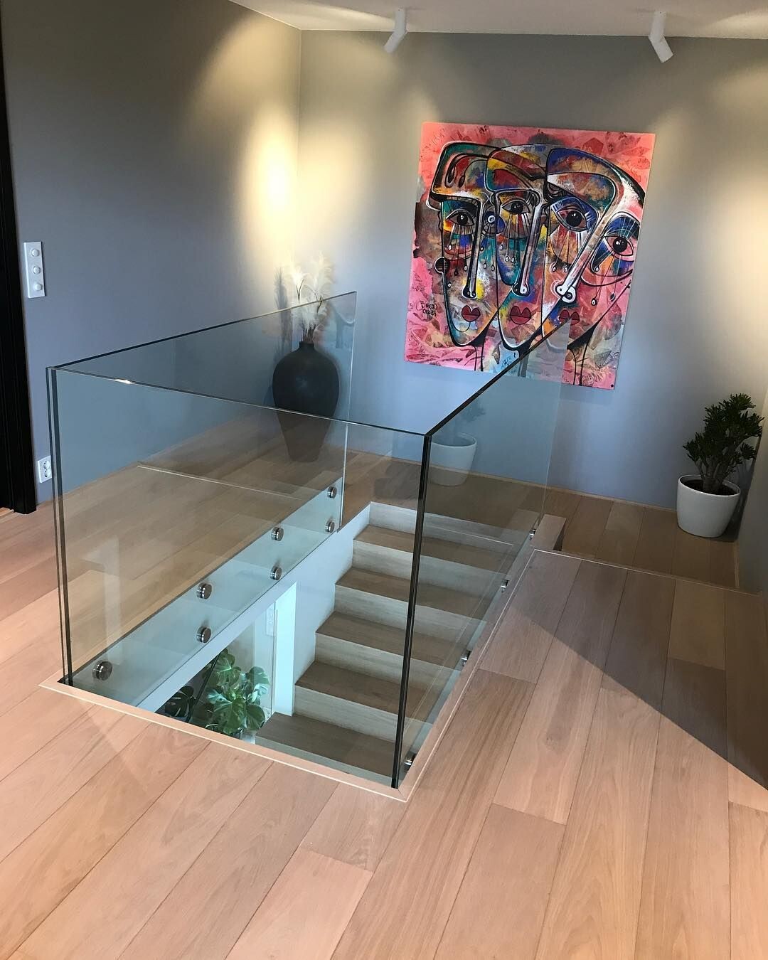

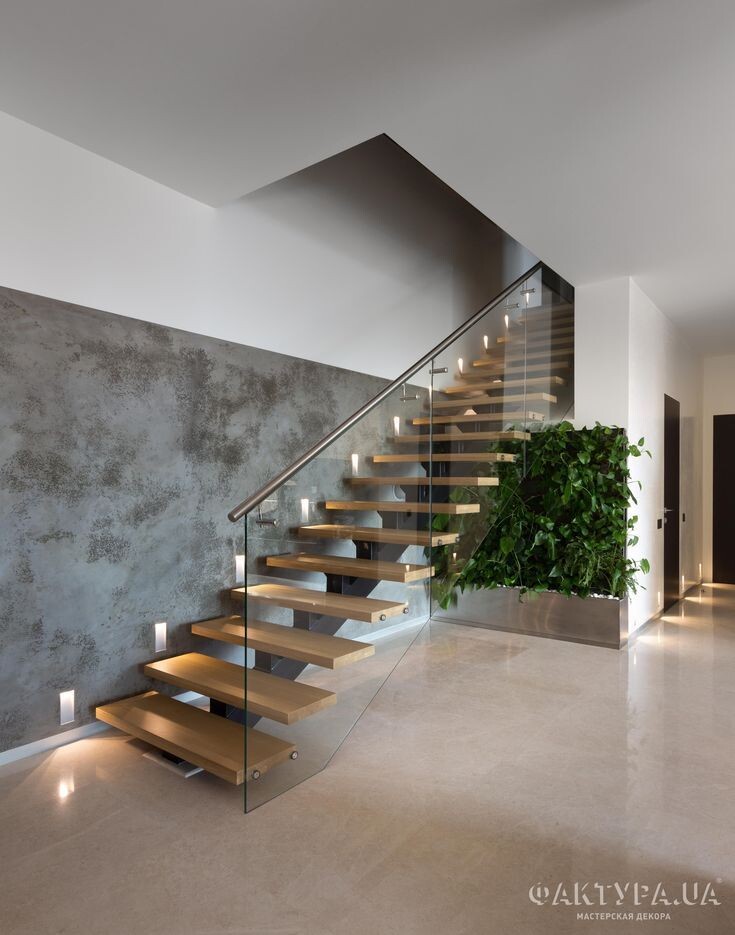

Here is the photo clearly showing that the staircase does not have open space along its entire length. I intended to indicate this with the railing on the upper floor in my original design.
The staircase in the left image actually starts about three steps before its ceiling opening. The staircase in the right image is, among other things, not the same. It is unclear to me where exactly in the middle of the staircase one is supposed to branch off into the shown room.
