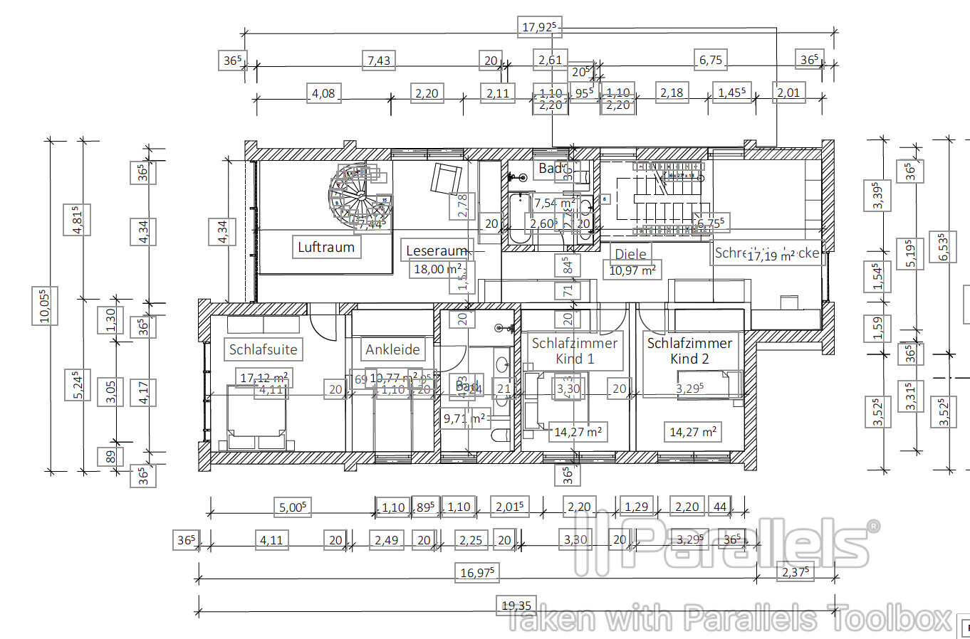

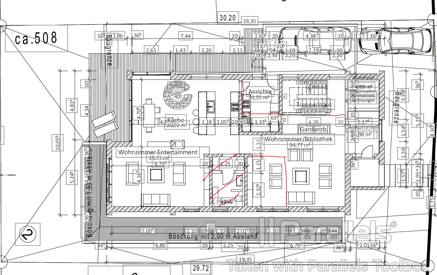

What improvements can be made to optimize the floor plan according to the above requirements? Living and dining area, additional room on the ground floor with the option to create a second later.
Are the room sizes adequate for their intended use?
What, in your opinion, is not well planned or has not yet been considered according to the wishes?

The architect says the garage will be narrow with only 3m (10 feet) width... What do you think? I can’t see which measurement you mean in your plan. Otherwise, I not only think that, but in real life, I manage perfectly well with an interior clear width of 2.90m (9.5 feet).

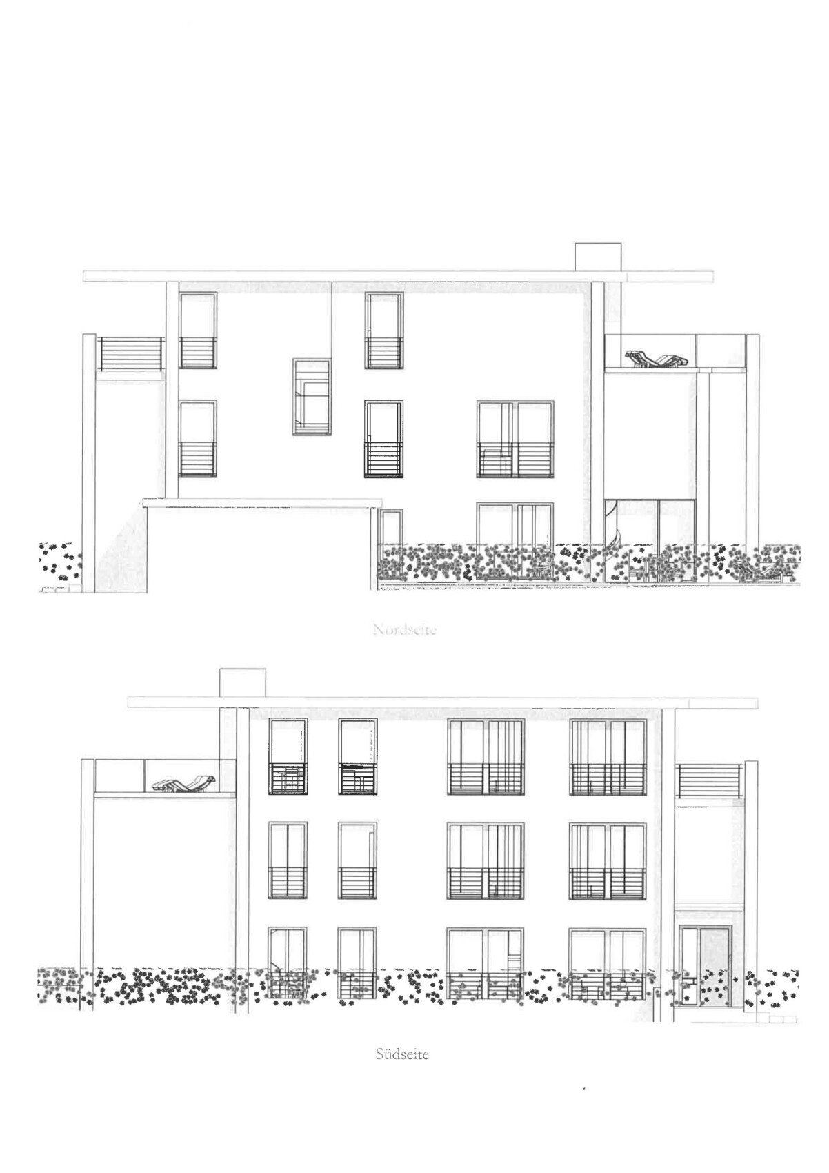

We have a plot width of 16.50m (54 feet) with a required minimum distance to the neighbor of 3 meters (10 feet) (Hessen). However, the architect based this on 3.60m (12 feet) each due to the height of 9.80m (32 feet) without needing to set back the setback storey. We would prefer to set the setback storey back to fully utilize the full width/area of the ground floor and first floor with a length/depth of about 17–18m (56–59 feet). Also, from the north and south sides, it looks too bulky and massive (see picture). Therefore, we want to set back the setback storey and accept the loss of area at the top accordingly. Also, to somehow open/break up the mentioned area by setting it back. What do the rest of the experienced members think? Ideas on how to design this optimally?
I can’t see which dimension you mean in your plan. Otherwise, not only do I think, but in practice, I get along just fine with 2.90m (9.5 feet) clear internal width in everyday use.Garage parking space on the north side. This is about the remaining total width (garage exterior dimension) of 3 meters (10 feet) if the setback storey is set back?

Garage parking space on the north side. Is this about the remaining total width (outer dimension of the garage) of 3 meters (10 feet) when the set-back floor is recessed? I’m still confused – why would the garage be affected by how far the set-back floor is recessed?
A 3-meter (10-foot) outer width is doable; a precast concrete garage typically has wall thickness of about 8 centimeters (3 inches); if the walls are thicker, it just gets tighter. A metal garage attached to the house doesn’t look good.
