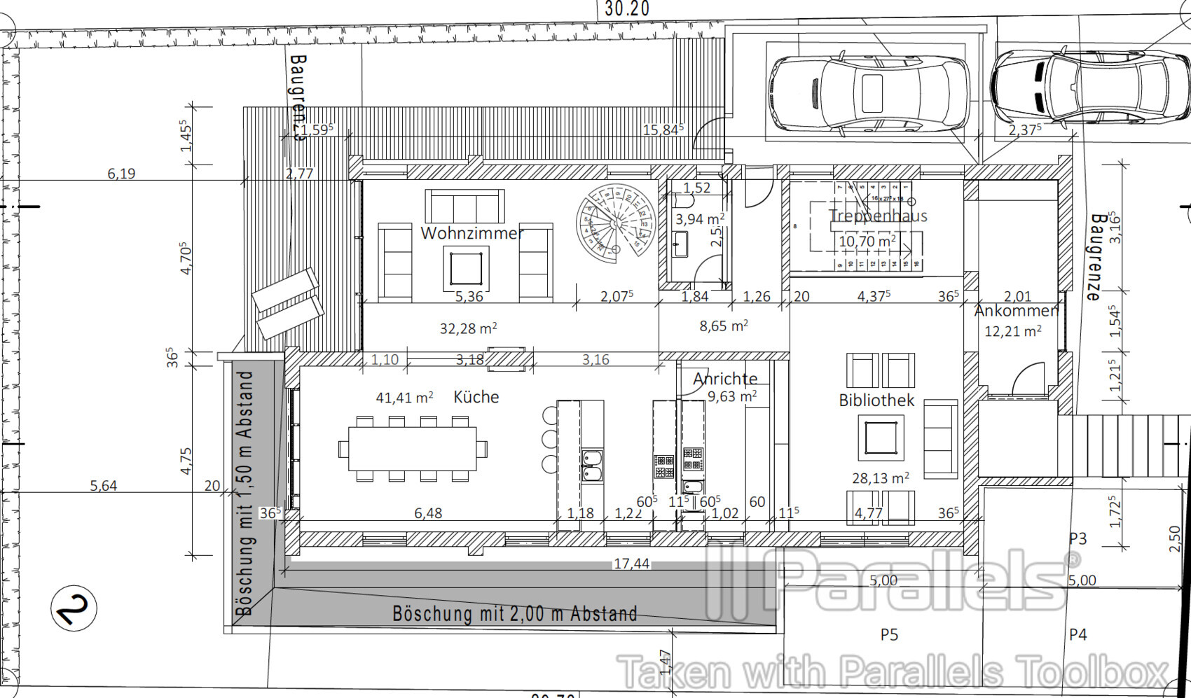

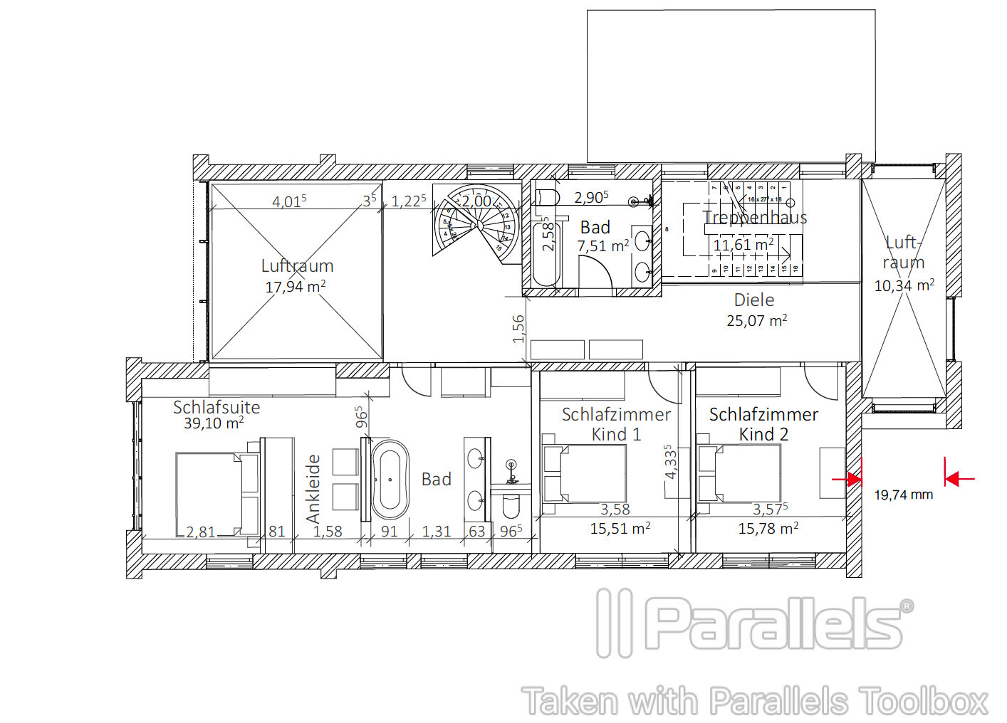

Boby_Richy23 Dec 2020 22:11Ysop*** schrieb:
I was rather referring to enlarging the bathrooms. They seem really small in comparison.
True. Today, we revised the design significantly. The bathroom located in the middle on the upper floor is a kids’ bathroom.
hampshire schrieb:
I'm always surprised by how small living room furniture is when people want to sit with their backs to the windows. Here it happens twice. The spaciousness of the living area is in a strange contrast to the rather tight dining area. Also, the bathrooms are very compact relative to the size of the house. I like the idea of a second staircase. However, the location of the spiral staircase results in a cramped dining area and a dead corner on the ground floor. Overall, not very elegant. It wouldn’t be my choice – although I can appreciate unconventional layouts.
Lack of efficient use of space isn’t a problem if the building budget allows for generosity. But when this inefficiency doesn’t translate into spacious living or aesthetic benefits, it’s a shame.
We also revamped that part, see pictures.
The design lacks the “spark” you’d expect in a house with a similar budget. “Different” and “good” is valuable. Simply “different” just wastes money.
Looking forward to criticism and nice ideas/suggestions.
Is there no wall between the dressing room and the hallway? I can’t quite tell. No, check the new design. The master bedroom arrangement has been revised there.

hampshire23 Dec 2020 22:32Boby_Richy schrieb:
No, just look at the new design. The master bedroom layout has been revised there.I see many bathrooms, none of which are spacious. That’s what I mean by tight (sorry for the typos above).B
Boby_Richy23 Dec 2020 22:33Now on the ground floor: we mirrored the living room, slightly enlarged it, reduced the size of the library/room, and accordingly expanded the kitchen and dining area.
We're unsure about the staircase.
The slope of 2 m (6.6 ft) seems quite large to me; what do you think?
On the upper floor: the master bedroom has been adjusted, the bathroom enlarged, but unfortunately the kids’ bathroom remains unchanged. We are considering moving a bedroom to the north side; so far, all rooms have been kept on the southeast side.

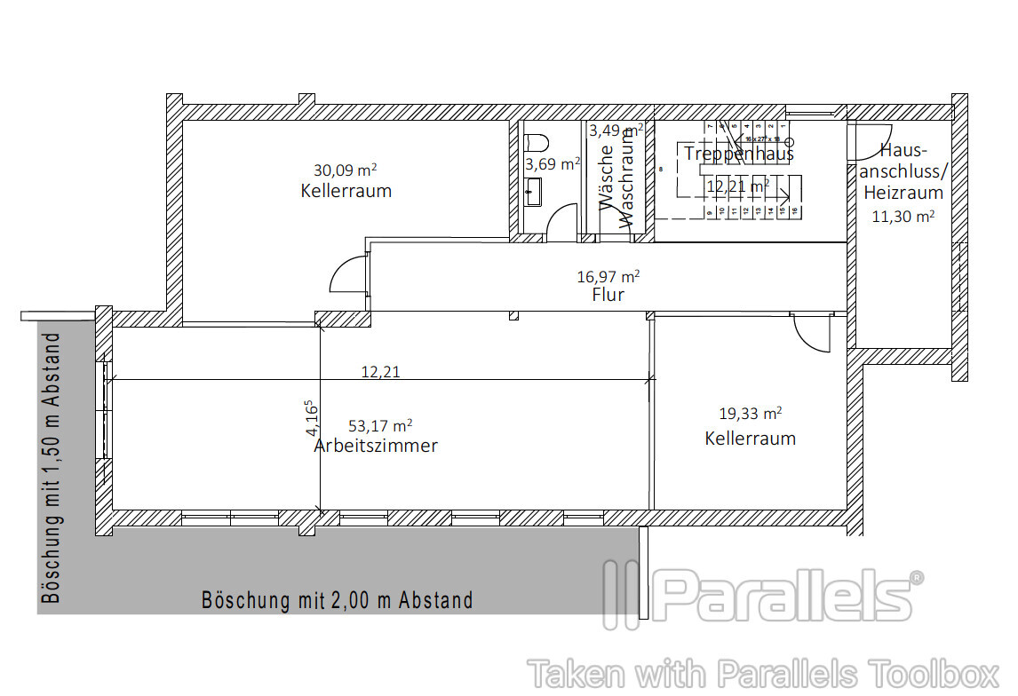

In the basement: I know how optimization could be done here.
In the cellar: we don’t find the layout optimal or flexible enough. A shower is missing, and the allocation of two workrooms. What about the lighting conditions?

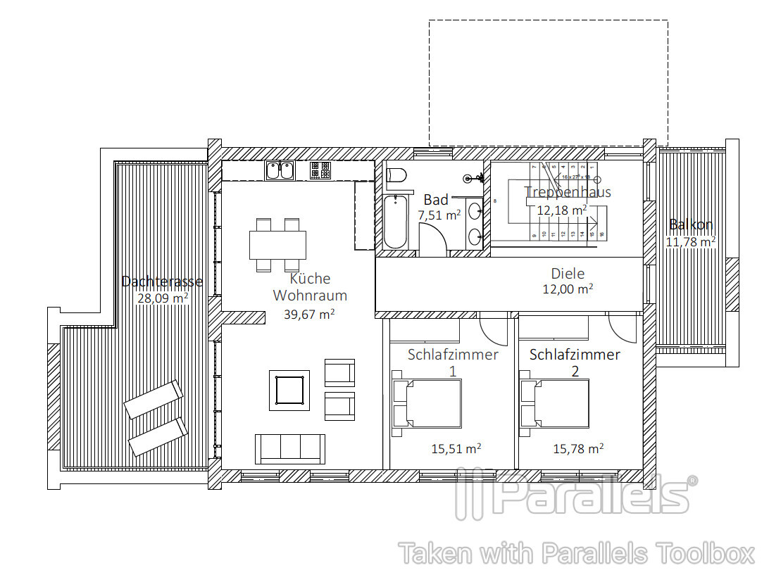

hampshire23 Dec 2020 22:45Swapping the kitchen and living area is worthwhile for sociable people. I like it better that way. I also much prefer reorganizing the sleeping area upstairs into an open layout, except for the narrow passage to the left side of the bed and into the bathroom. However, that’s not a real problem as long as you stay slim and healthy.
If the attic apartment is intended for older people, plan for the possibility of adding an elevator later.
Just a thought: buy a neighboring plot of land when possible—otherwise, the garden feels a bit tight.
