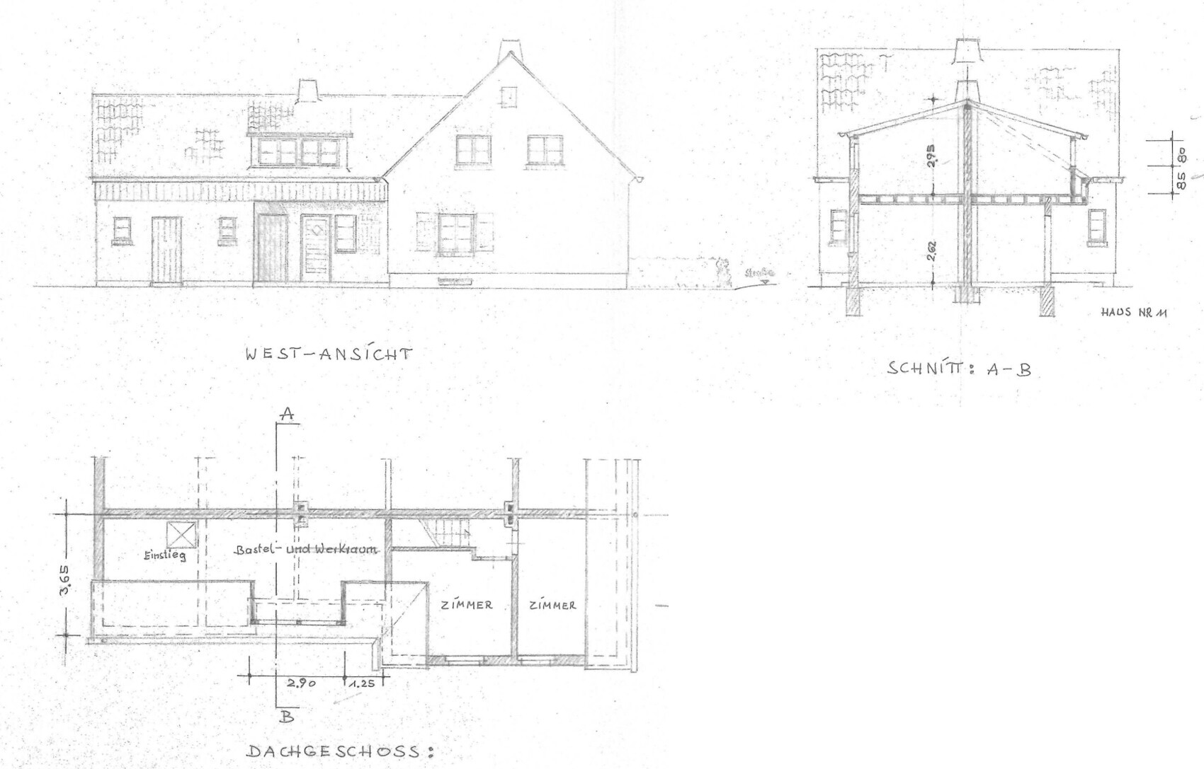

I have received some documents related to real estate and will upload them during the day. As I already mentioned in my email, it’s best if you show the plot of land and the existing house.

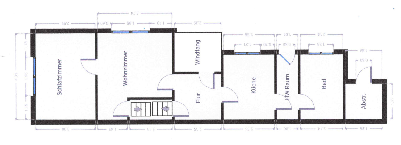

ZonnyNg schrieb:
This is everything I received from the real estate.Ah, now I understand... were you in France before? – the profession is called "real estate agent" in German. ZonnyNg schrieb:

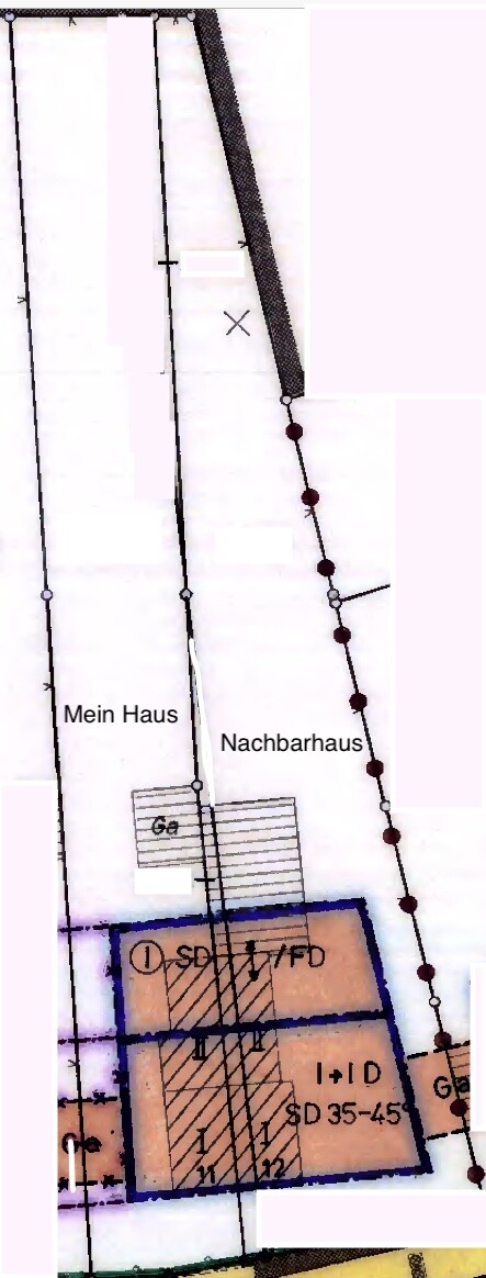

On the development plan, the building zone is marked in orange.Interesting. So it’s not a continuous gable across the full depth, as I initially thought.https://www.instagram.com/11antgmxde/
ZonnyNg schrieb:
According to the development plan, we are allowed to build 17 x 7.5 m (56 x 25 feet).Are you sure you are allowed that size? The building envelope shows the area on the plot where you can build, but it looks like the floor area ratio restricts building too much, or there may be another limitation regarding the width of the house. The houses are not that narrow for no reason.

Are you sure the size is allowed?
The building envelope shows the area you can build on the plot, but it looks like a floor area ratio limits building too much, or another restriction limits the width of the house. That’s why the houses are so narrow. I have talked to a building consultant. Yes, a 3m (10 feet) distance to the neighboring boundary must be kept, and the width is almost 7.5m (25 feet). To the rear, it’s like in the building envelope, about 17m (56 feet) deep. The representatives from two construction companies said the same. But yes, it is still not 100% sure. I am also happy with 7 x 14m (23 x 46 feet), as long as it is doable and with a basement.
