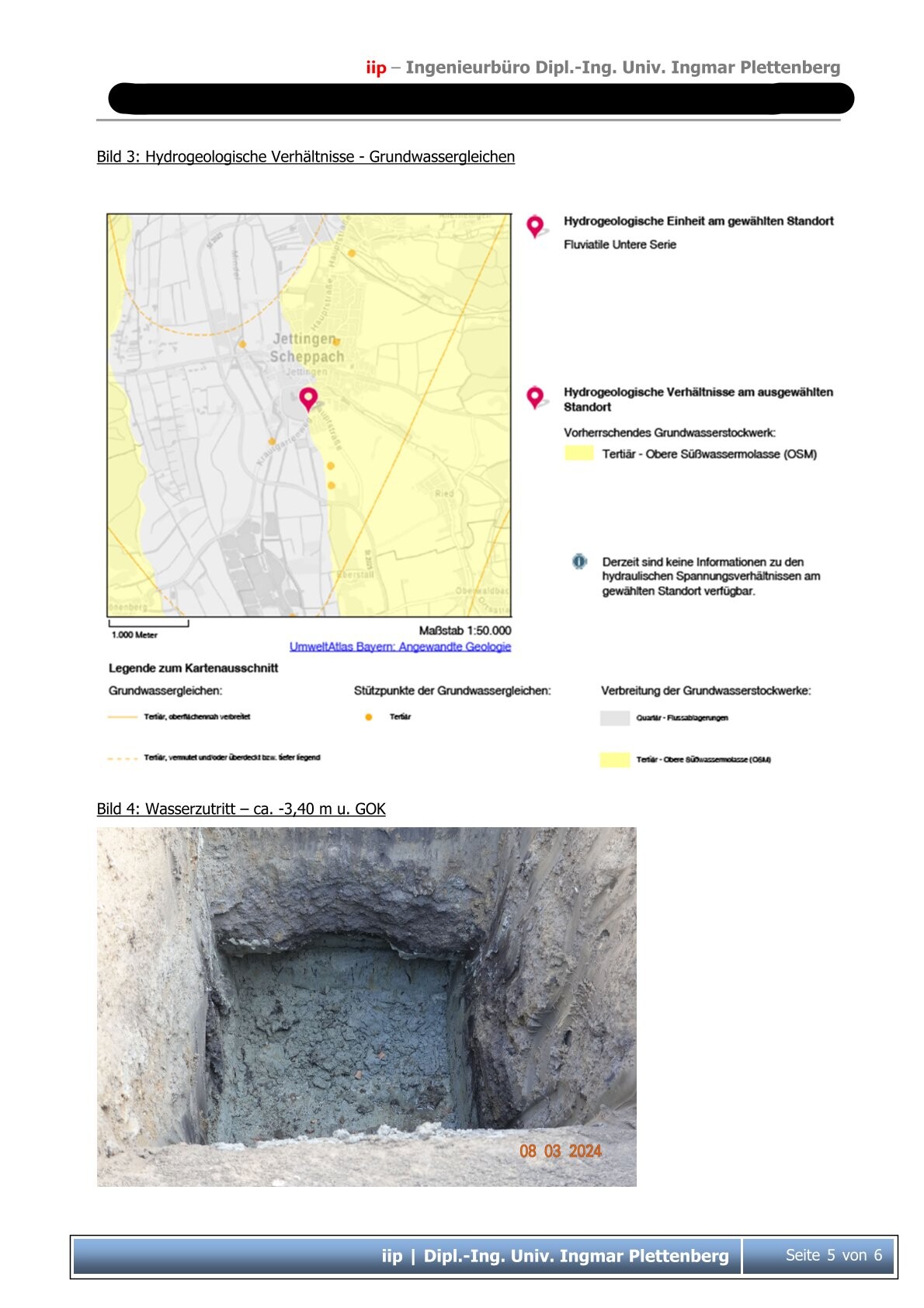

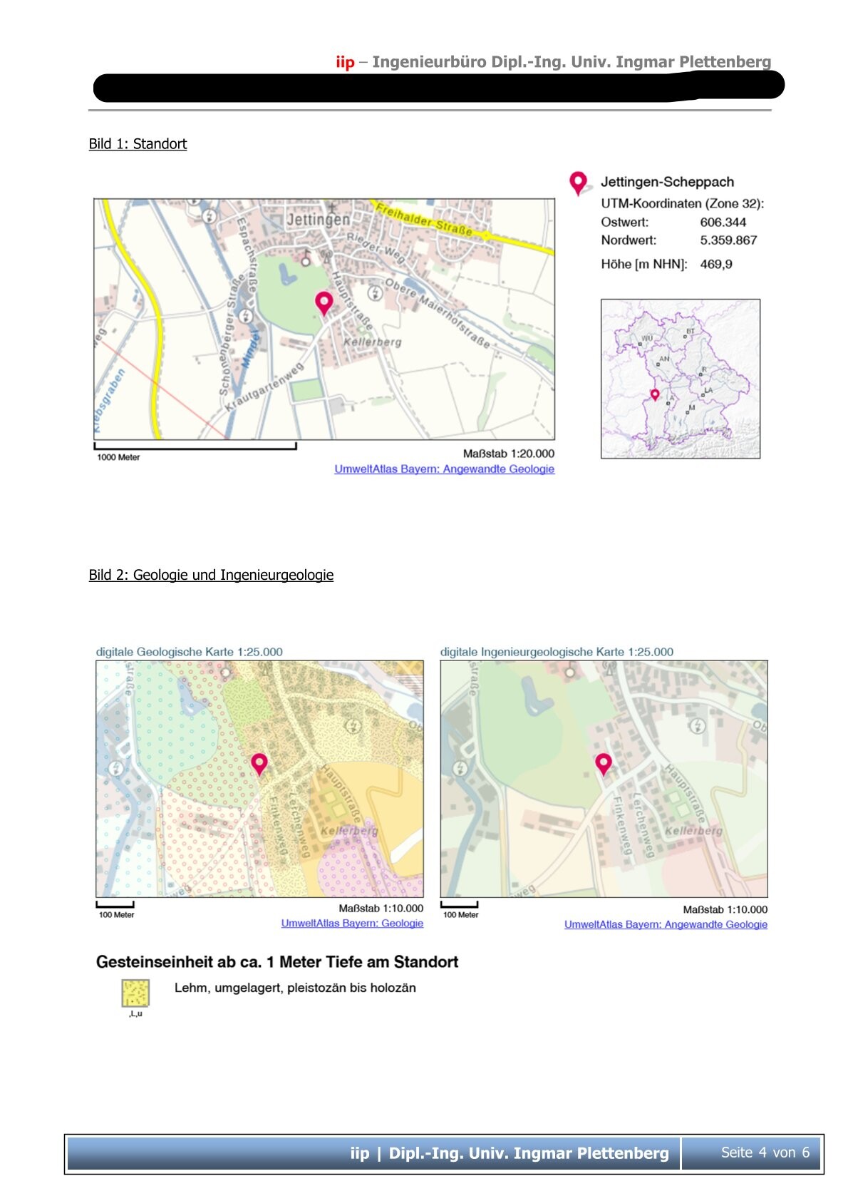

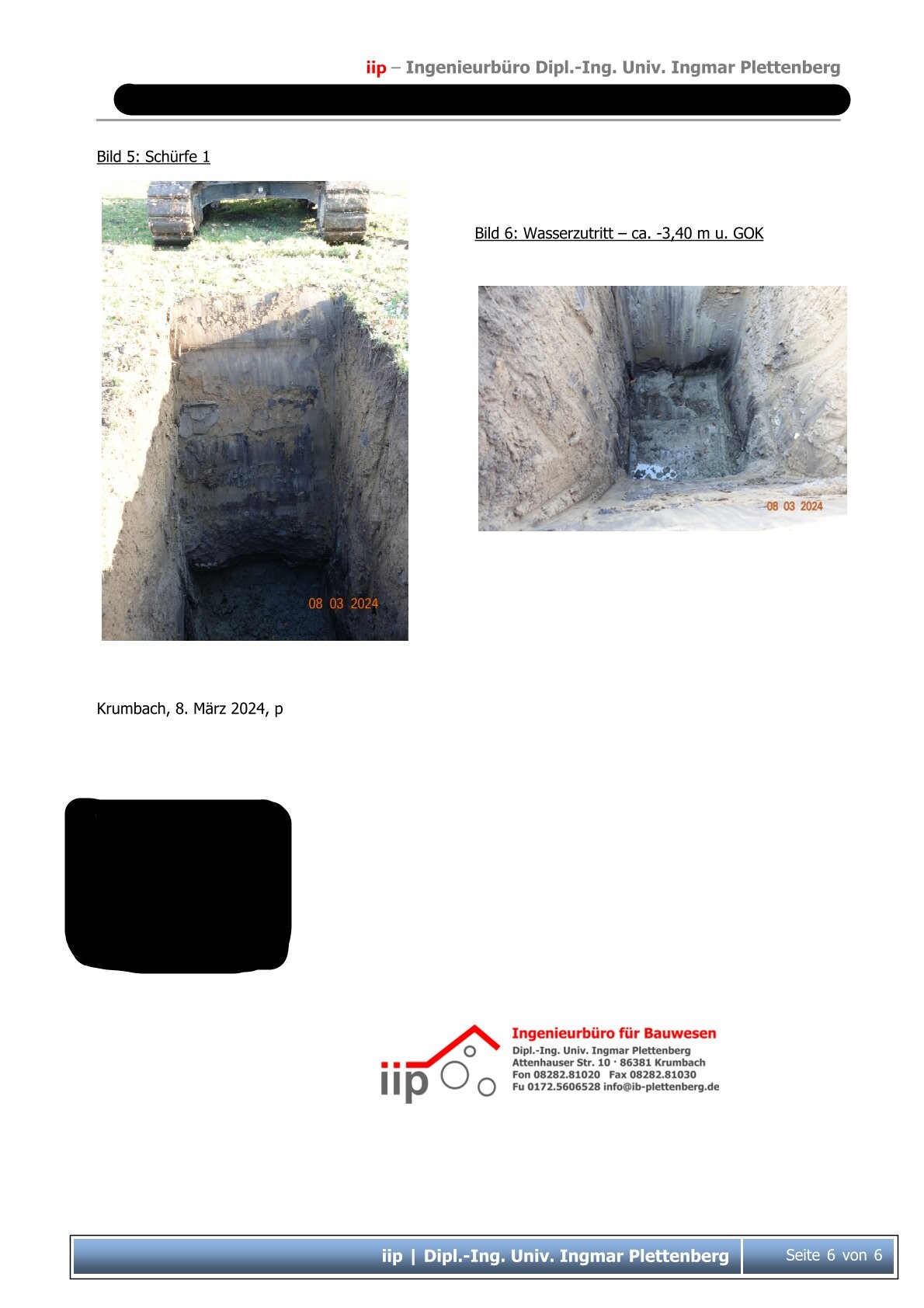

there are some new updates. We have received a geotechnical report for the plot of land.
The report is attached. The names of private individuals, who apparently commissioned the report, have been redacted.
What confuses me is the title: "preliminary initial assessment."
Overall, the report looks okay to me, meaning less severe than expected.
However, it does point out that the bearing capacity is assessed as low to very low – what does that mean?
There are also many conditional terms like "should," "must," etc. For example: if heavily clayey soils with peat components or silt lenses occur in the foundation base area, the soil must be completely removed.
Even with the report, there still seem to be significant uncertainties regarding soil replacement...
What do you think?
