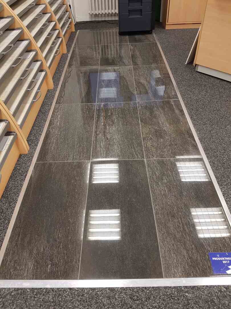

To me that seems rather sterile and not very cozy. Same thought for the restroom. I must say, I find the arrangement perfectly adequate as general lighting.Does that also apply in combination with our anthracite-colored tiles on the ground floor? Or would more lighting be needed because they absorb a lot of light?

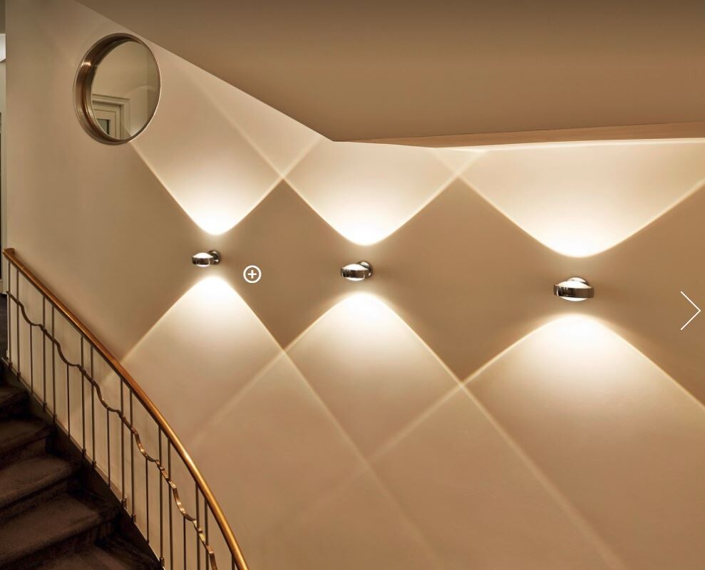

What do you think about these wall lights instead of recessed step lights in the stairwell between ground and upper floor?
