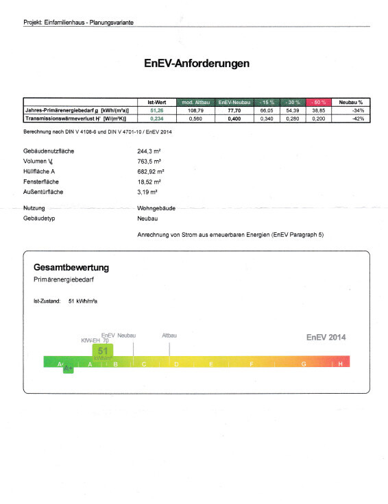

This week, the energy consultant came and presented the calculation for the planned KfW 70 house.
I will upload the documents from the energy consultant later or add them to this thread.
One of my first questions was how to improve from KfW 70 to KfW 55 and what the cost implications would be.
Now I would like to hear your opinions on the documents and then ask my questions.

Here are the relevant attachments!!!
Document page on EnEV requirements with table and color scale for overall primary energy demand rating.
Jochen10410 Sep 2015 12:15
stiff80 schrieb:
These are my questions:
-Are the additional costs for a Bisotherm block with integrated insulation worthwhile, or just wasted money?
-Should I rather reinforce the insulation in other places, such as below and above the foundation slab, or the ceiling?
why don’t you simply ask your energy consultant? That’s why they are called energy consultants and not just energy calculators.
The concept has to be consistent as a whole. To put that together, there are exactly these consultants. I find it very difficult to resolve this in the forum. Besides, the mentioned consultant gets paid for the advice.
The cost-effectiveness of KfW55 has already been discussed here several times.
