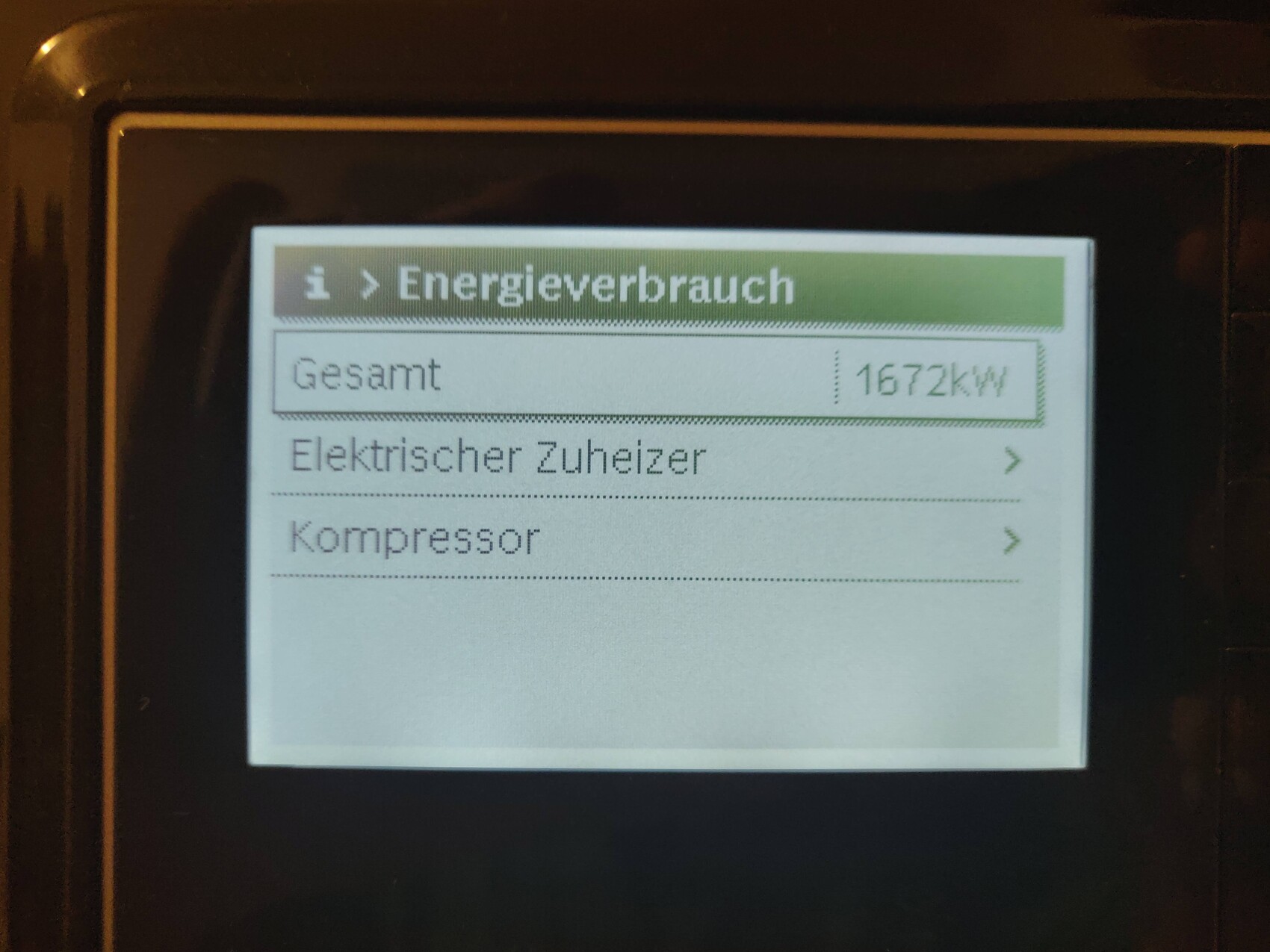

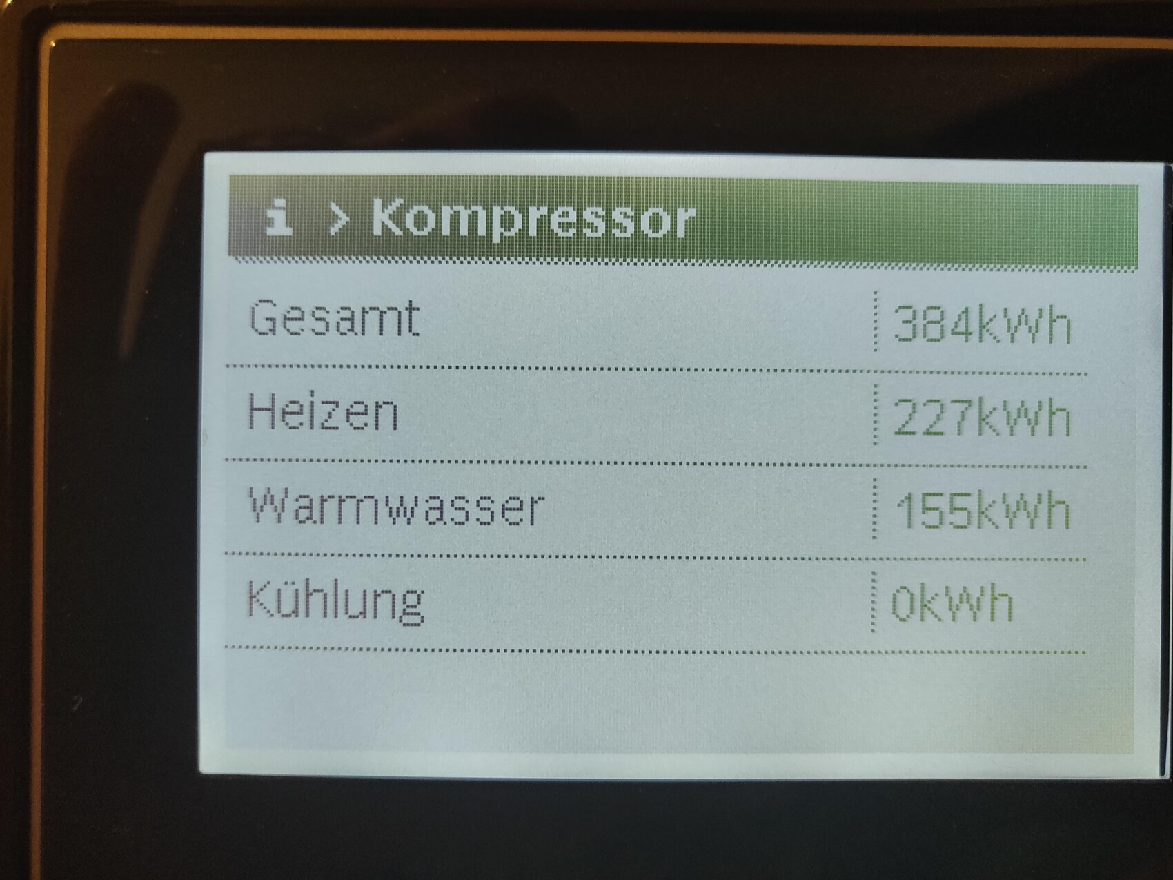

We built a solid single-family house with a heat pump. We moved in on September 1 of this year. I am quite concerned about our heat pump, as it has consumed 1500 kWh in just two months. Today the consumption has increased by nearly another 200 kWh. September and October were unusually mild, with only two days experiencing frost on the ground. Both the heating technician and the construction company consider this usage reasonable, so I have not discussed it with them again.

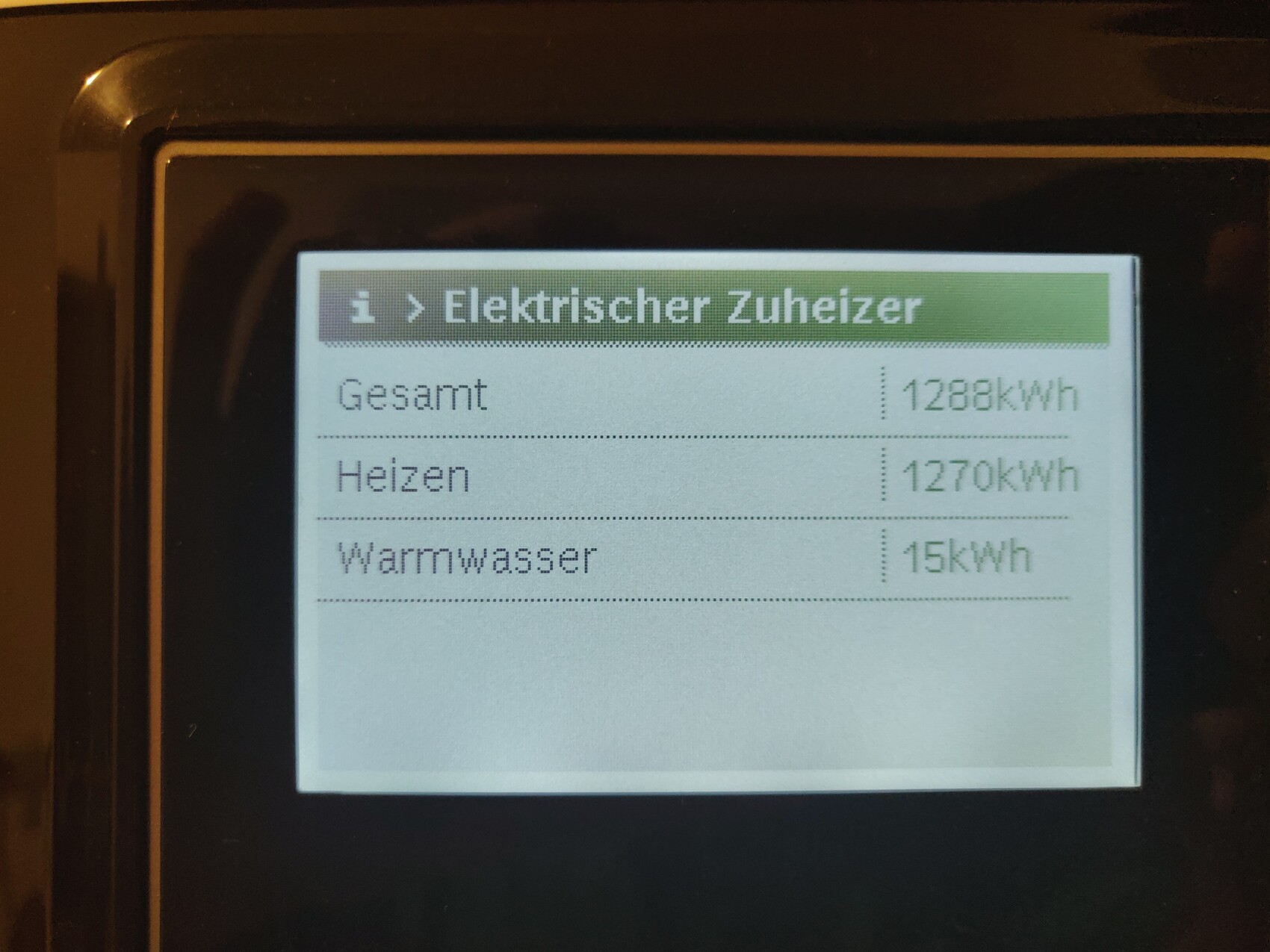

I researched how these heat pumps operate and took a closer look at the energy consumption of my unit (see photo). I found that the highest consumption is attributed to the electric auxiliary heater—1288 kWh.
What do you think about this? Could there be something wrong with the settings? Is the compressor not working efficiently? Shouldn’t the auxiliary heater only activate at significantly lower temperatures?
