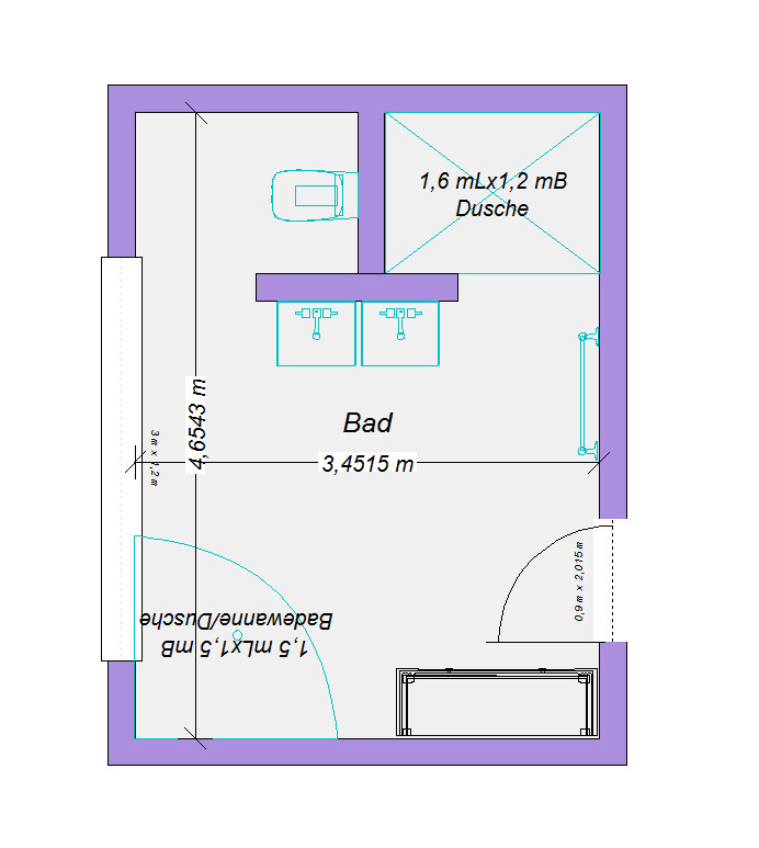

We are planning to build a semi-detached house next year.
Currently, we are considering how to design the bathroom from the ground up.
In the pictures, you can see our first sketches made on graph paper in millimeters.
The bathroom has an area of about 16 sqm (172 sq ft).
For the wall drawn above the toilet, we were thinking of a height of 0.9 m (35 inches), similar to the window sill height.
I would really appreciate any feedback or alternative suggestions.
Thank you very much.
Christian
Christian

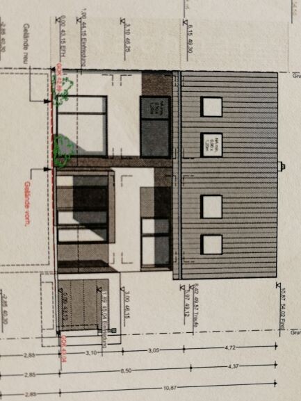

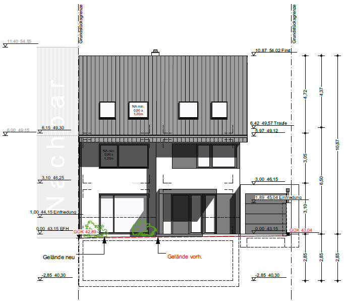

Just as a basic idea, if the window at the end feels too "open" or visible, you can also use frosted film to significantly reduce visibility without greatly reducing the amount of light coming in.
Since the right side is not symmetrical either, how is the visibility from below? With the window there, people might be able to see inside completely!?
Hi!
I also think the frosted glass film is a great idea. It allows you to "raise" the parapet height without losing natural light.
I’ve re-uploaded the photo of the facade. Hopefully, it’s a bit clearer now.
On the right side, the front door is basically aligned with the left edge of the first-floor window frame. The right edge of the ground-floor frame is aligned with the end of the first-floor window above. It doesn’t have to be 100% symmetrical anyway, which is understandable since there are different elements and rooms involved (front door, corner room, etc.).
I would also really appreciate any suggestions or ideas for the layout inside the bathroom.
Christian
Christian
In my opinion, the T-shape makes the room unnecessarily small, but of course, that’s a matter of personal preference. My suggestion for the layout would be:
- Shower like kaho’s design, with the exit facing the window/exterior wall. With 1.60 m (5 feet 3 inches), a simple glass panel on the side is enough, and the front of the shower can remain open.
- Radiator on the right wall next to the shower exit; keep in mind that towel warmers don’t provide very high heat output.
- Toilet in the corner along the exterior walls, either next to the window or next to the radiator.
- Bathtub in the opposite corner, basically under the window and along that wall.
- Sink on the left side of the door, and cabinets can be placed in the corner on the right (essentially behind the door).
