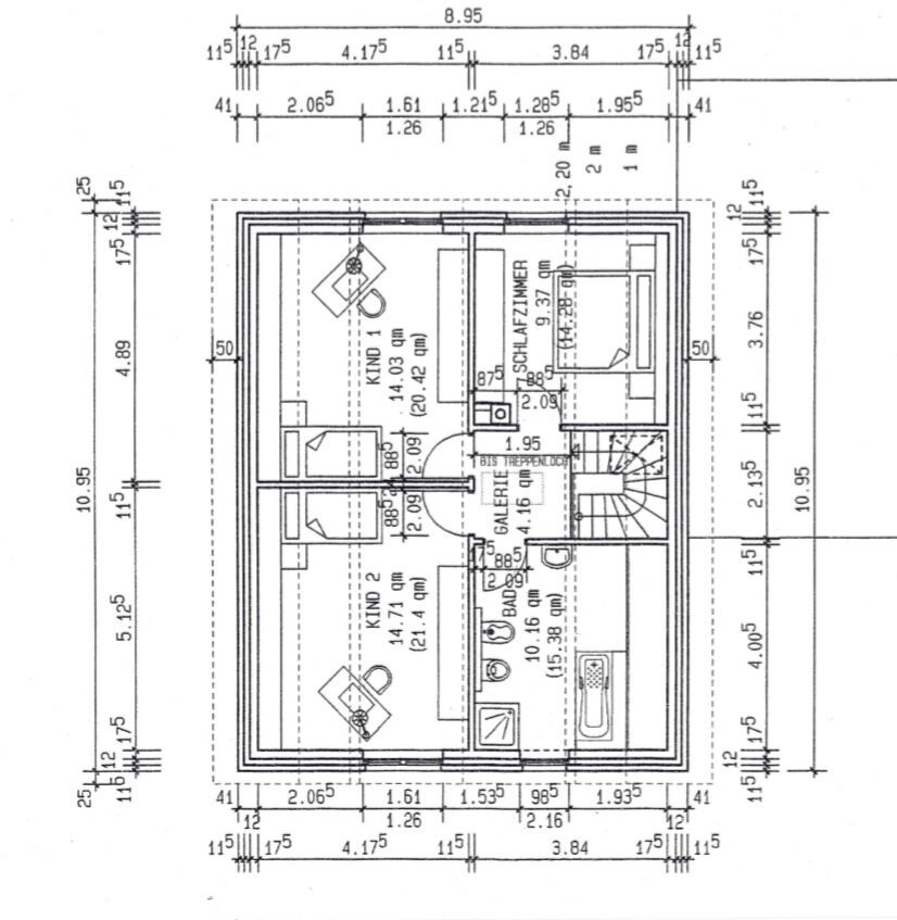

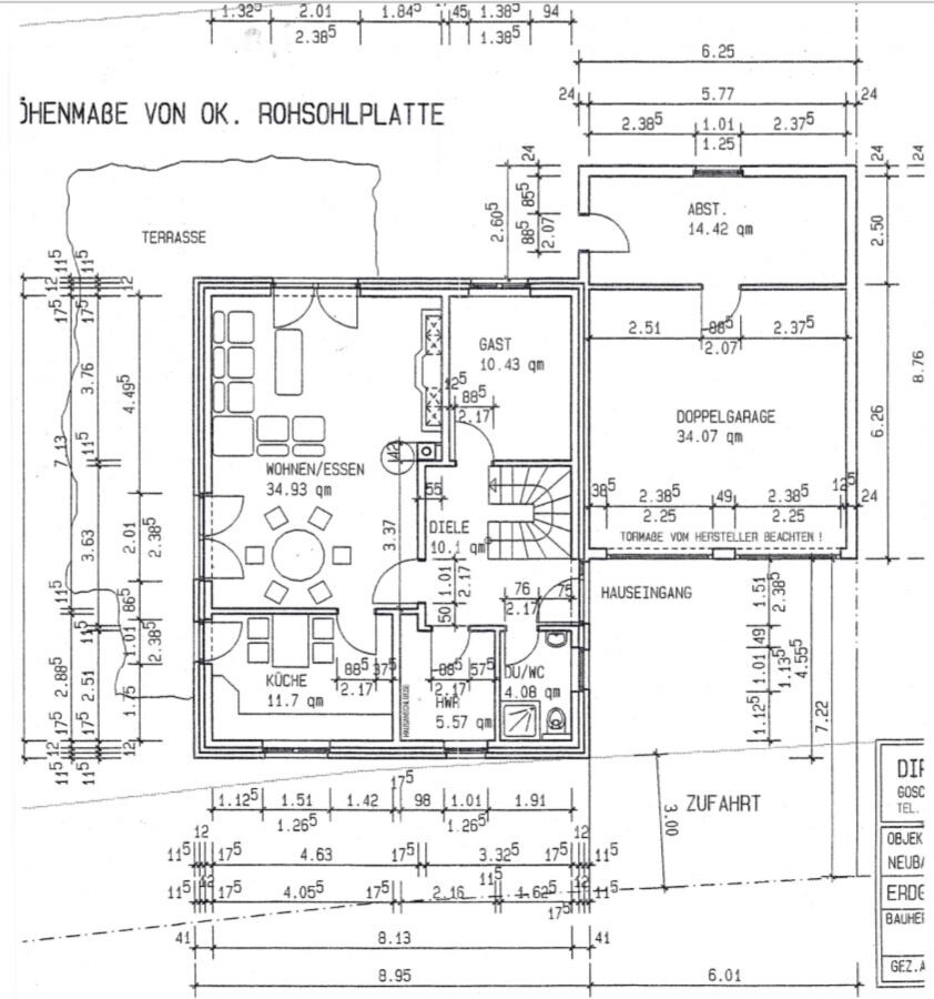

Hendrik M2 Oct 2018 21:43Hello,
unfortunately, I wasn’t able to link these pictures in the post. So here they are instead.
I would appreciate it if you could share your ideas with me. You already convinced me quite well about the conservatory and its usefulness—or the lack thereof—so now I’m open again to any solutions that provide 2 children’s bedrooms and more living space on the ground floor, as well as a larger kitchen (that was one of the reasons for the conservatory).
Hendrik M
Hendrik M

Most likely, you won’t need to separate triplets during the first few years. However, I only know this from some twins: they must not be separated and have a strong bond.
So, I would say you have a 5-year buffer. Maybe you can use this time to observe whether the triplets need each other or not.
If in the end four children’s bedrooms are needed, one option would be to reduce the size of the two existing children’s rooms and create access to a third gable in between, where a new room can be added. Below this, a bay window would be created in the dining area. Of course, the third gable can be made larger or wider, resulting in an L-shaped house.
For the extension or addition, I would use white wooden cladding.
Another possibility is to use the office downstairs as a laundry room/dressing room/storage, from where you can access an extension that would contain the parents’ area.
I do not see a possibility for building over the garage due to setback requirements.
