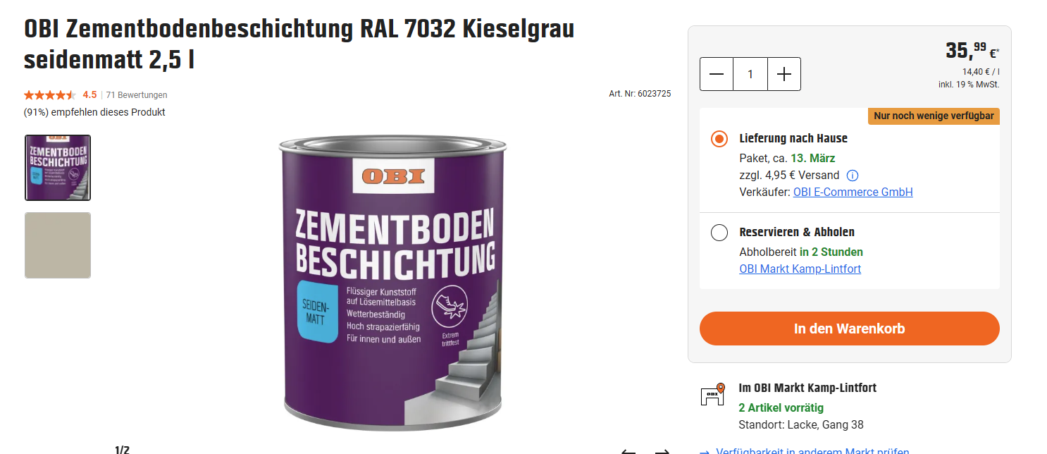

nordanney10 Mar 2026 16:20waldwiese9 schrieb:
Can anyone ... recommend products Tiles for 3-5€ per square meter (0.3-0.5 per square foot) from a hardware store.
Otherwise, something like this
However, any coating will be about as expensive as tiles and will generally perform worse, especially if you have heavy use. The example shown is actually not suitable for workshops or similar spaces, but it is cheap. I also can’t tell you if the floor requires any pretreatment. A high-quality coating will definitely exceed your budget.
waldwiese910 Mar 2026 21:02Thank you for your reply, Nordanney.
I find your suggestion quite affordable.
According to the specifications, the large container (2.5L (2.6 quarts)) covers 26 m² (280 sq ft) at a price of 36€.
You probably won’t find anything cheaper.
The potential issue I see is that this plastic paint is not vapor-permeable at all.
The craftsmen who installed the cement screed recommended that we use a vapor-permeable product.
nordanney10 Mar 2026 22:04waldwiese9 schrieb:
The potential issue I see here is, YGWYPF. So a cheap solution that isn’t really intended for your purpose. It might work, but I wouldn’t use it in a workshop. I expect the coating to get scratched or worn off quickly. As mentioned, it’s really only suitable for rooms with light use (just walking over it occasionally).
Trial and error. Sticking tiles over it should always work.
waldwiese911 Mar 2026 10:36YGWYPF. So it's a cheap solution that isn't really intended for your purpose You are absolutely right.
The desire for a one-size-fits-all solution at a very low cost (cheaper and less effort than a tiled floor) might not be realistic.
Unfortunately, due to circumstances and reasons I don’t want to go into, the cost of a tiled floor isn’t feasible, and a cheaper solution is necessary.
What matters most to us is that the floor is treated in some way to prevent the cement from wearing down extensively from foot traffic.
Whether the floor gets stains from liquids or has some larger scratches, dents, or small chips here and there is less of a concern for us.
The floor does not need to look nice.
The room is not small either, with an area of about 50 m² (540 sq ft) — I forgot to mention the size in my first post. Well.
