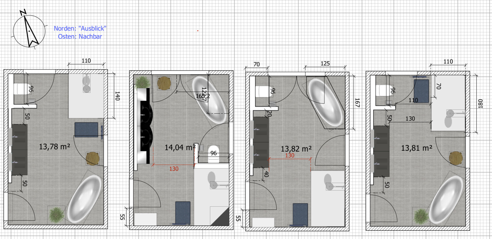

The room size is 3 m x 4.75 m = 14.25 m² (32 ft x 15.6 ft = 153 ft²).
At the moment, the main focus is on the placement of the door and window, as well as the window sizes. A bathroom layout will follow later, but unfortunately, we need to finalize the floor plan with windows and doors beforehand. For this, we have to know as precisely as possible how the bathroom will be best divided. (A chicken-and-egg problem.) We need your support to determine which option makes the most sense or any additional suggestions and tips we should consider to plan the doors and windows effectively.

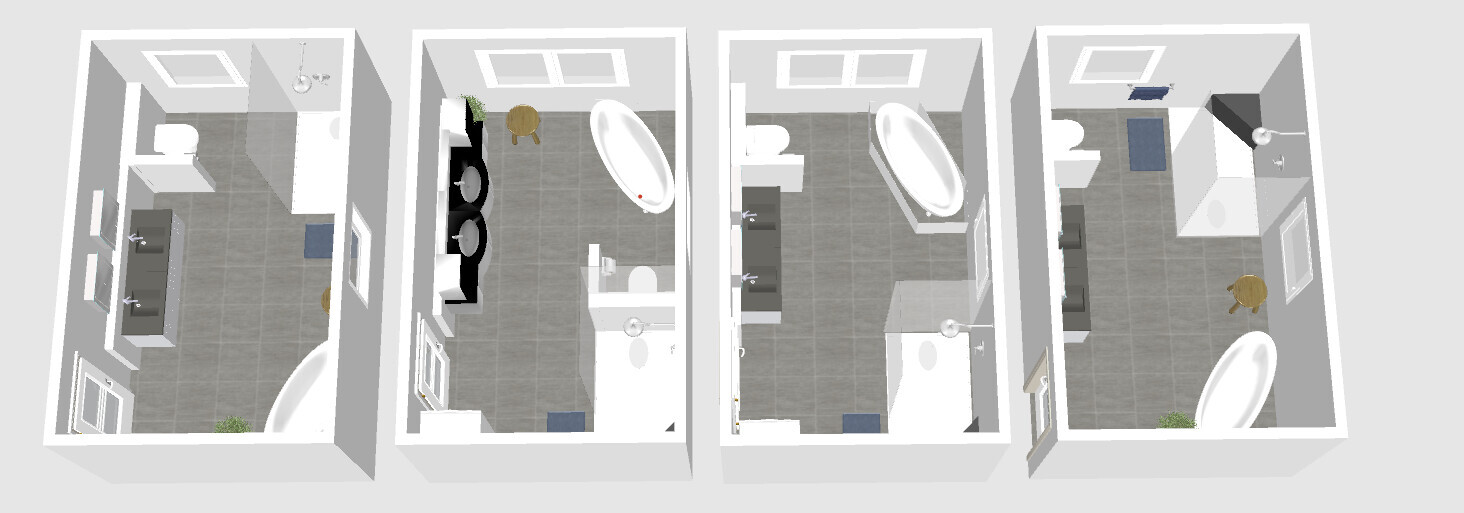

Below are four options that we currently find most sensible due to the openness of the room and the available movement space. The door can only be moved as much as shown in the attached sketches.
The two of us adults mostly use the shower, so the focus is on a nice, large shower rather than a bathtub. However, we still need a bathtub for the kids for some time. (Household of 5 people; an additional guest toilet and a small extra bathroom are planned.)
We have often heard about zones in the bathroom—perhaps someone could also explain what exactly is meant by zones and how this could be implemented in a 14 m² (150 ft²) room.
To the north, we have a beautiful view, so it would be a nice-to-have to place a larger window facing north.
We look forward to your input and new ideas!

Bertram10020 Jul 2024 11:44I would recess the door and, if possible, have it open outwards.
Instead of a large east-facing window facing the neighbors, could you install a roof window? A roof window in the bathroom is great. On the east side, then only a small window for ventilation.
Apparently, you like "freestanding" bathtubs. I definitely would not plan for that. It only creates awkward corners for cleaning behind it. Even a 14 m² (150 sq ft) bathroom is too small to make a freestanding tub really impressive. You’d need a luxury mansion for such a tub to really stand out. A large shower is always a good idea; it can be designed without doors, so there’s no need for maintenance.
“Zoning” is just a modern term to describe sensible planning: avoiding walking across the whole bathroom with wet feet to get to the toilet, dividing the bathroom into “zones” so multiple people can use it at the same time.
14 m² (150 sq ft) is actually not small for a bathroom. You can fit everything you want plus some free movement space. That won’t be a problem.

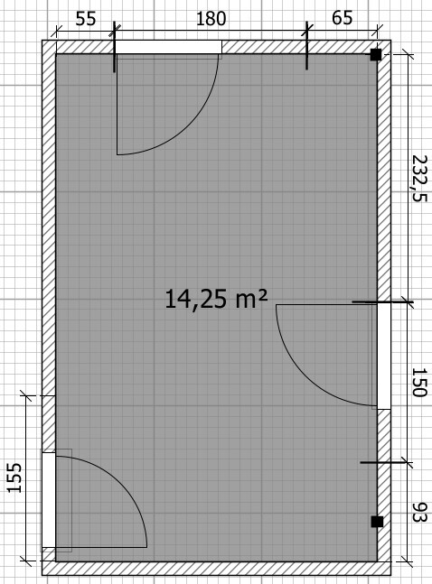

Alex1234520 Jul 2024 20:17Hello everyone,
Thank you for the feedback.
Recessing the door is rather inconvenient for the rest of the floor plan. Opening the door outwards is possible.
Is recessing meant to gain more space inside the room?
The door can be moved within an area of 155cm (61 inches) at the bottom left (see sketch below).
This is due to the modeling in the design software. We definitely do not want a freestanding tub. The idea was rather to extend the wall behind the tub to create storage space. So more of a "built-in slanted bathtub."
We are building on a hillside. From the window, at most a neighbor from a downward angle can see inside.
The first version on the far left is what we have planned so far. The architect agrees that it works well. More detailed planning will be done in the bathroom design phase. After that, we can only shift the windows slightly.
The window sizes now need to be defined, among other things, to calculate the structural requirements.
That is being done as well. Below is an image showing the alignments with the lower windows. This will be considered as much as possible.
The wastewater pipes will be routed downward at the two eastern "corners" (black squares). (See upper sketch)
Thanks for the suggestion, we might consider it.
The main goal of this discussion: Is any of the above-mentioned options or another good enough to install a larger window on the north side (180cm (71 inches) instead of 100cm (39 inches) wide)?
Advantages would be a better view, although I wonder how often one would actually use that?
Another advantage would be more natural light in the room.
If in doubt, we will go with the smaller window and be more flexible with the room layout.
