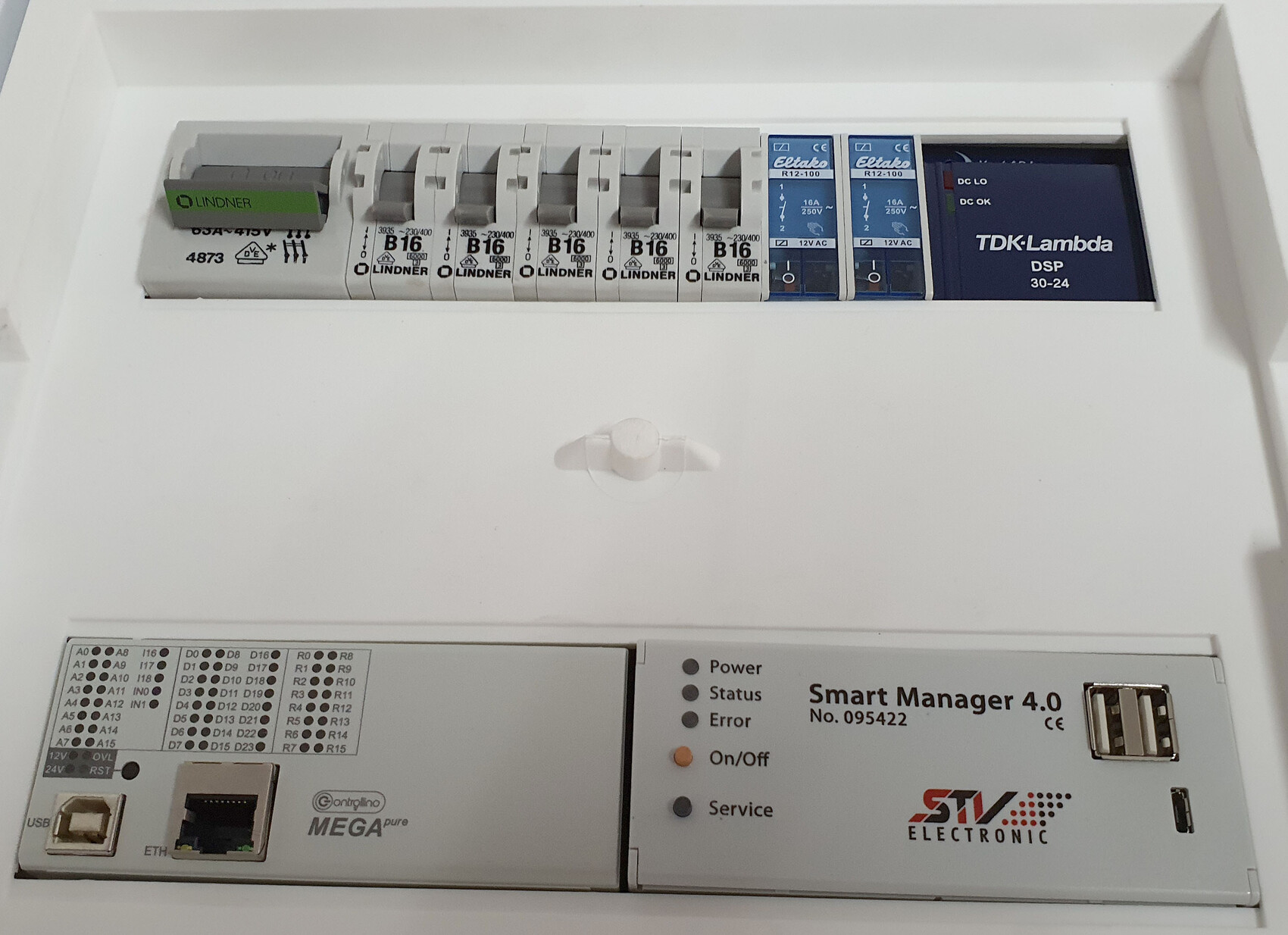

The result will soon be installed as a prototype in my living unit (a half of a semi-detached house = about 60m² (650 sq ft)). The photo of the small distribution board is just a small part of the test system currently being set up! The Eltako devices were only included for comparison (space requirements compared to the Controllino) and probably will not be part of the finished system.
Almost any device that supports a smart home protocol can then be integrated via a suitable “binding” into the system.
The main hardware (the brain of the system) will cost around 1000 to 1500 euros (approximate) and mainly consists of the SmartHome Manager (Raspberry Pi) and Controllino Mega pure (Arduino).
Programming OpenHub, etc. (open source) is handled by our software developers/programmers.
Temperature, distance sensors, motion detectors, humidity, CO2 sensors, and more can be easily integrated. Even small touchscreens (€20) cost only a few euros as “cornerstone components.”

The Eltakos were only installed for comparison purposes (space requirements compared to the Controllino) and will most likely not be used in the final system. A Controllino, very nice. It’s been a few years since I last held one... back then they were completely new. Can it handle enough load switching? Certainly great for lights, but probably not suitable for a stove or oven? superzapp schrieb:
The programming of OpenHub etc. (open source) is done by our software developers / programmers. I really like DIY systems. But it becomes difficult if you don’t fully understand everything yourself and have to rely on others or have others do it for you. Then something breaks, and for example, you cannot install the software on the new Controllino yourself.Similar topics
