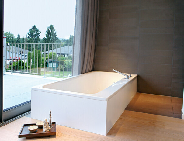

Therefore, when installing floor-to-ceiling windows in bathrooms of houses built in densely populated areas, it is important to think carefully. Even if you are walking around naked in the bathroom, your neighbor can see in. So, you will likely end up covering this floor-to-ceiling window with blinds or similar anyway 😉 😉.
If the window is planned to be so "public," then the same would apply to everything else… for me, that raises a basic question about what I’m doing there. Personally, I’ve already walked around naked in my bathroom—whether or not the bathtub is placed by the window. In that case, the neighbor would probably see more than if I were just lying in the tub.
So, I would generally consider some kind of privacy solution (for example, frosted glass for the lower part of the window or pull-up blinds) and then the bathtub wouldn’t be a no-go anymore.
By the way, this is the layout I suggested: the bathtub in front of the window, with the shower opening facing the window. You can’t see it in this photo, but that’s where the entrance to the shower is.
What I’ve also seen before is a long, wide strip window starting roughly at shoulder height, extending across the entire length of the bathtub. That also lets in a lot of light, and at most, the neighbor would only see heads.
