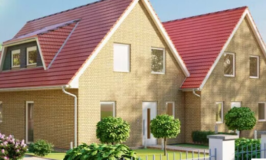

nordanney1 Jul 2025 17:34m0LN4rius schrieb:
We are building a semi-detached house directly on the boundary line. Our neighbor now wants to build with an offset of over 1–2 m (3–6 feet)Then each of you is basically building your own detached single-family house, as I understand it. So not:but you right on the boundary, then "nothing," and then the neighbor.
So the first question is: Is that even allowed, or is only a semi-detached house permitted on the plot? Check the definition of a semi-detached house in the land use ordinance. If the development plan requires it, then the issue is settled.
