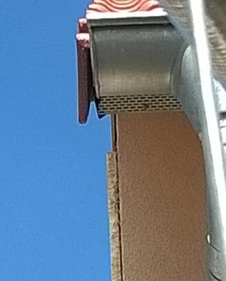

About six months ago, the neighboring plot was sold by the municipality.
The new neighbor is already busy with an extension.
The problem, however, will be that we installed a verge tile at the time.
It was unknown whether or when someone would be building next door.
At least my extension wall has a basic render (I believe silicate-based).
Braas Harzer Pfanne 7 (BIG)
The building was constructed 2cm (about 1 inch) away from the boundary.
My neighbor is building with 36cm (14 inches) aerated concrete blocks and has built directly on the boundary line.
A 2cm (about 1 inch) sound insulation layer made of mineral wool will be installed.
However, my verge tile and the wooden roof substructure currently project about 4-5cm (2-2 inches) over the boundary towards his property.
See picture.
Unfortunately, the perspective is not perfect – there is 2cm (about 1 inch) of insulation on the side of the wall to insulate the ring beam concrete at the time, so that the plaster inside (in winter without heating) could dry – this will soon be removed once the neighbor starts building.
According to the neighborhood law in Baden-Württemberg, the party responsible for the overhang must compensate the other party for any damage or costs – which in this case would mean I would have to pay for his changes to the masonry or structural work.
Therefore, I first have to shorten the parts on my side so that he pays for his extension on my property.
Shorten the wooden substructure by about 1-2cm (0.5-1 inch) – but completely trim the verge tile around the “fold.”
I want to wait until his upper floor slab is poured to have a precise template.
Aerial lift – probably too expensive?
Unscrew the gable tile and then I should be able to unscrew/remove all verge tiles as well?
Cut the tiles with a grinder.
If necessary, plane the wood by about 1-2cm (0.5-1 inch), or use a jigsaw if there is more room?
I might have to adjust the end of the gutter by 1-2cm (0.5-1 inch).
Aside from the grinder dust and the fact I’m only semi-comfortable with heights, this shouldn’t be such a big job, right?
Please share your opinions.
Thanks & regards,
Chris
